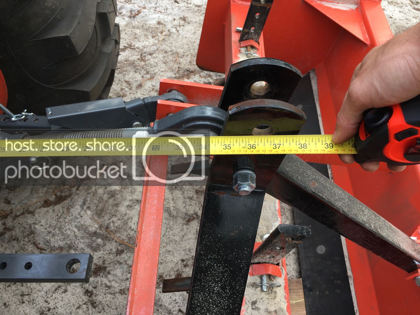

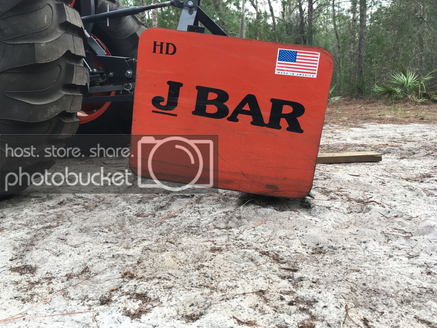

A normal 3 point should have all 3 hitch holes in the same plane. That blade has the top link hole behind the lower lift arm holes. You need a longer link between the rear of the blade and the uprights for the top link.
This is probably going to be what I have to do. I just hate having to modify a brand new product to make it work.

Did you ask the OEM if they have different links? It is possible an incorrect one was installed.
If not, then you are gonna be stuck making a new link.
Just seems an odd design to me
/ JBar HD Box Blade Problems
#24
I sent JBar many detailed pictures via email and never received a response. I had to call them a few times before I got through to some guy in fabrication. I told him my issue and he said I needed a longer top link.
