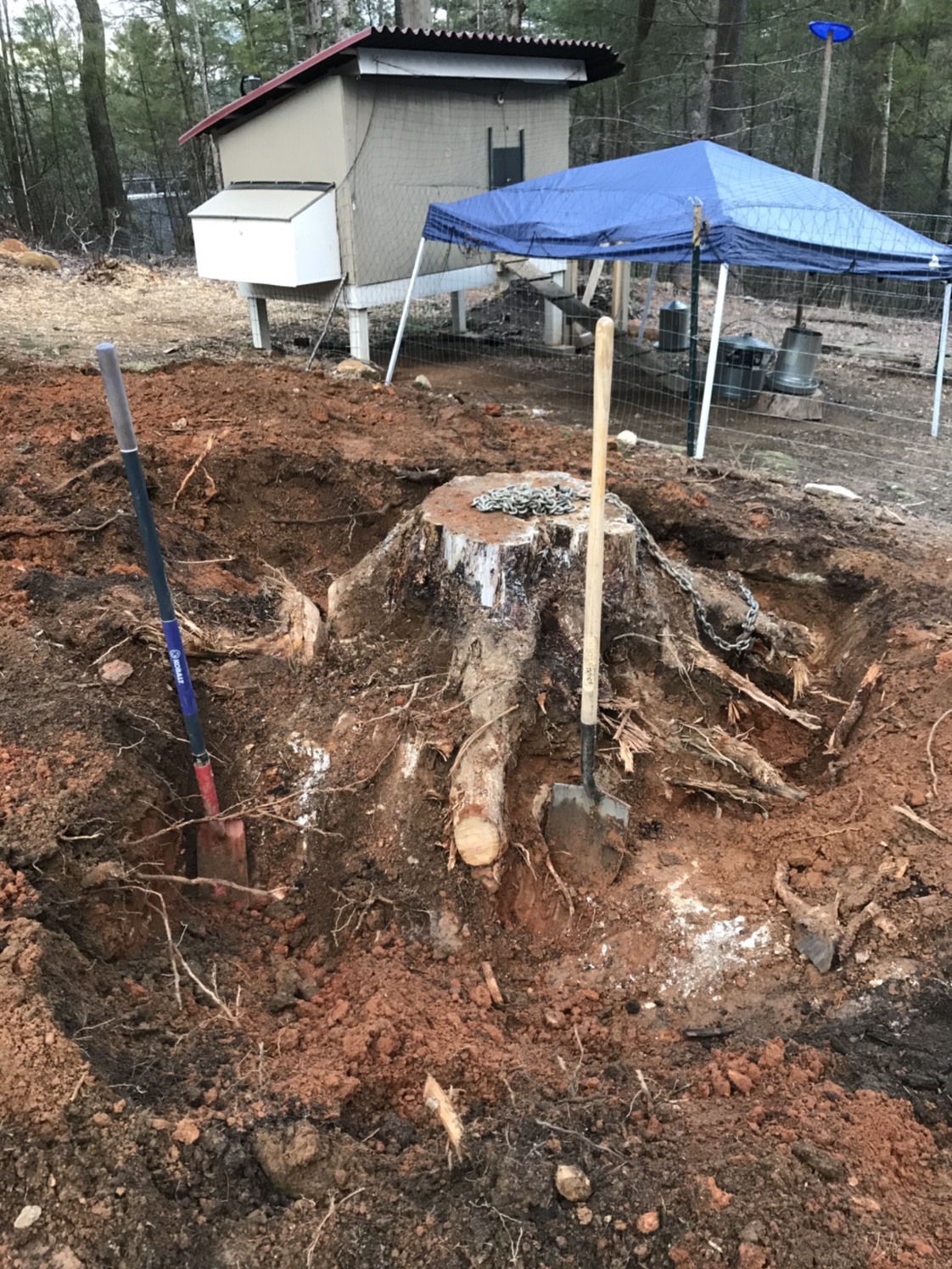

The current stump is a bit of a challenge. Granted it’s the largest so far, but I keep finding big roots and on a 2:1 hookup today it didn’t even wiggle.
This particular root is amazing. It is 3 roots growing together and wrapping around a rock in the process.
Hoping to get a video of this coming out of the ground soon!

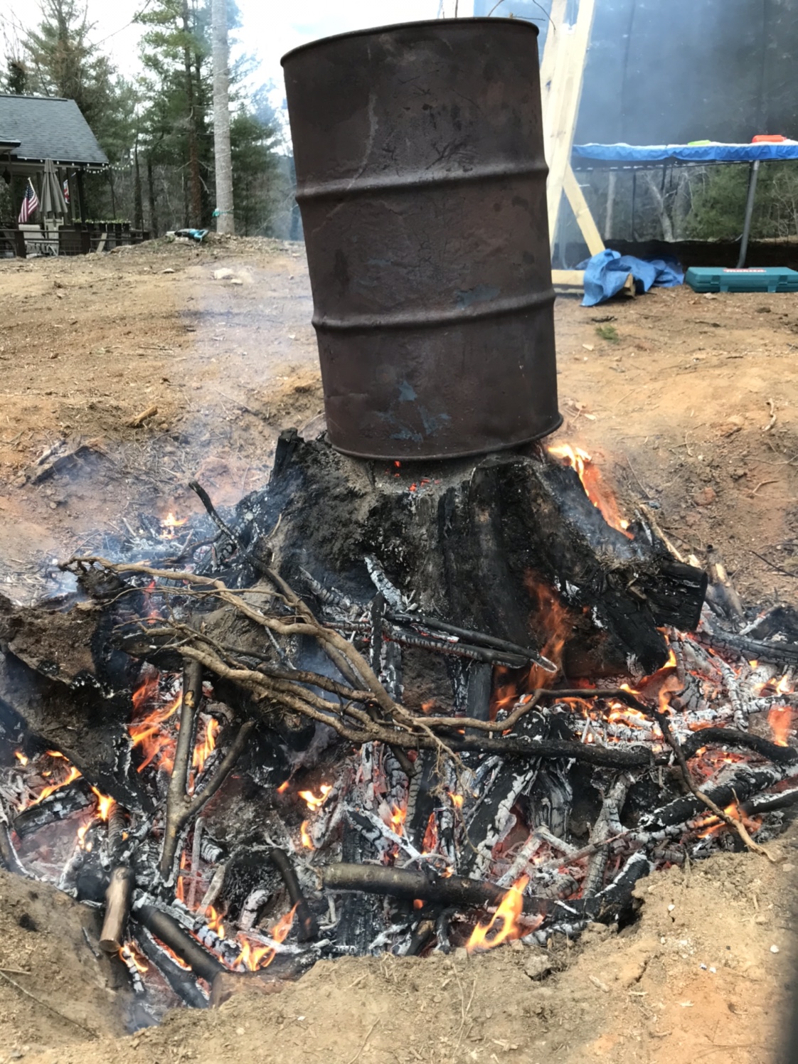

Decided to give burning a try after more digging, cutting and a 3:1 pull yielded not even a “wiggle” from what I now call “Devil Stump”. 🤬
While I do enjoy a and got most of the dead stuff laying around the edge of my property picked up and burned with the stump, and the end of a 2 day burn I’m left with 95% of what I started with. Apparently burning a stump is not a quick or efficient process.
So, I’m probably going to go back to digging, or seriously looking to get my hands on something explosive in nature.

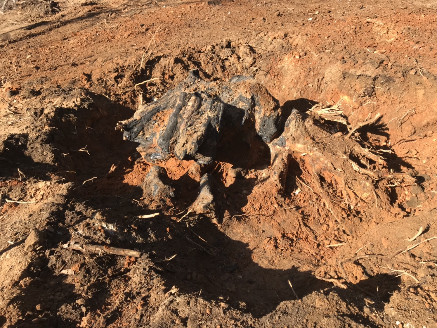

More digging. As I thought... this stump is growing around two very large rocks. Iced exposed a lot more Rick and found 2 more roots to cut. After that, a 3:1 pull for good measure. Out came the stump, still clinging to a rock I’m estimating at around 400lbs. We now have to get the rock out of the stump just to move this thing. I’ll be drilling in with a hammer drill and cracking it into multiple pieces.
My 2 helpers...
The hole it left behind
I’ll link a video shortly.

Yeah the plan was to drill enough holes to weaken it for a few good licks with the sledgehammer but this idea failed. I decided to use the backhoe to scrape at the roots and the edge of the rock and in about 10 minutes it fell free. Not the 400lbs I first though but still large enough.
And here is the other one. It fell out while pulling the stump out of the hole.
Between the 2, I estimate it was adding a good 500-600 lbs of resistance, likely more when you add in the dirt on top of them.
