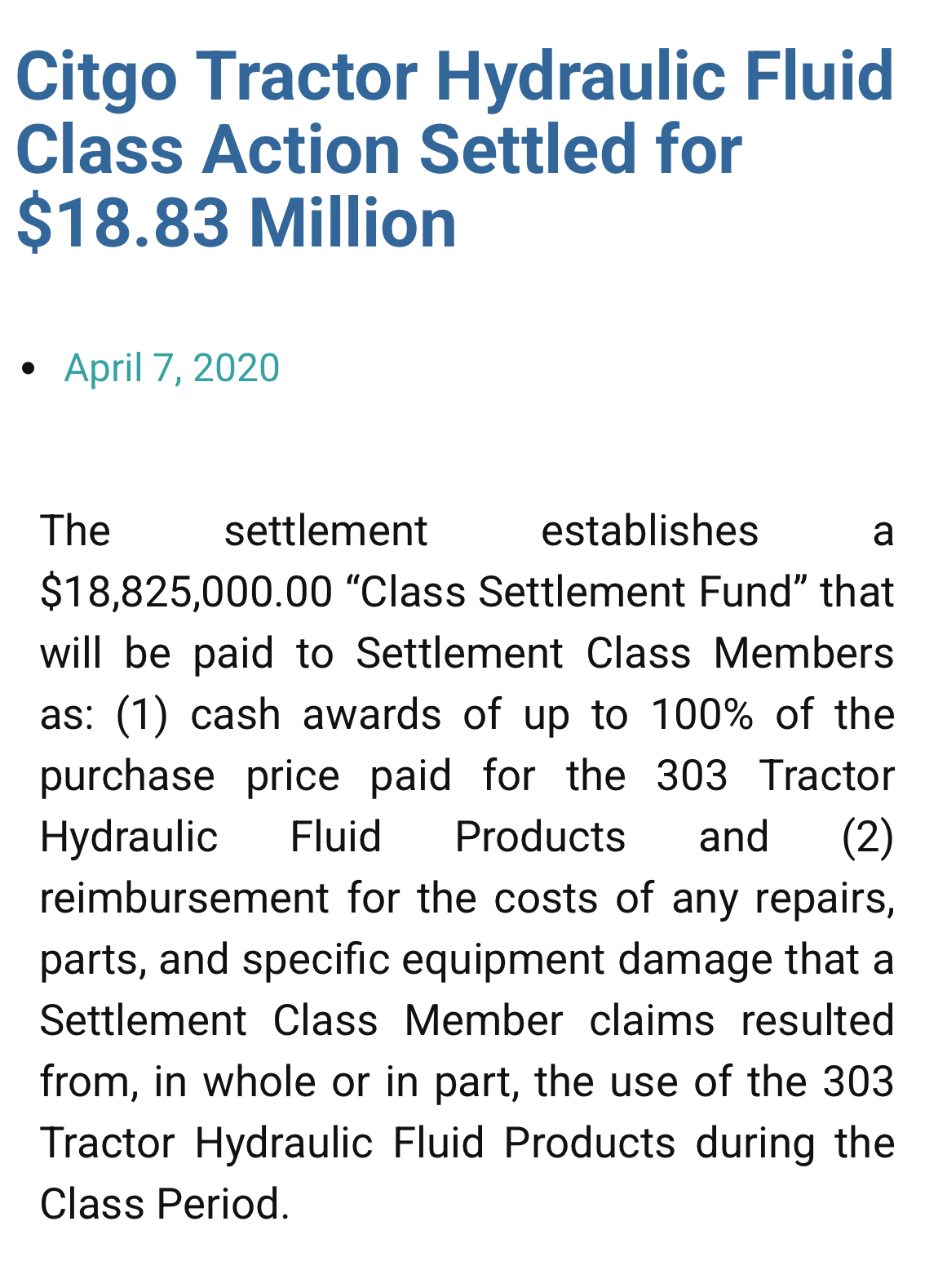

“Walmart and highline Warren lost a 10M class action suit over this same oil label where they advertised it as 303 ingredient (sperm whale oil)”
I think you got your stories mixed up.
First off , nobody lost a lawsuit for labeling it 303 oil. The oils were correctly labeled 303 , but incorrectly stated they were suitable for higher demand applications.
If you run any modern expensive machine you care about, you would know, you never , ever, use low grade 303 oil.
Secondly, it wasn’t specifically a Warren problem , It was mostly Citgo who made the product, and it was sold under various labels, including Supertech 303.
Don’t use 303 oil in a modern machine, no matter who makes it
