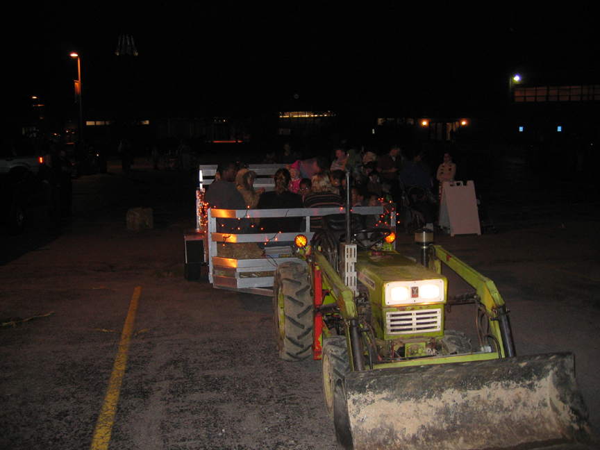

Congratulations Dennis!
I wish you many happy hears of tractoring. I had a lot of fun pulling the kids last night on a hay ride with my 155.
Craig

Good to hear. You are going to love that little, powerful tractor. I loved mine.
Craig
Well, didnt get mine going in time to do that, but there is always next year. ;)
Am looking forward to using it this winter to help dig us out of the snow. My neighbor got the one driveway dug out but wasnt able to dig out the garage and my shop so we had to do it by the shovel full. Having this will make it alot easier. :)
Liked you photo of the hayride. Looked like some happy folks.
