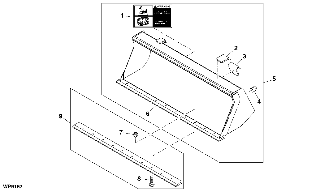

Cutting edge is whats welded across the front of the bucket. Since you have the HD bucket, it's drilled for a bolt on cutting edge, basicly two, one bolted to other. Double up and let the bolted on one take all the wear. It will use plow bolts from the bottom so it will be smotth on the bottom. If you grade with the bucket tilted too much it can be damaged if it catches something. Bucket cylinders could be damaged too.

You will probably find jdparts useful as well.

I agree with getting the replaceable edge on the bucket while it is still in new condition.

I might check into the new cutting edge , mine is like new , so I would hate to mess it up . I am going to use the angle blader more than anything . I was just wanting to play on it .

Goochy,
If you think about it having the replaceable blade bolted to the existing one in effect doubles the strength of the lower edge. This helps the bucket retain its flat or straight edge.
