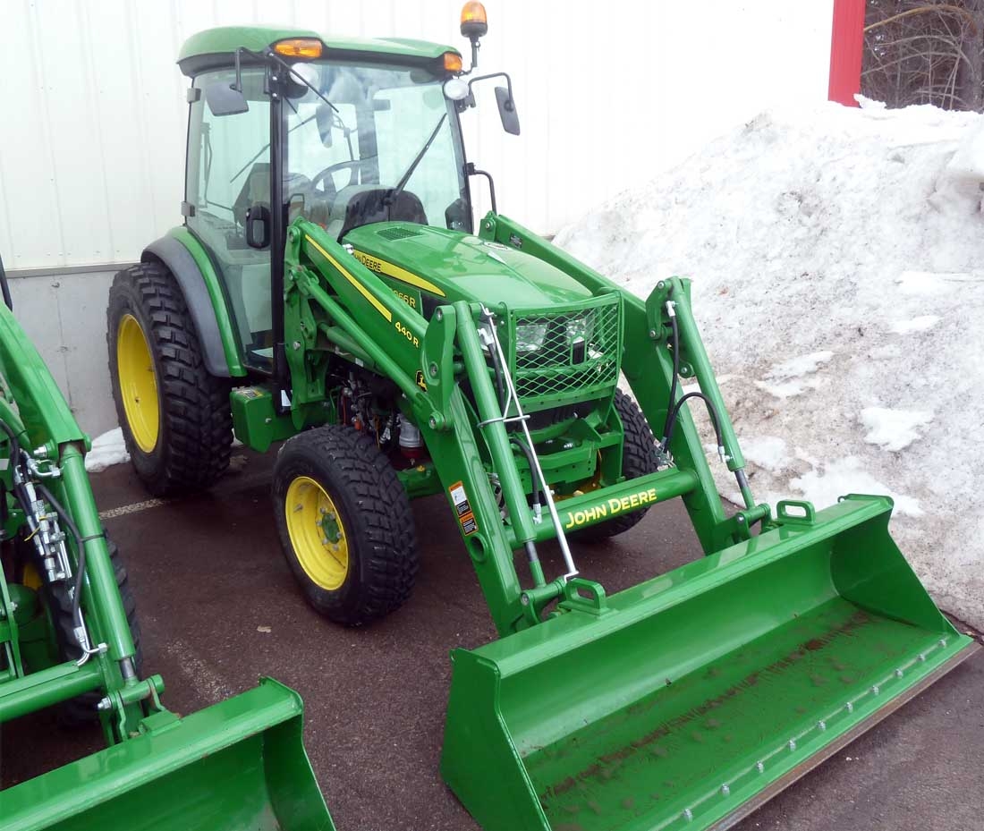

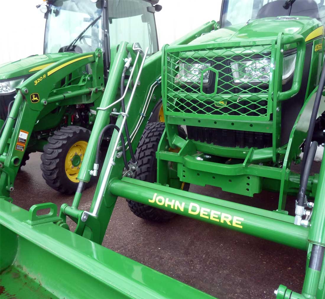

A couple of points. A lot of attachments can be had with the JD quick attach setup for the FEL. It sounds like you are going to get a grapple and the bucket, you should be fine with the JD setup.
The quick hitch on the back will hook up to most newer implements. I’m not sure why the dealer said that. There is a standard spacing that is required for the quick hitch and most newer implements will work. Sometimes the top hook up won’t quite work but someone makes and extender type setup for it.
Better to get the SSQA attachment from JD if you can. Then you can buy any used attachment you want instead of being limited to just JD which is a Much smaller pool to pick from.
/ 4066r demo
#82
We are staying with JD attachment system. I have used SSQA quite a bit at my old job and did have buckets fall off while back blading. Nonetheless, with just a bucket an grapple being used, why spend the $$ for a SSQA front plate? Nearly all attachment manufacturers offer the JD mounts anyway AND they might stay on better. :)

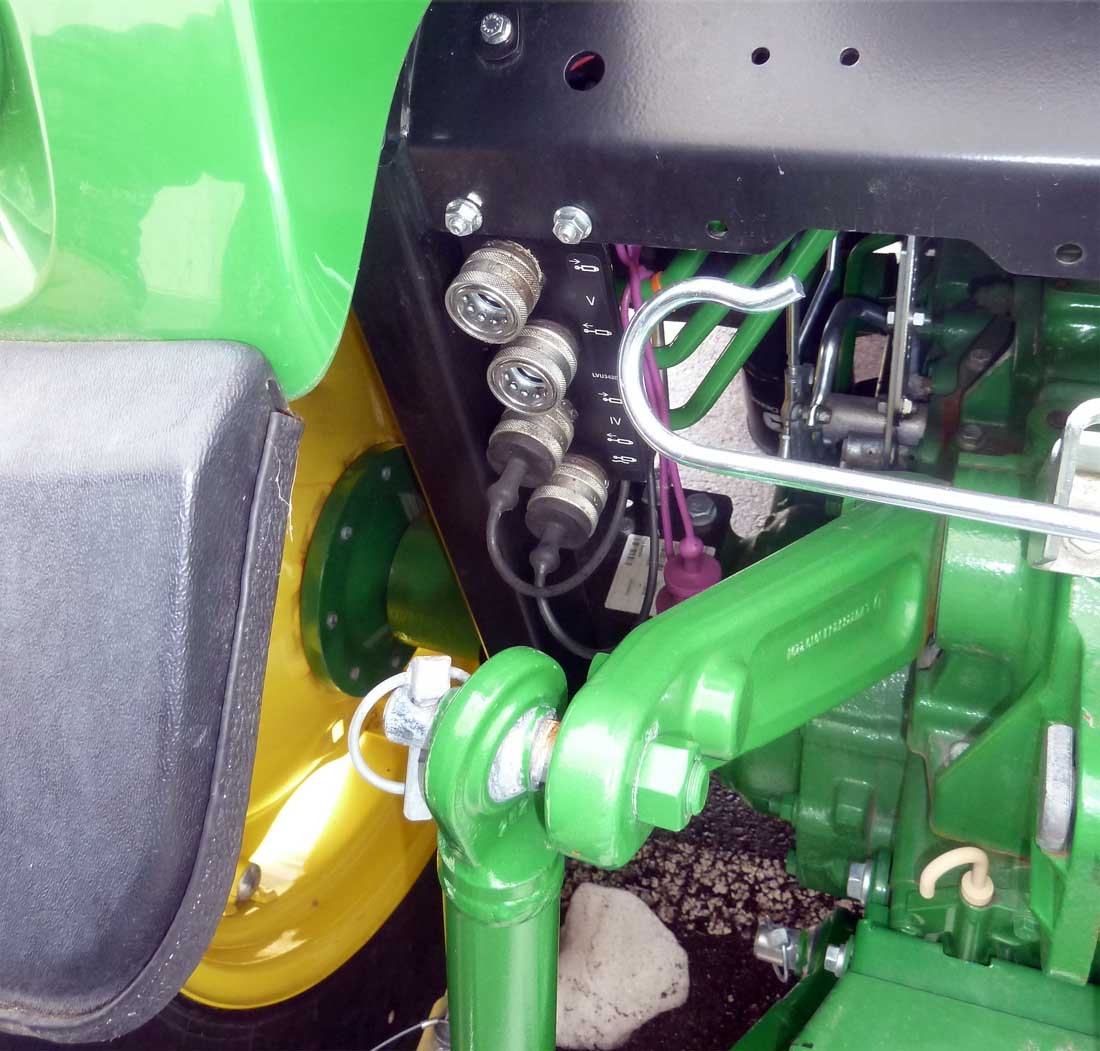

Also comes with this 3-point quick hitch. The dealer said "they won't attach to many implements". I appreciate his honesty. Bucket looks unused!View attachment 5495944View attachment 5495942
With the adjustable top hook like that, and having the proper bushings, I use my quick hitch no problem on implements that are "not quick hitch compatible"

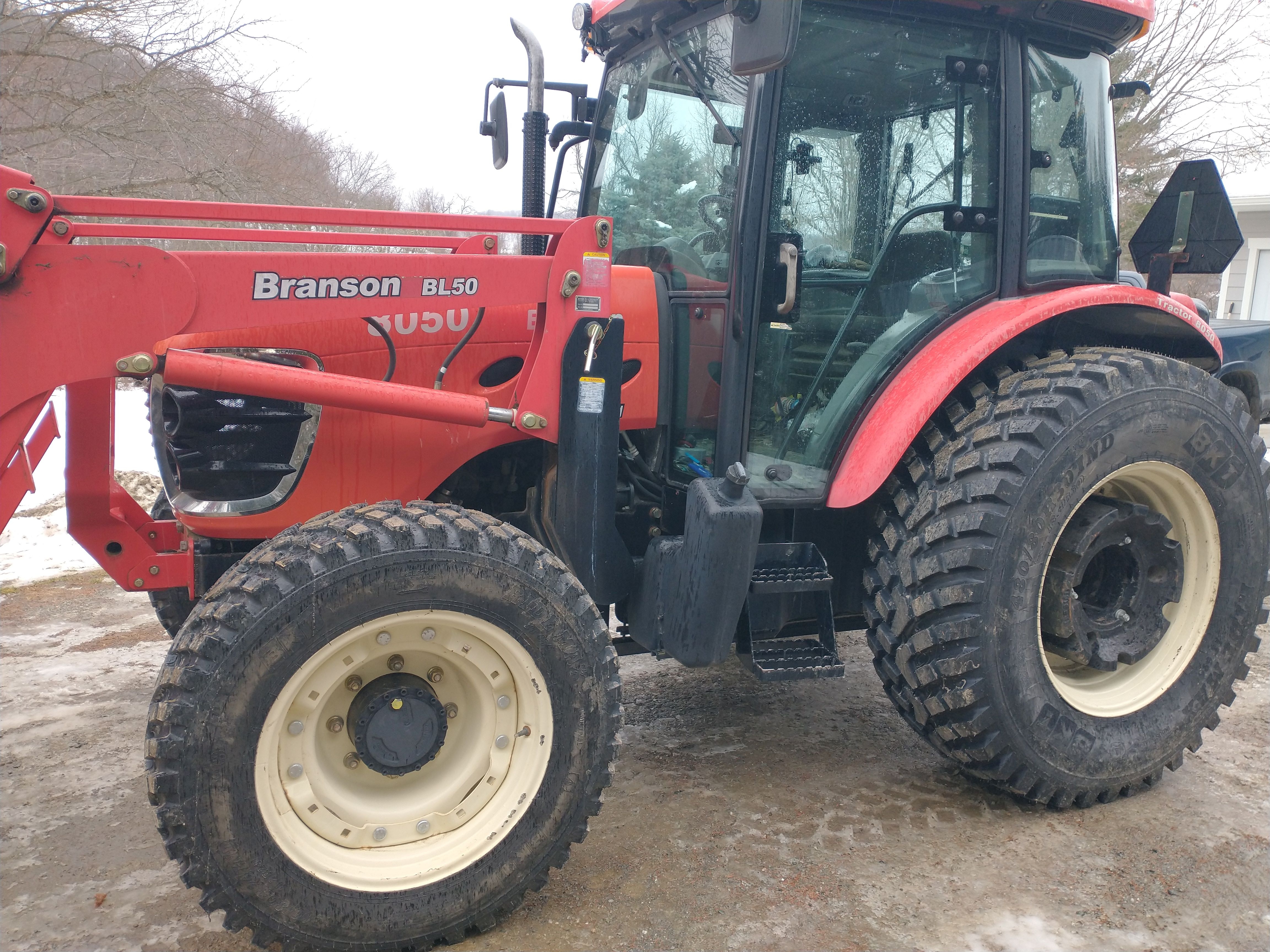

Northland JD who I just got back from has dealerships here in the UP, northern WI and two in northern MN. I would call them a larger dealership. They have another 4066r demo at another location with those the r-4 tires which would be better for us working in off road conditions. Lots better than the Nokia snow tires! Its got a few more hours and a bit lower in price. The machines we are looking at are HST but JD does offer power shift as well.
/ 4066r demo #97
Those Nokian tires will have more grip in mud then the R4's by far.
In my opinion R4's are worthless on anything but pavement or hard gravel.
/ 4066r demo
#98
I just left the dealership and the tractor on my right has r4's while the 4066 on my left the Nokia R14's. The 14 had much tighter tread pattern and filled with rubber like turf's, than the R4's do. Have you used them both? Seen them side by side? The r4's and not a ag tread but far closer than the Nokia's snows are.
/ 4066r demo #99
Yes I have used R4's and they are an accident waiting to happen on hills with just wet grass they are not worth much in mud either.
No I have not run the Nokians, but I have and am running a BKT with the similar tread pattern and am pleased with there traction and performance.
