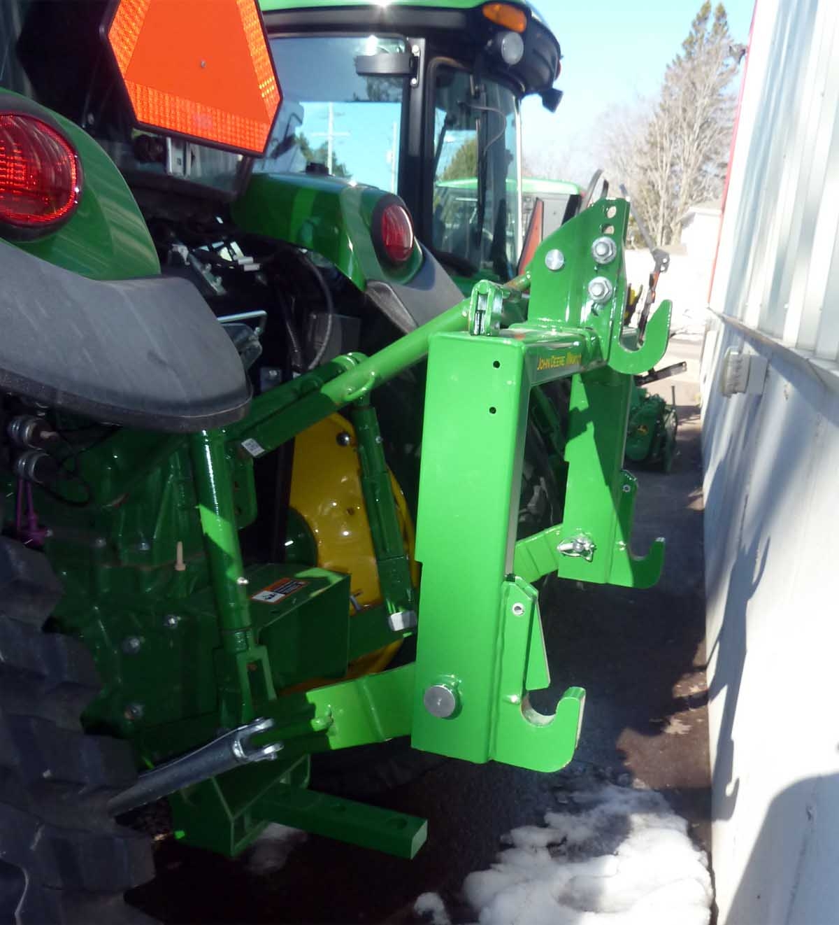

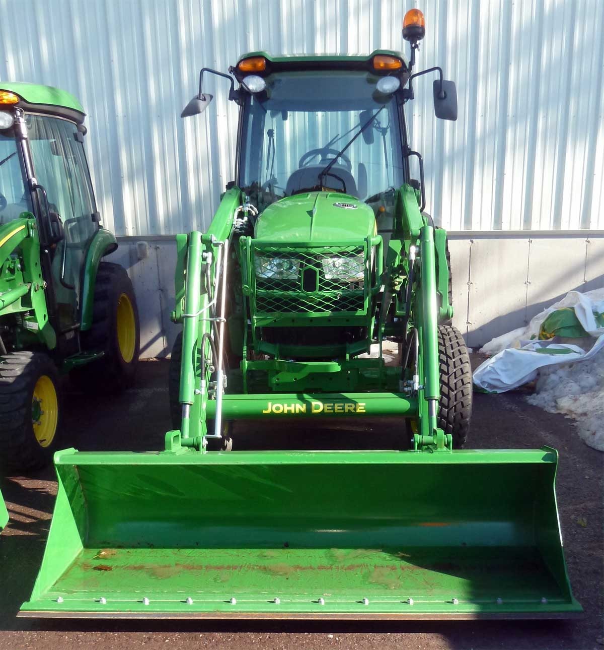

I was at our locale dealership today. Its a 2022 demo with 20 some hours and discounted. Still going around about accessories to get with it like root grapple and backhoe.. View attachment 5495813View attachment 5495818View attachment 5495822View attachment 5495839

60K is the approximate price and that's what I don't like,,, but that's close to what they are going for on tractor-house and other places. I might try get a full warranty from them. I do like the quick 3 point hitch it comes with that's built on. 2 rear hrydo circuits and one on the front for grapples, plus its front brush guard that looks tough. This is all I can think of at this point.
Your picture doesn't show a front hydro circuit. All I see is the hoses for the bucket dump. My Kubota dealer wanted 3K to put one on, so I did it myself.

Awesome tractor. I bought almost the identical one two years ago. A 2021 4052R with 112 hours.
Quick thing I see from the picture, it looks like it does not have the hitch assist knob on the back to raise/lower the 3pt from outside the cab. Maybe I just missed it in the pics. Mine also doesn't have it and the parts to add it are around $700. The reason I got from the dealers is in the transition from manual to electric height adjust there were a few months of tractors with neither. See if the dealer can get this installed as part of the purchase deal.
As far as SSQA vs JDQA goes, these were available from the JD factory with either, the SSQA was an optional upgrade. I bought the HLA brand JDQA to SSQA adaptor and it works well. The HLA version does have optional hydraulic coupling for only around $700. Thius would have been a very nice option. You can also get a pin on SSQA from HAL with hydraulic coupler, so if the included bucket is the only thing JDQA you own maybe get it swapped at time of purchase. and sell that bucket and get a ssqa one.
Does have the hitch assist controls on rear fender.
