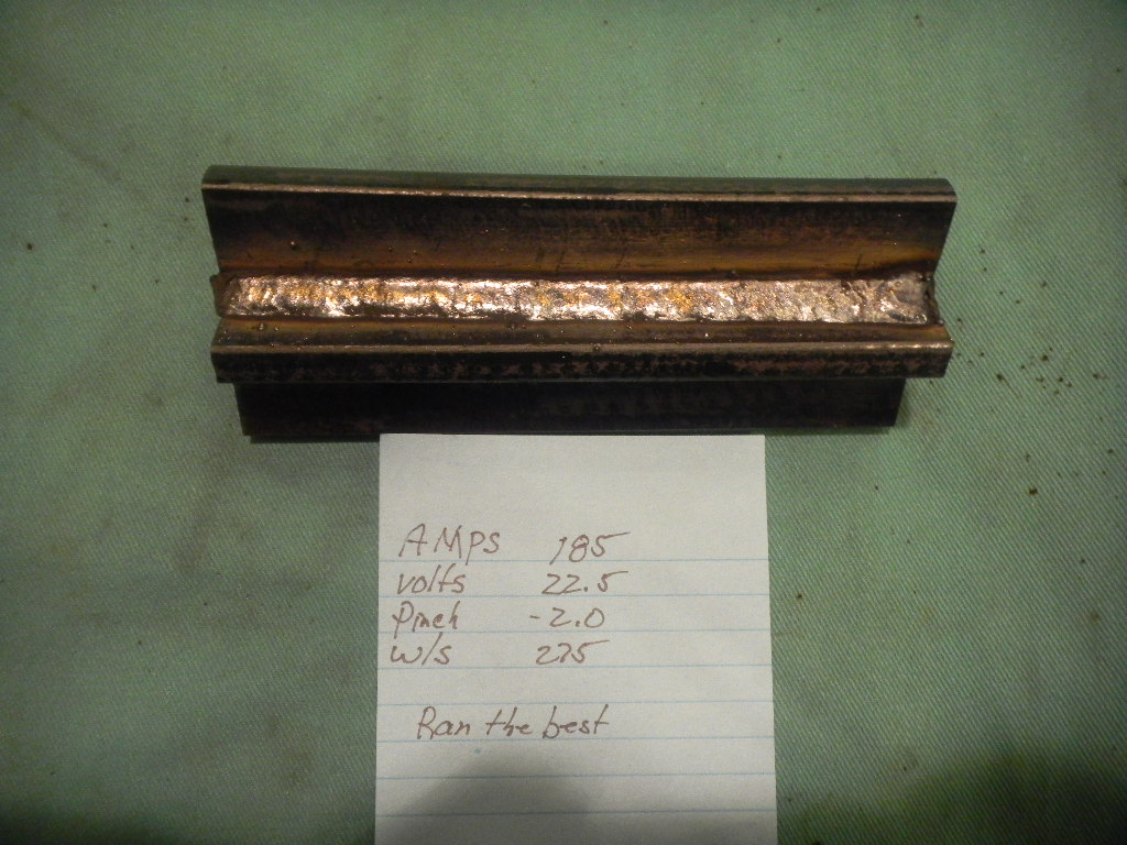

Oh yeah it leaves a real heavy slag! But I always thought dual shield was very fast. I'd have to go and compare the deposit rates between spray, and dual shield, I'm sure spray will have a higher rate. But where I was going with the side by side comparison is all the extra prep work that spray requires. As we all know, there is more to welding that just pulling the trigger!;)
Here is a picture of the slag, and a chipped weld.

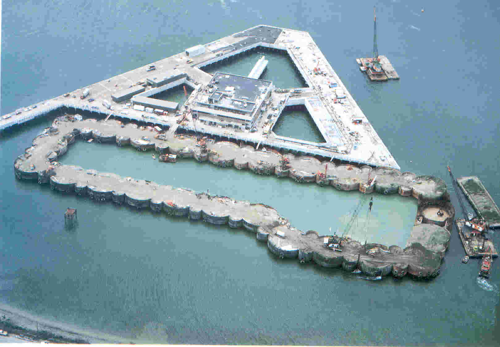

I was the project superintendent on this outfall project. We had a crew of welders welding these 10-feet diameter 1-inch wall pipe with dual shield. 100% X-ray. Had to have the welders in a tent because of the gas coverage.
