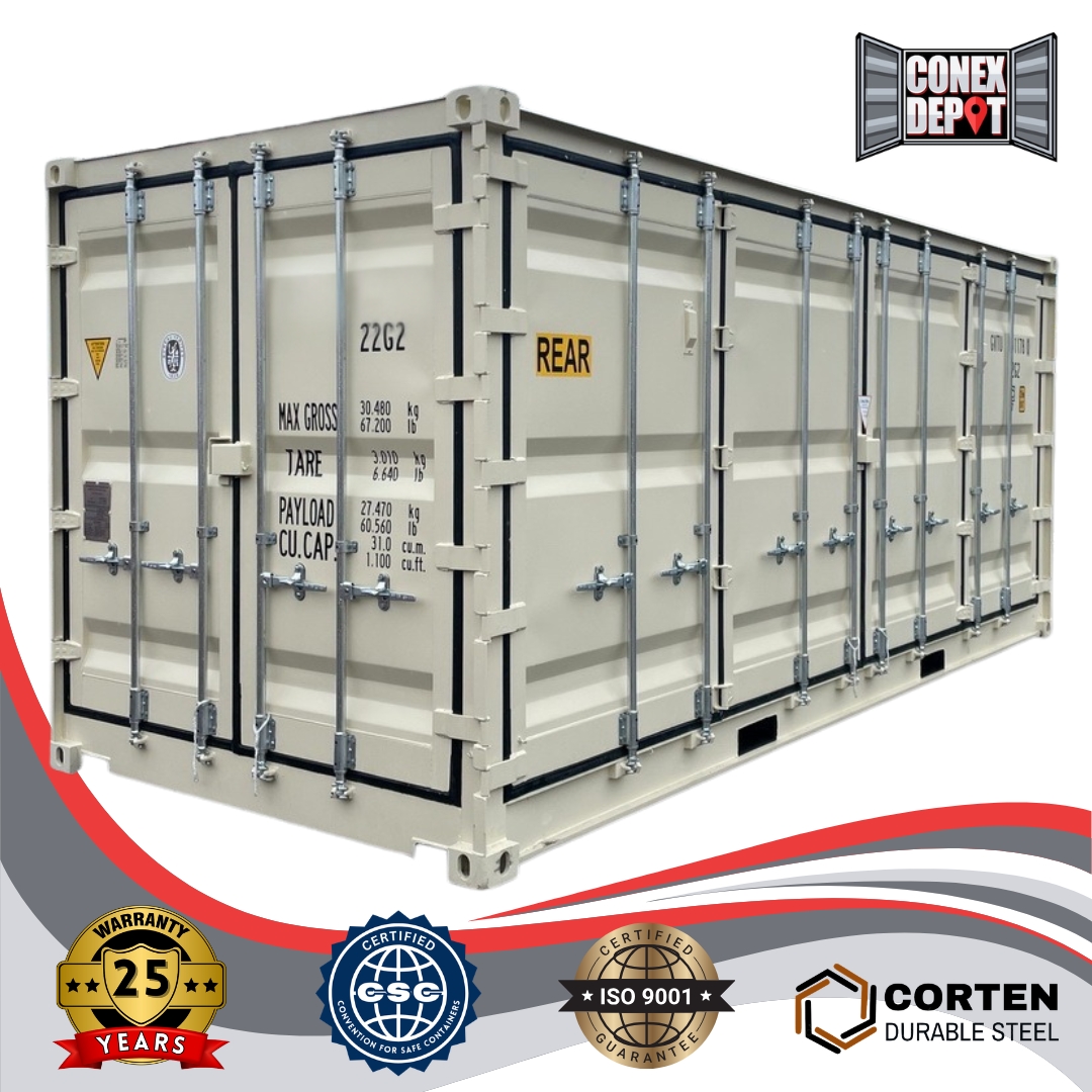

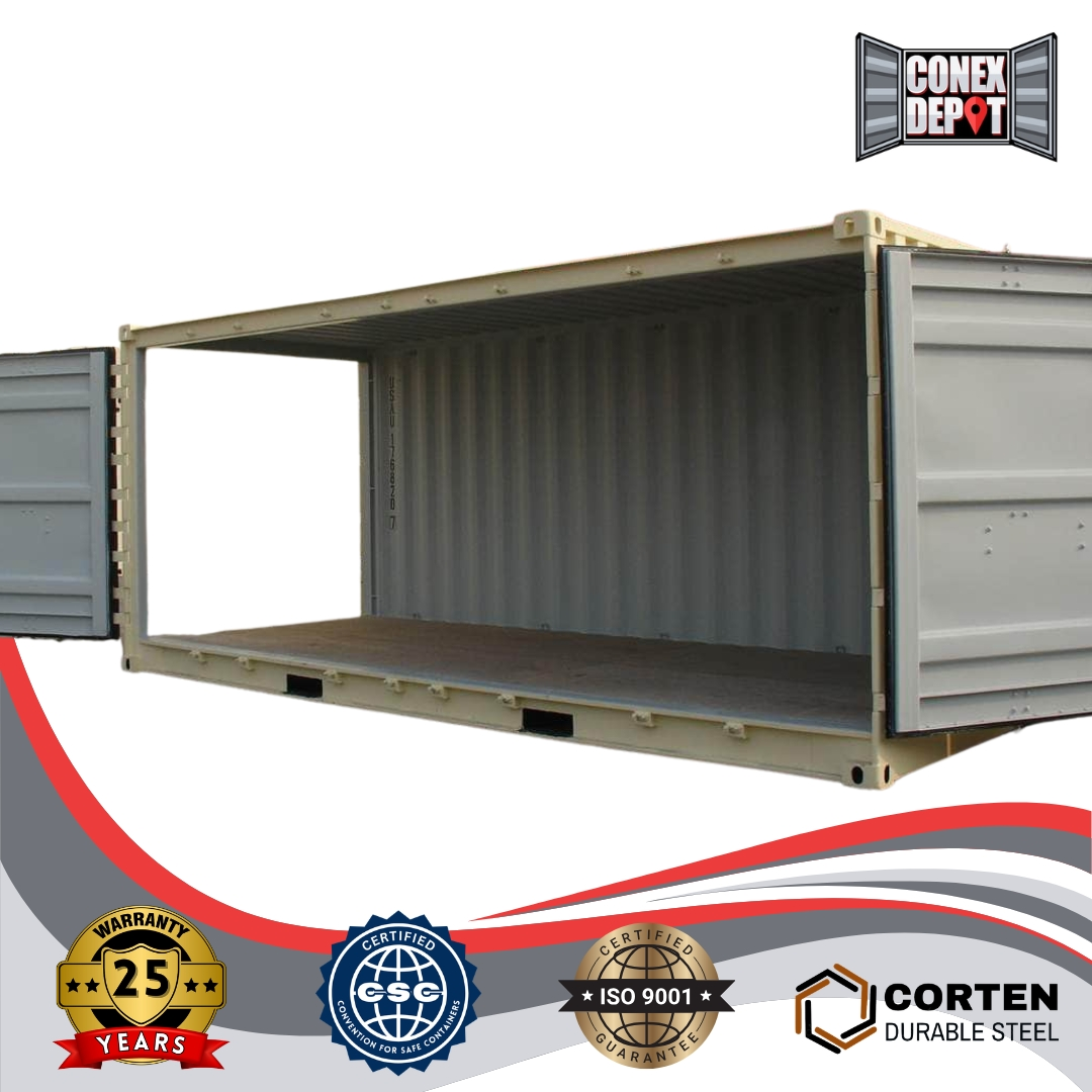

You can buy a container with the end and at least one side door.. More expensive, but would allow you to drive in and get out. You can even accees the car from the side:

@Midniteoyl Interesting. I will take a look. Twenty feet is what I'd be looking for.
