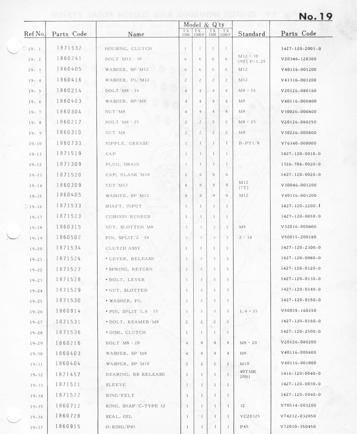

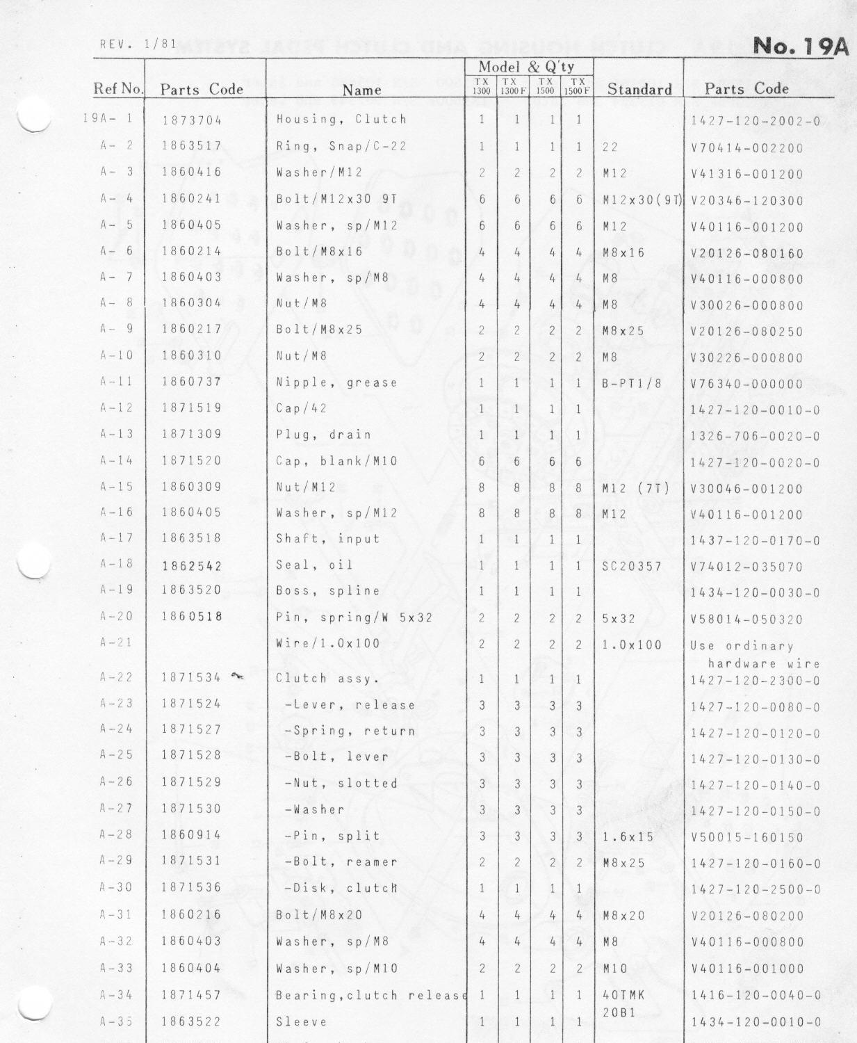

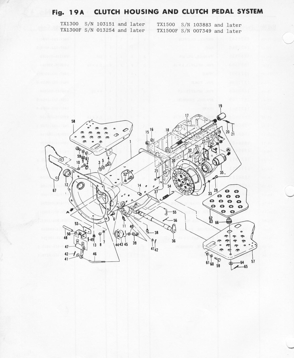

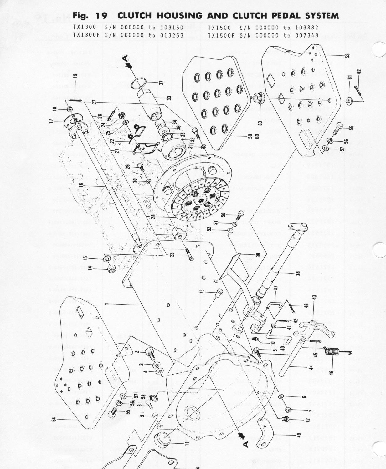

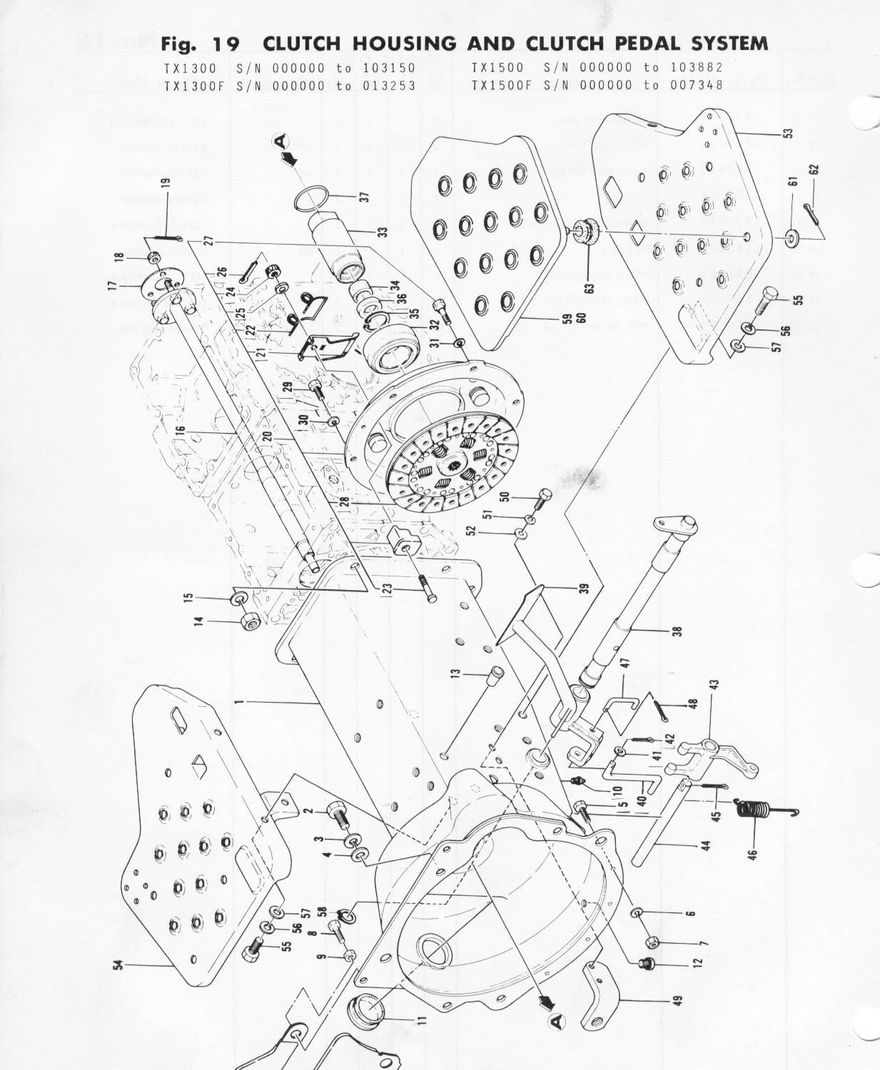

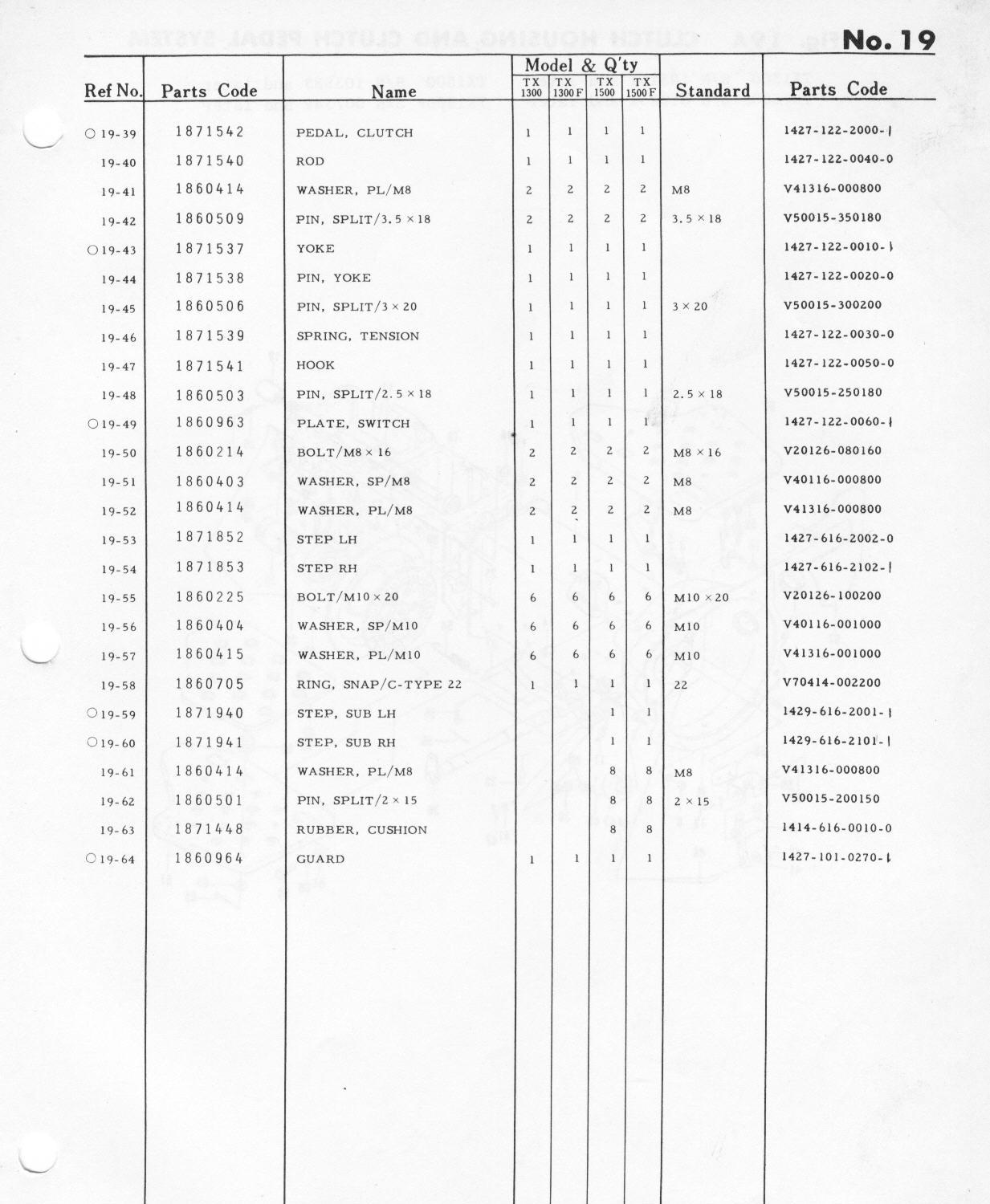

Hi Ballaterach,
Here's copies of the Parts manual as requested (this is for a TX1500F ):-

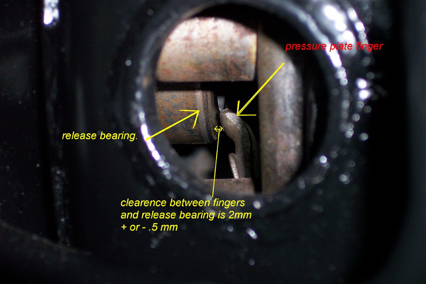

Okay have removed the 'inspection hole cover' when the clutch pedal is fully depressed a very small gap appears can't be accurate but would guess half a millimetre max - does this change anyone's opinions as to what the problem might be?

   / Iseki TX1510 Sticking Clutch #18
See if you can rotate the clutch all the way around one revelotion and check the gap at all the shoes. I think a 1 mm gap is about all you'll have but I'm not sure of the exact dimension off the top of my head.
If it were me I'd get it apart and look at everything before deciding what to buy. Sometimes the release fingers on the clutch cover are worn because the throwout bearing has failed and you need to replace the assembly (or just the fingers if you can find them separately). In the two tractors I've had apart the fingers were fine so there wasn't a need to replace that part. Had I not broke the clutch disk the only thing I would have had to buy was a new throwout bearing and the one I had still worked but it did not roll freely. Generally most people try to keep repair costs minimized but it wouldn't hurt to replace all those things I just wouldn't unless I needed to. All those parts new will add up to some significant costs relative the to the market value of the tractor especially when labor is added in although the labor cost won't change much on how many new parts you put back in. I'd make sure whoever does the work puts a small amount of grease on the shaft and clutch spline when it goes back together to help prevent the problem I ran into.

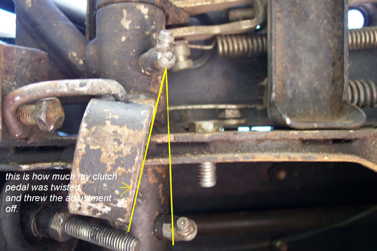

   / Iseki TX1510 Sticking Clutch #19
here is a picture of how the clutch pedal was twisted on my tractor.

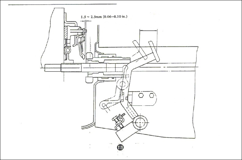

   / Iseki TX1510 Sticking Clutch #20
here are a few pictures, Check them to see what fingers should look
like when they are not worn. Also shows were there should
be a gap between fingers and release bearing.
