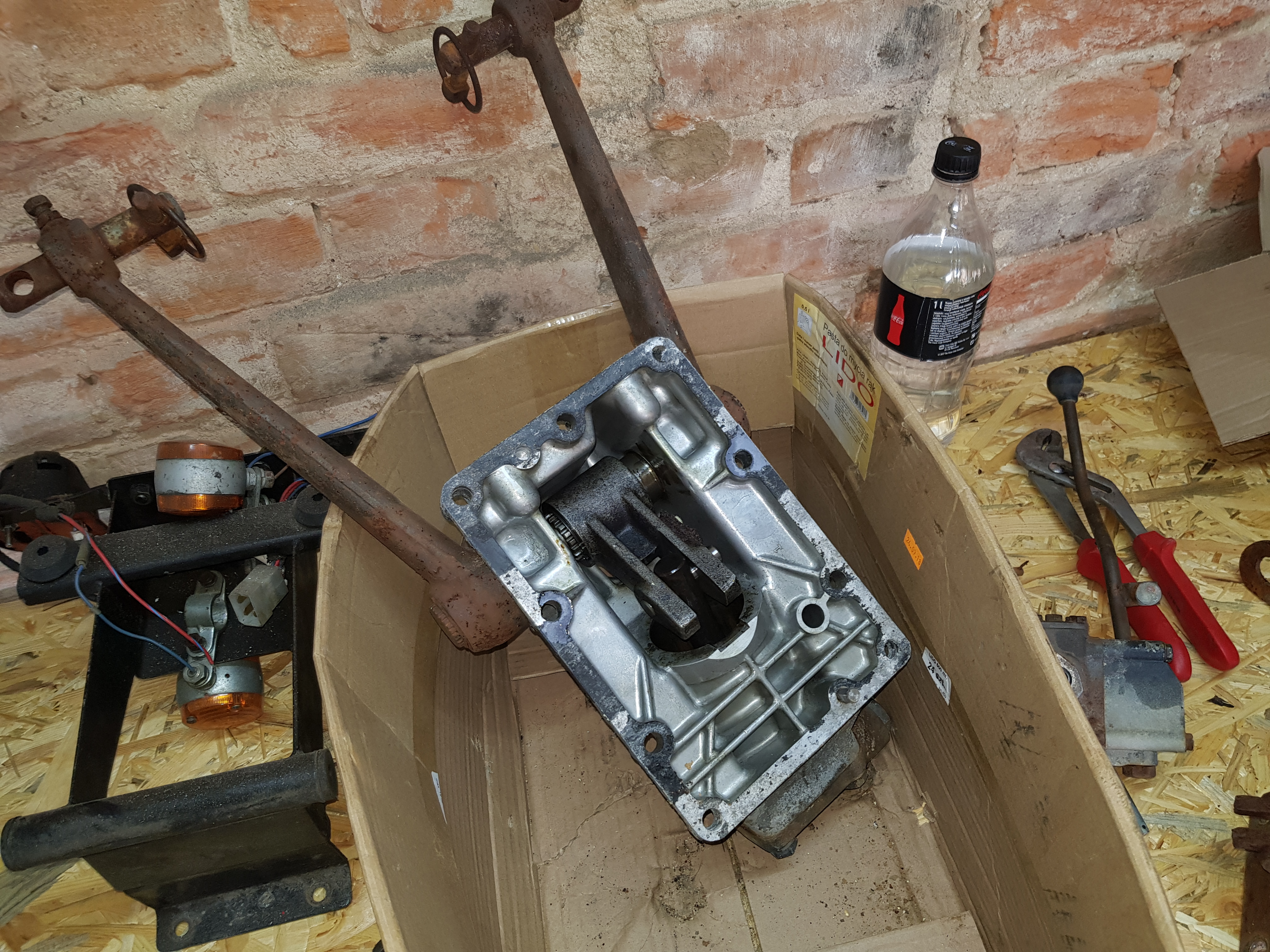

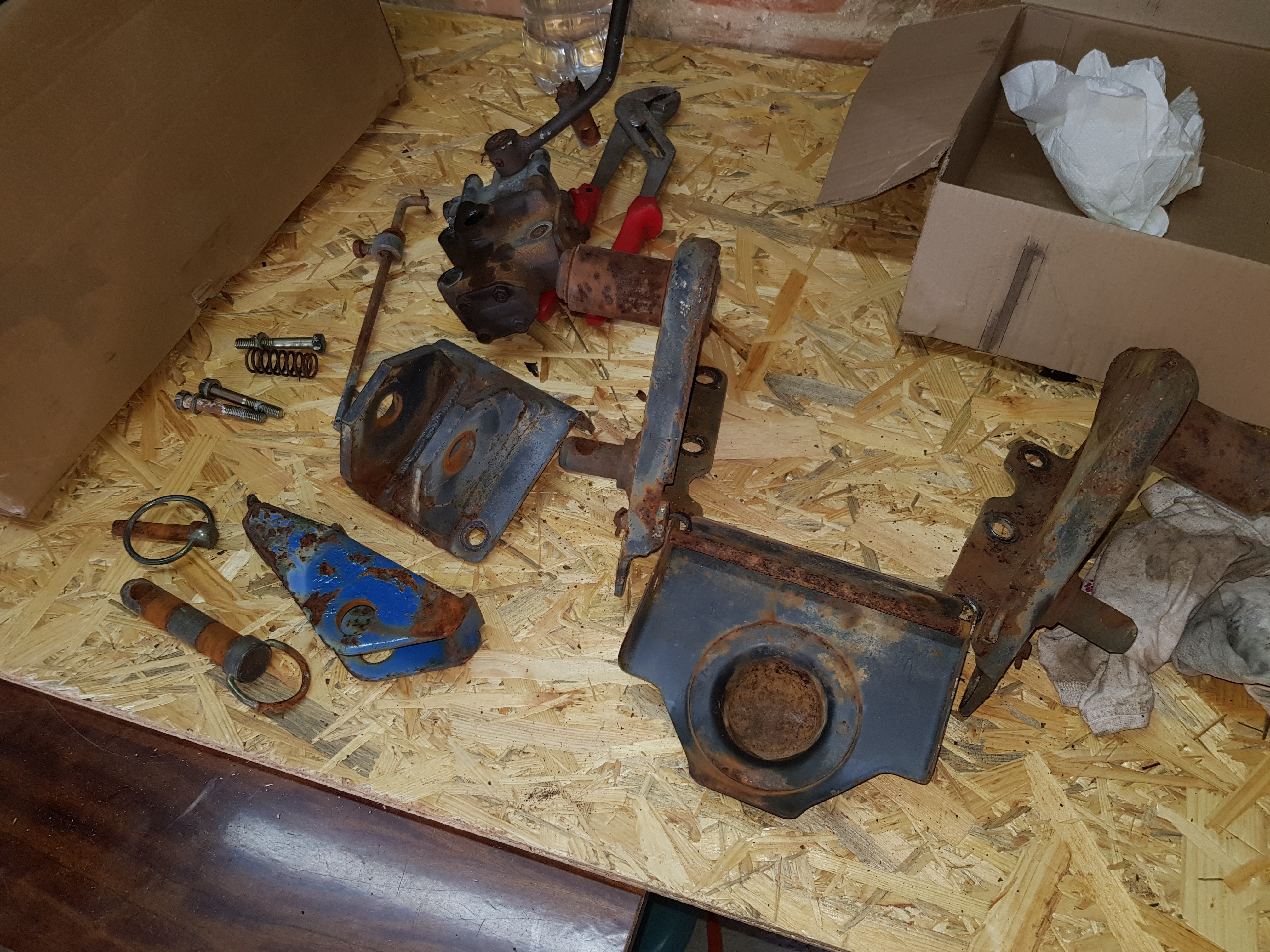

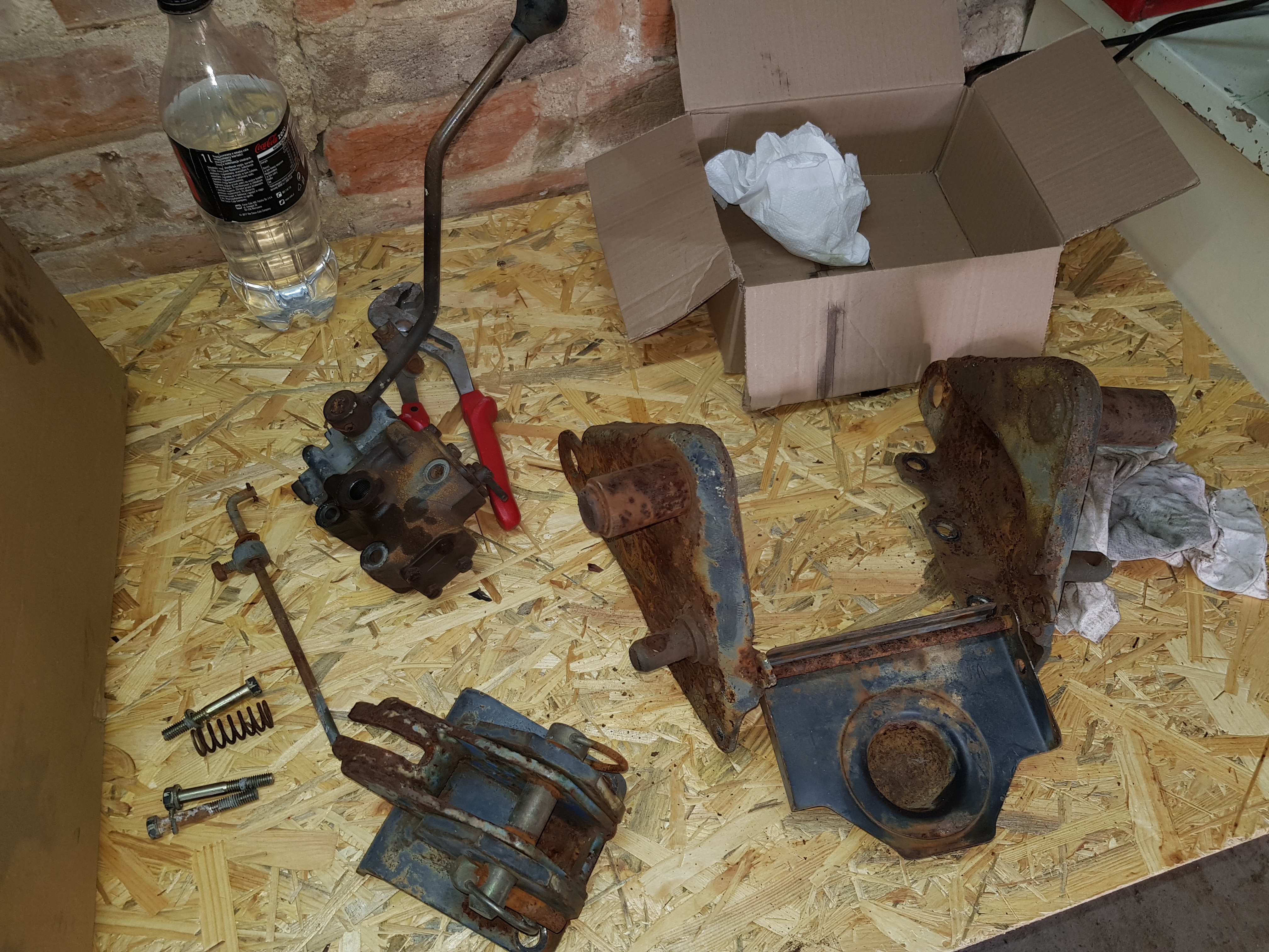

Ok small update on this project: i picked up that parts that i need to get this working. The external state of these parts is not really good, but i guess i can work on this.
photos:
I have to thank the people that have sent me manuals on the iseki, without these i would not get those separate parts complete, it was nice to be able to tell these people exactly what i needed.

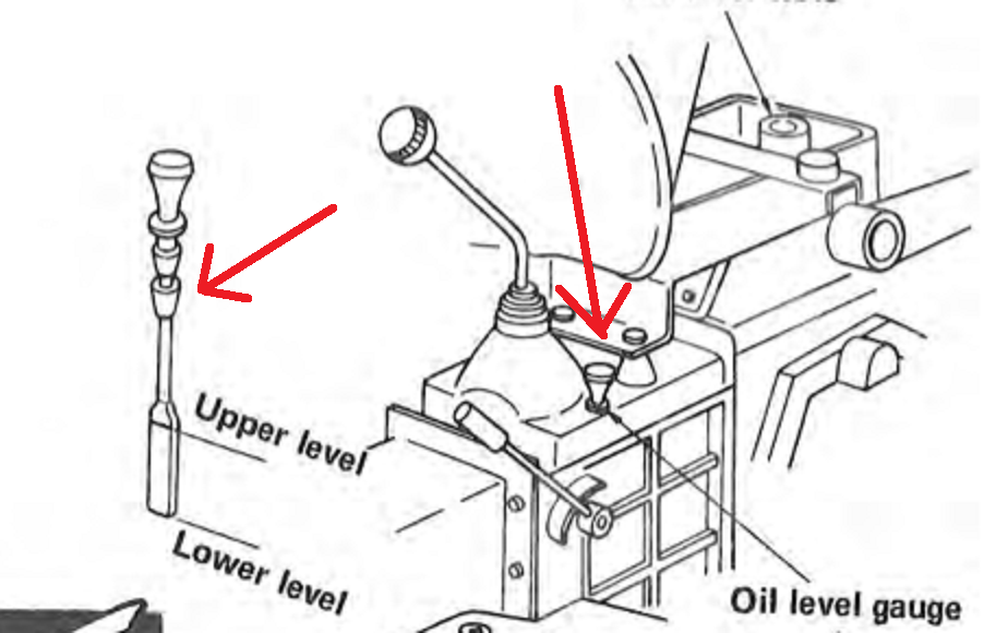

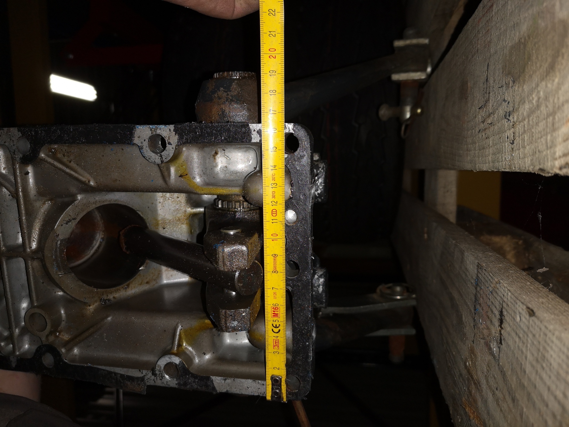

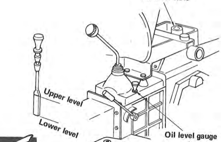

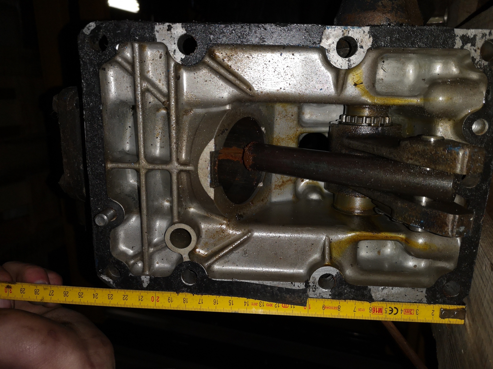

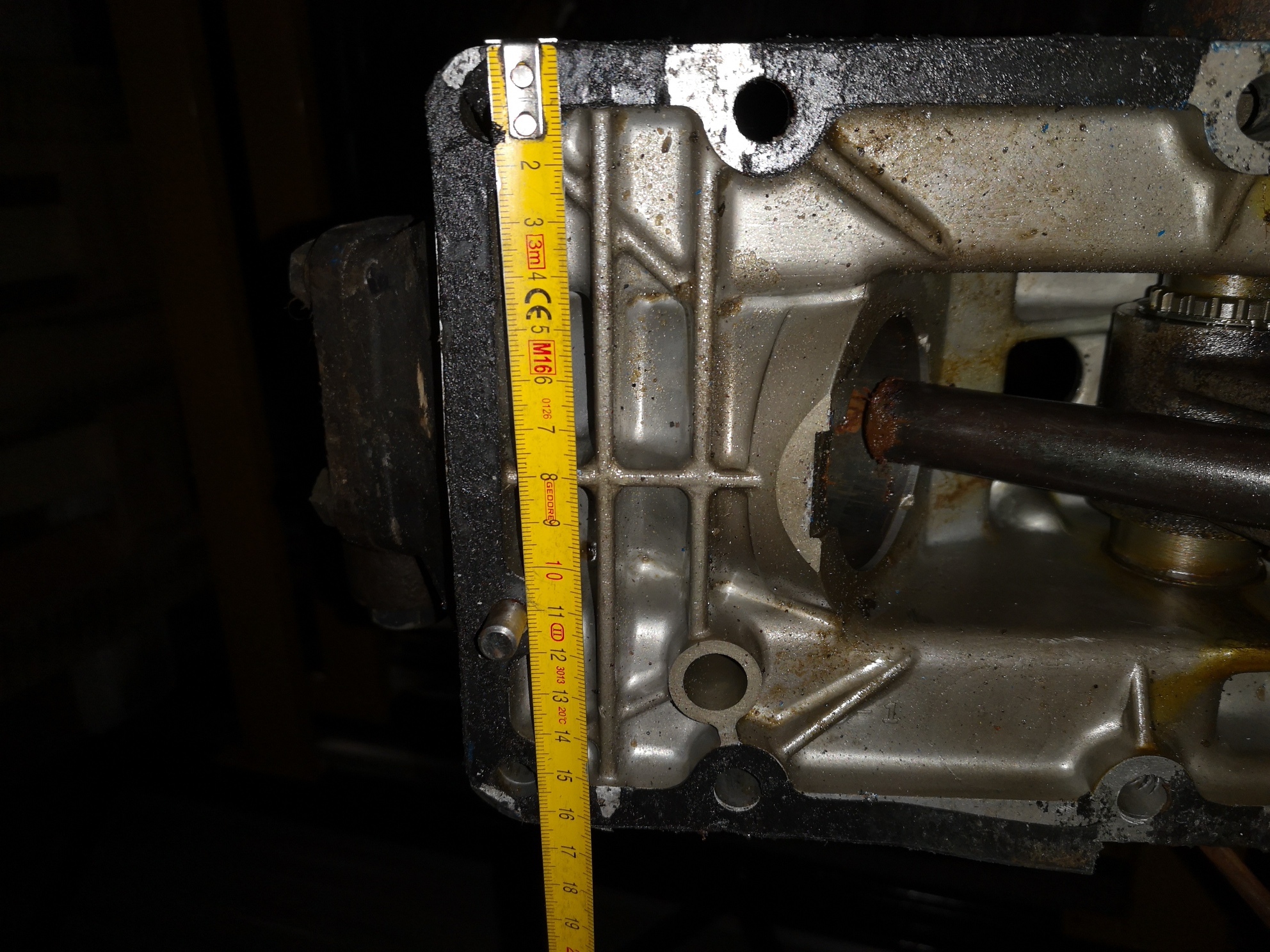

Other question: Looking at those manuals i saw that i am missing the gearbox oil level gauge. Can anybody here (owning tx1300/1500) check and send me exact dimensions of this part? foto's explaining this thing:
and

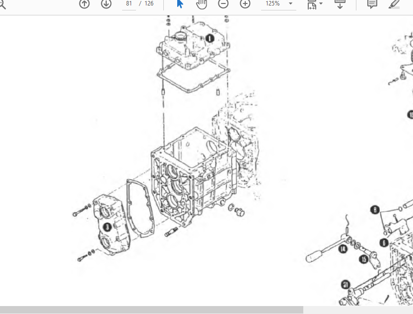

And last question: i want to change the gearbox oil (16 liters??), but cannot find the drain plug location in those manuals. Can anybody point me in the right direction?

   / Iseki tx1500 name of lifting arms part? #30
Hi, I hope I am correct but here is the drain plug, page 81 on my manual
Drain plug on the lower side of the gearbox.
Hope this works.
