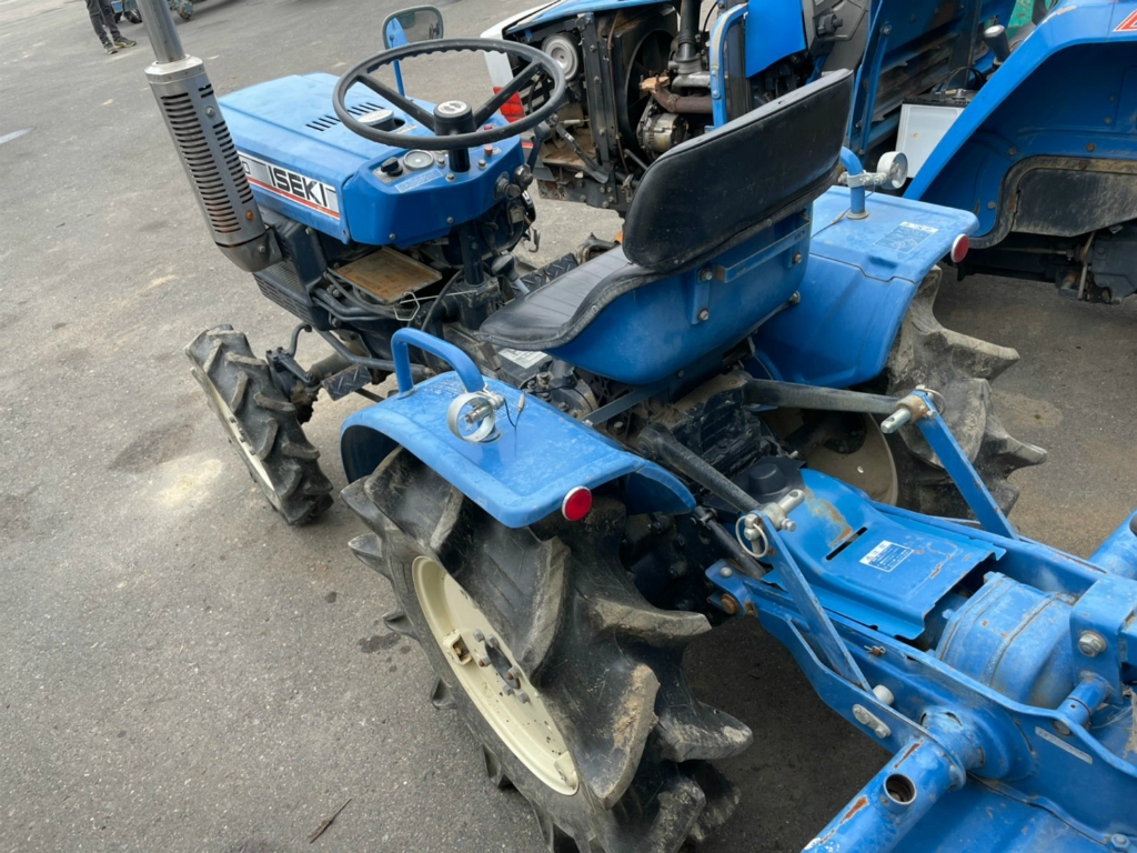

I am trying to work out how to mount the tiller on my Iseki tx2160. I can see that it does go on a 3pt linkage.The 2 short link arms go directly onto the lift arms but how do the 2 lower mountings attach to the tractor? Any drawings or pictures would be a great help.

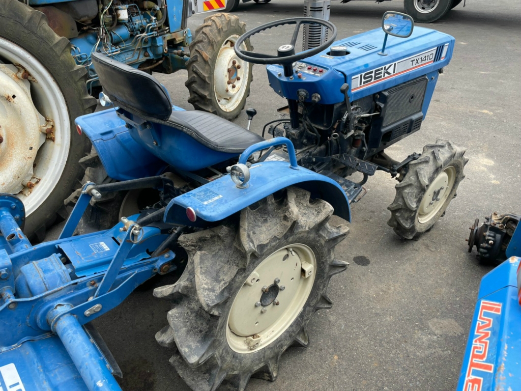

Posting in this section of the forum is perfectly fine. I found a picture online, maybe this will help you out:

Yes, this model has the short and quick lift rice-paddy setup. So the lift arms attach directly to the tiller. There are no lower 3-point arms. My Yanmar is setup the same way when using the Yanmar tiller. This is the common Japanese method for tiller setup.
This tiller would need the very short PTO-shaft too. It would have the double knuckle universals.
