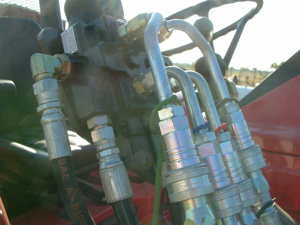

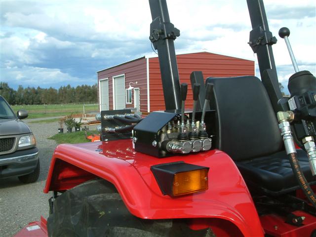

Dave, I think she is talking about the female outlets, they should fit I would think. :confused3:
Brian, I bet you are correct. I suppose they could be moved more towards the center of the tractor. Each model needs to be sorted out as far as where things fit. Ideally it may be better to be closer to center if you are running top/tilt cylinders. But the three-point arms come way up and it is easy to pinch hoses or may them "quick disconnect" where they should not be....:rolleyes:
/ Is this typical Mahindra service? #25
Brian is so right. Not the valves and levers, just the QDs.
hugs, Brandi
On my tractor, they could be moved off the top of the fender. I could have a bracket off of the ROPS mount bolts to hold it. Or move the tail light some to mount on the fender side behind the rops. But I have room for a 3rd set of QDs right beside the OEM ones.
hugs, Brandi
Brandi, there is a 3rd rear remote available for your tractor, no reason to be scabbing on any after market stuff. One of these days in all my spare time I will be putting a 4th rear remote on the 7520. I'm just going to use an electric diverter. If you only need 3 rear remotes, OEM is the way to go. If you need more, then no reason to mess with the OEM 3rd unit and just use the diverters to get as many as you need. I don't think you will be moving your light at all, or did you get another tractor? Your 6520 has the lights molded into the fender doesn't it?
On my 3215, only 1 rear remote is available:(, which I have. I needed 4, I now have 4 by way of 3 electric diverters stacked together. :cool: The grey control grip is mounted on the OEM control lever for the rear remote. It has 2 button switches and a trigger switch. :thumbsup: This system seems to work quite well. ;)

Brian,
I am not in the market for a 3rd remote. I was just inquiring on the installation in the photo above having the QDs move to make the fender less "busy". The light movement would be for the tractor in the photo. But I am just guessing here. Your fit rite website has a lot nicer installation. I can not see me needing a third remote any time soon.
Why are you thinking about adding #4?
hugs, Brandi
2 for my top & tilt and 2 for my rear blade for angle and offset. Same requirements for my heavy duty landscape rake, if I can ever get around to building it. I have everything to do all of this stuff, everything except time. Very precious commodity time is, something that is free and yet is irreplaceable. :(

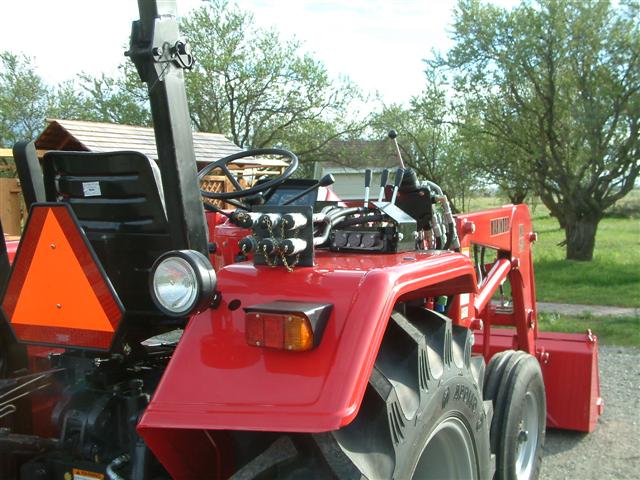

Can these three remotes be mounted on the side of the fender? Just to the left and below the light in this photo.. <img src="http://www.tractorbynet.com/forums/files/mahindra-buying-pricing/389834-typical-mahindra-service-remotes-5525-2-jpg"/>
Or would that interfere with 3PH arm movement?
hugs, Brandi
I was thinking similar, somewhere where the hydraulics don't drip on the tractor. Also, I paint my spools right out of the box so they don't rust up.
