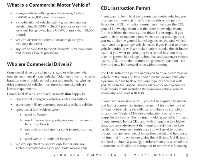

Well a friend call me and said you not gonna believe what happen to me today.I was pulled over by the state police and he gave me a ticket that carries a fine up to 10,000 dollars. He was pulling a trailer with equipment on a trailer dull wheel pick up and they wrote him a ticket for not having a medical card because his total weight was over 10,001 lb. I never heard of this have you?

"total weight" ..... on the trailer?? ..... "was over 10,001 lb."?
Was the combined GVWR over 26,001 lbs.?

OP says:
Location south west virginia
From:
https://www.dmv.virginia.gov/webdoc/pdf/dmv60.pdf
Bruce

no I have had a CDL for many years and am aware of the weight limits. the reason I didn't put the state was the trooper said it was a federal law that if you transported anything with a combined weight over 10.000 lb you were required to have a medical card.

I hold a CDL, I think I would have to disagree initially.
Here is Ohio's handybook, page 19 has a flow-chart, which based on that chart a CDL would not be required, assuming the GCWR is under 26001. Despite the fact that the towed vehicle is 10k+.
http://statepatrol.ohio.gov/doc/truckbook.pdf
/ Is this the law #11
Same in NY. as long as the GCWR is 26,000 or less and not for commerce a trailer over 10k can be towed with a regular class D license.

Not sure about Ohio or W. Virginia but NY only requires a med card for CDL licenses. Card is not required for non commercial licenses. Maybe the cop is trying to bend the law due to commercial plates on the truck?

They do it all the time here in Maryland , BUT only if you are commercial , like pick up with a trailer hauling mowers . A 1/2 ton truck is a gvw at 7K truck and a dual axle trailer is 7K , so you have 14K lbs , you need a dot number and medical card . PERSONAL truck and trailer , you shouldnt need one . The main thing is you dont have to tell the officer where you are going , what you are doing , and definatly dont tell him you are using your tractor to make money .
/ Is this the law #16
As far as I know, your only required to hold a medical card for a combined weight over 10,001 lbs if your driving commercially. I am a non cdl, commercial driver, who has to have a med card for work. Work Truck weighs 14,000 lbs.

Virginia is the same as most states total gvw has to be over 26,000 lb and the trailer over 10,000lb but all is exempt for personal use.
