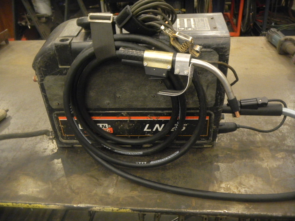

Ok, spent some time researching my options this morning and I'm not liking the 1/16" wire. I think it's just too much wire for what I'm typically going to do. I think I'd like to change the machine down to .035 or .045 and go with a flux core wire. I already have a couple of spools of .035 solid wire, but I don't have a gas regulator and will be welding outside for the moment. I do have the cylinders so to upgrade to gas will be no more difficult than buying a regulator. I want a all position wire so it's very versatile. Ease of use and appearance is important. My dealer recommended a E71T-GS wire, but I believe you can't multi-pass with it. I was thinking of a E7T-11 (NR-211). What I don't know is if this wire is copper coated. I'd like to have the coating to keep the wire from rusting before it can be used. The machine is a PowCon 550 with a feeder. On single phase I'll have 30-375 amps. Thoughts? Recommendations???

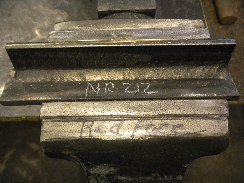

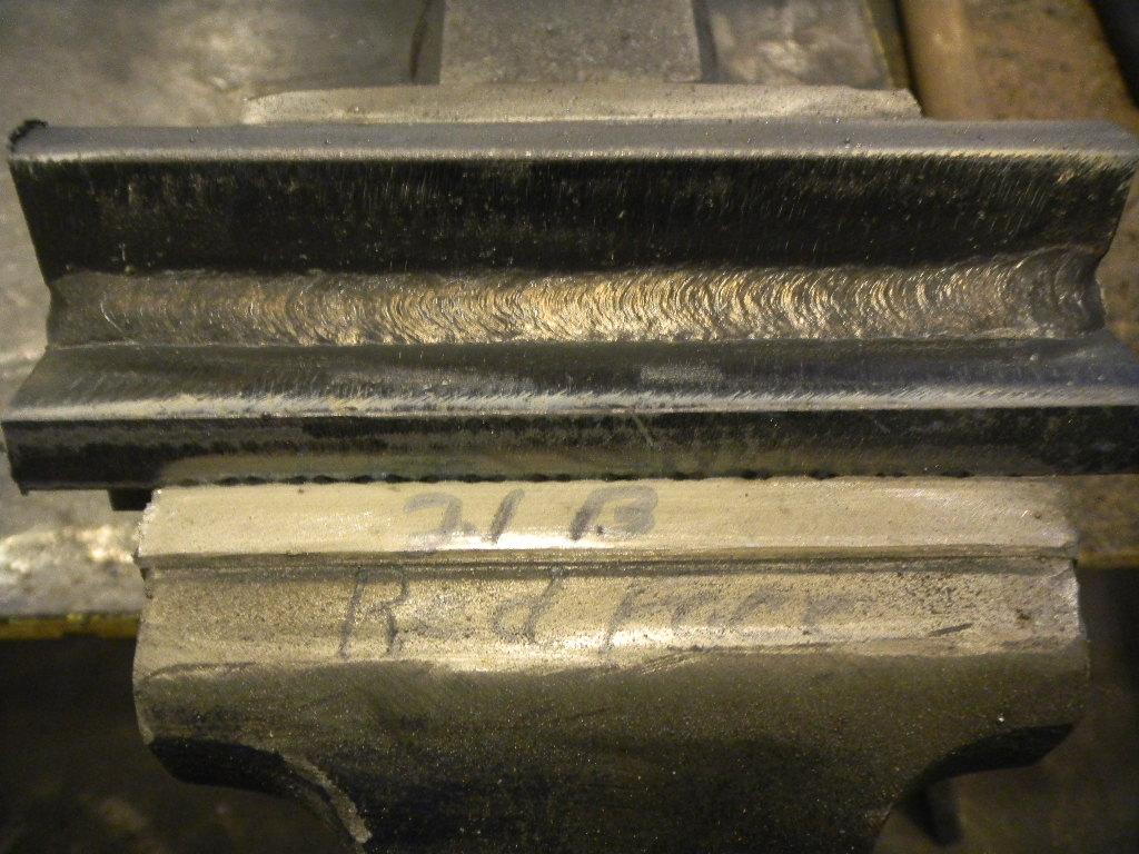

Cord I've run a little self shielded wire in the past. Hobart's 21-B, and Lincoln's NR-212 are great wires.

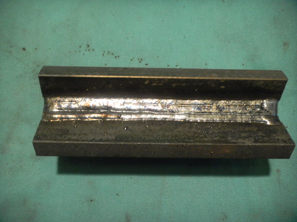

The 21-B weld is 1/16"
The NR-212 is .045". Both of these welds were made with a CC only engine drive welder. You'll get even better results with a CV machine.;)

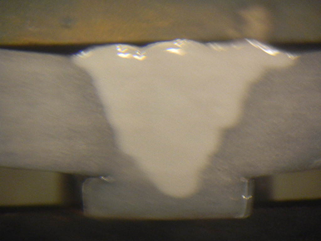

Before the Northridge earthquake in California the manufactures didn't put thickness limits on their wire. I think Hobart says the limit on 21-B is 3/4". I can't tell you how many 1" side bend tests I've passed with 21-B.
You might get away with using a regular Mig gun for shelf shielded wire up to about .045". Any bigger wire and you will need a flux core gun. And don't be surprised if you have trouble with .045" wire if you run real hot.

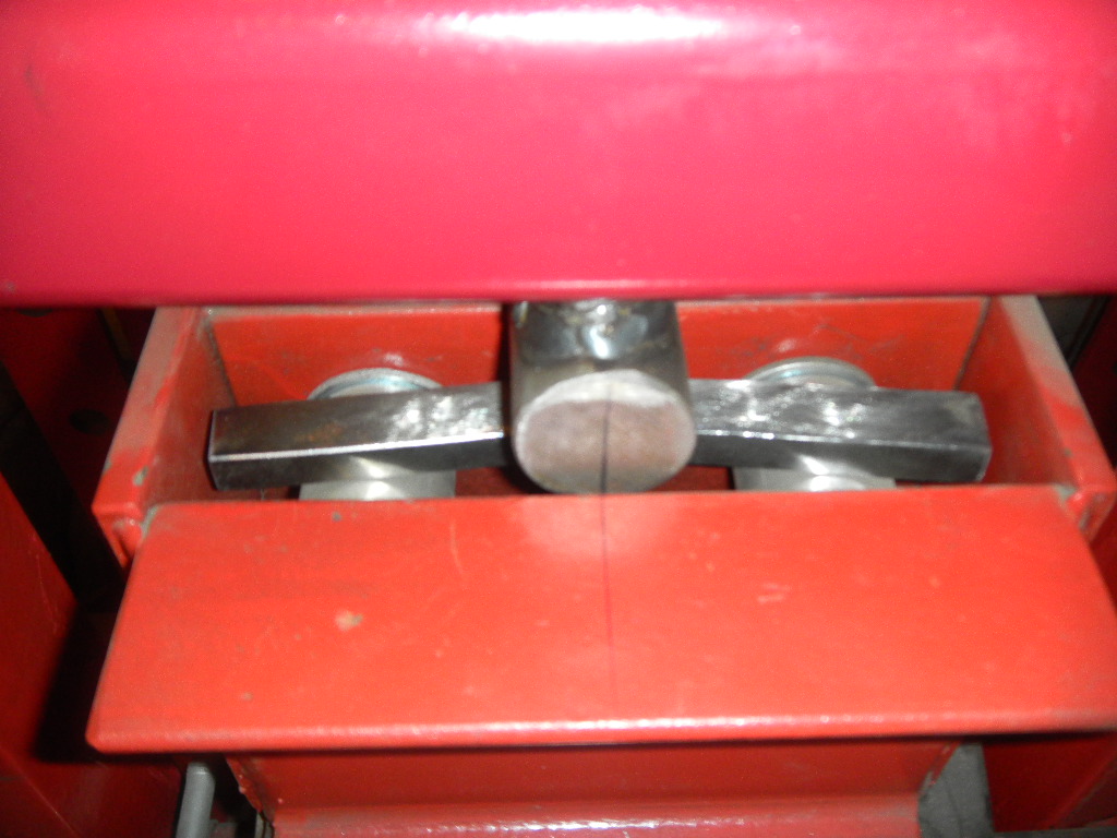

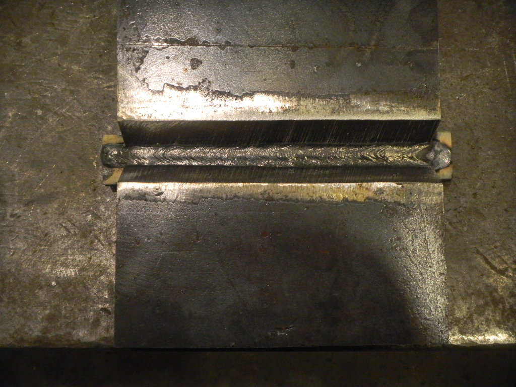

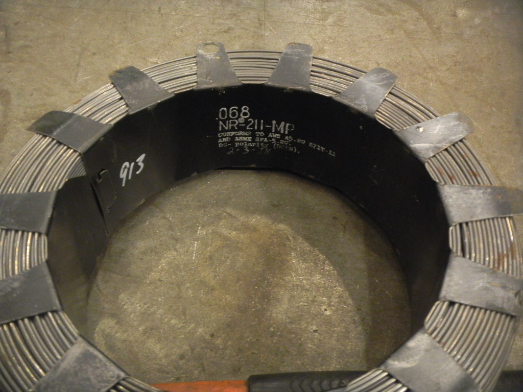

Last summer I found a roll of NR-211 in my Dad's barn that I took off a job in the early 1980s. Over the years several welding inspectors told be they never seen anybody pass a bend test with NR-211. So I had to give it a try:D. This wire even had rust on it:eek:.

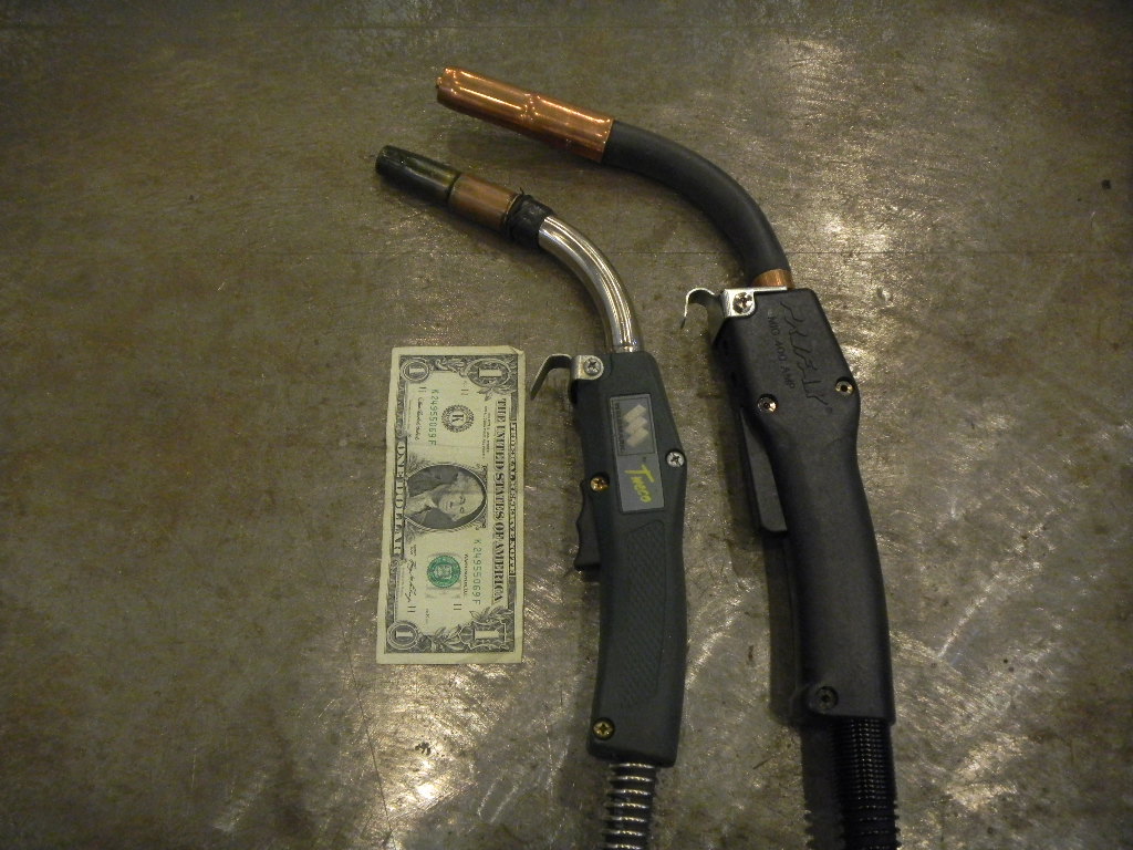

Oh, I forgot!:eek: I've never used a Bernard gun. I hear they are great guns tho. I've used Tweco guns since the early 1970s, never any trouble out of them.

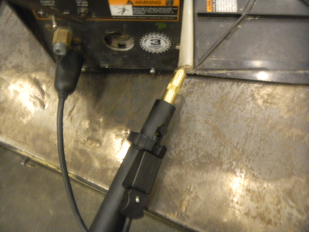

I know the prior owner was running 1/16" build up wire through the mig gun. I think what might be controlling the heat is that the gun is a 400a Tregakiss. Sure would like to lose the nozzle though. I'll probably keep it on because it's helping to protect the diffuser from splatter.
I don't know what the back end is. Bernard says that it's supposed to be a Tweco #4, but it doesn't look right. Almost looks like a Miller back end.
