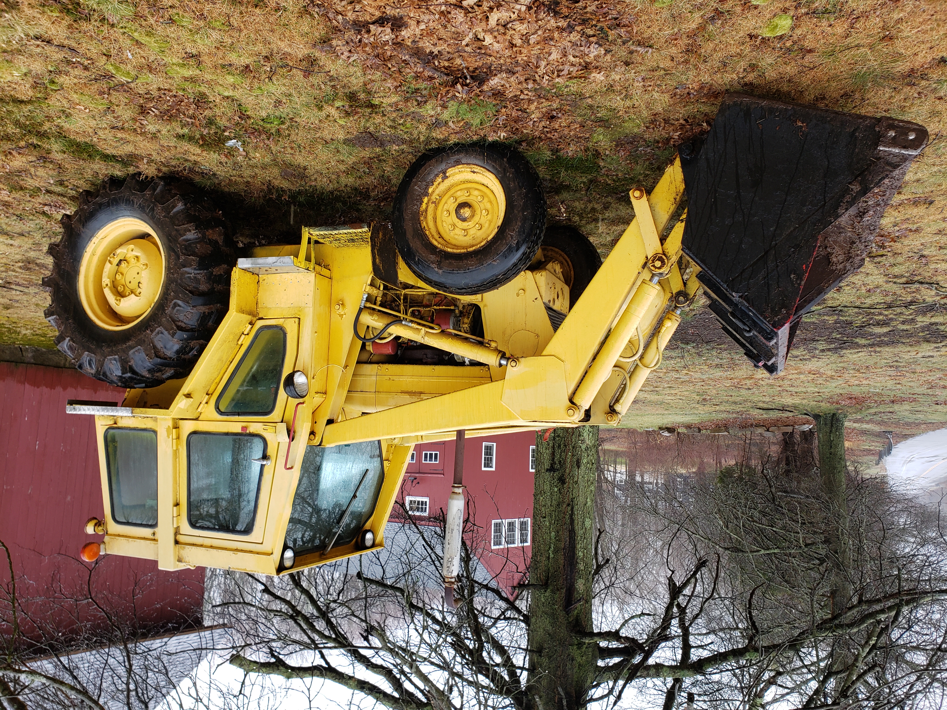

Hello everyone,

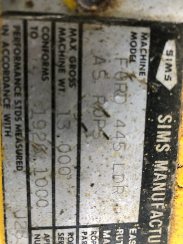

I am interested in buying a Ford 445 that's for sale in my area. I wanted your input on a few different things.

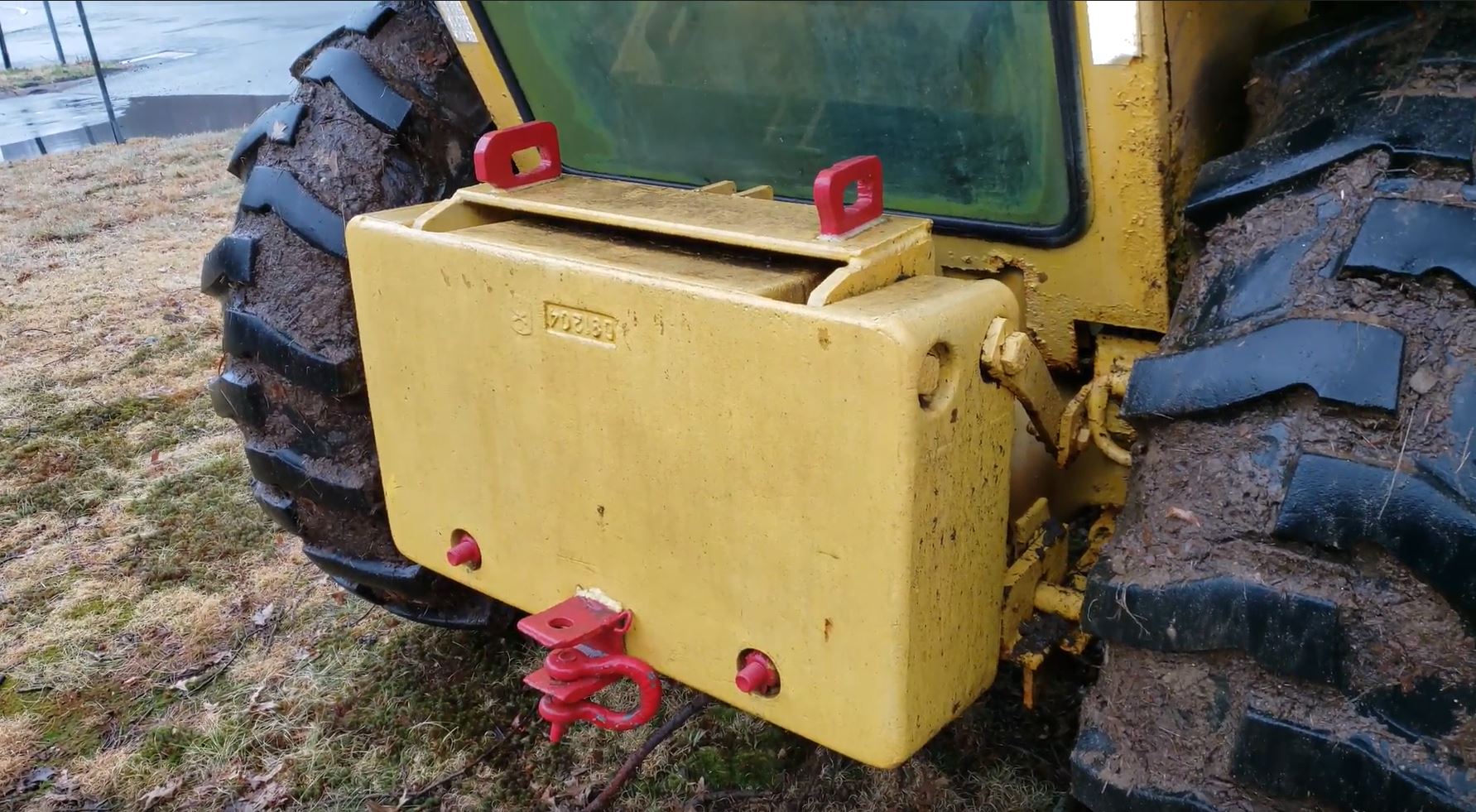

The tractor doesn't have PTO or 3 point hitch. Is it even possible for these tractors to NOT have 3 pt hitch? yes.
The tractor weighs 13,000 lbs. is that correct? Very possibly
Without influencing your thoughts, how many hours would you consider to be "too many" hours for this tractor? Depending on maintenance and care, many thousand
What are some of the things I should look at before buying it?
All the normal inspections and checks, if it has a power reversing transmission be sure it shifts and pulls well at operating temperature.
I am a total noob when it comes to tractors and your help is greatly appreciated. I have attached a few pictures for you to look at.
thanks,
Ali
View attachment 648491View attachment 648492View attachment 648493
2 WD is not ideal but not completely useless. Tractors were around for a century before mechanical front drive became mainstream. You cannot but a new tractor of any brand built as robustly as that.

The owner is telling you the tractor you posted photos of is a 4 wheel drive? If so, walk away. If he is lying about something as obvious as that, Lord knows what else he is lying about. The pictured tractor is clearly 2 wheel drive.

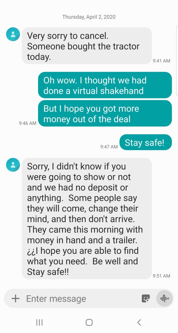

So I received a text just now and the seller sold the tractor to someone else :(:(:(. I am really annoyed and this delays a lot of things for me but everything happens for a reason and I hope I find something better soon.
