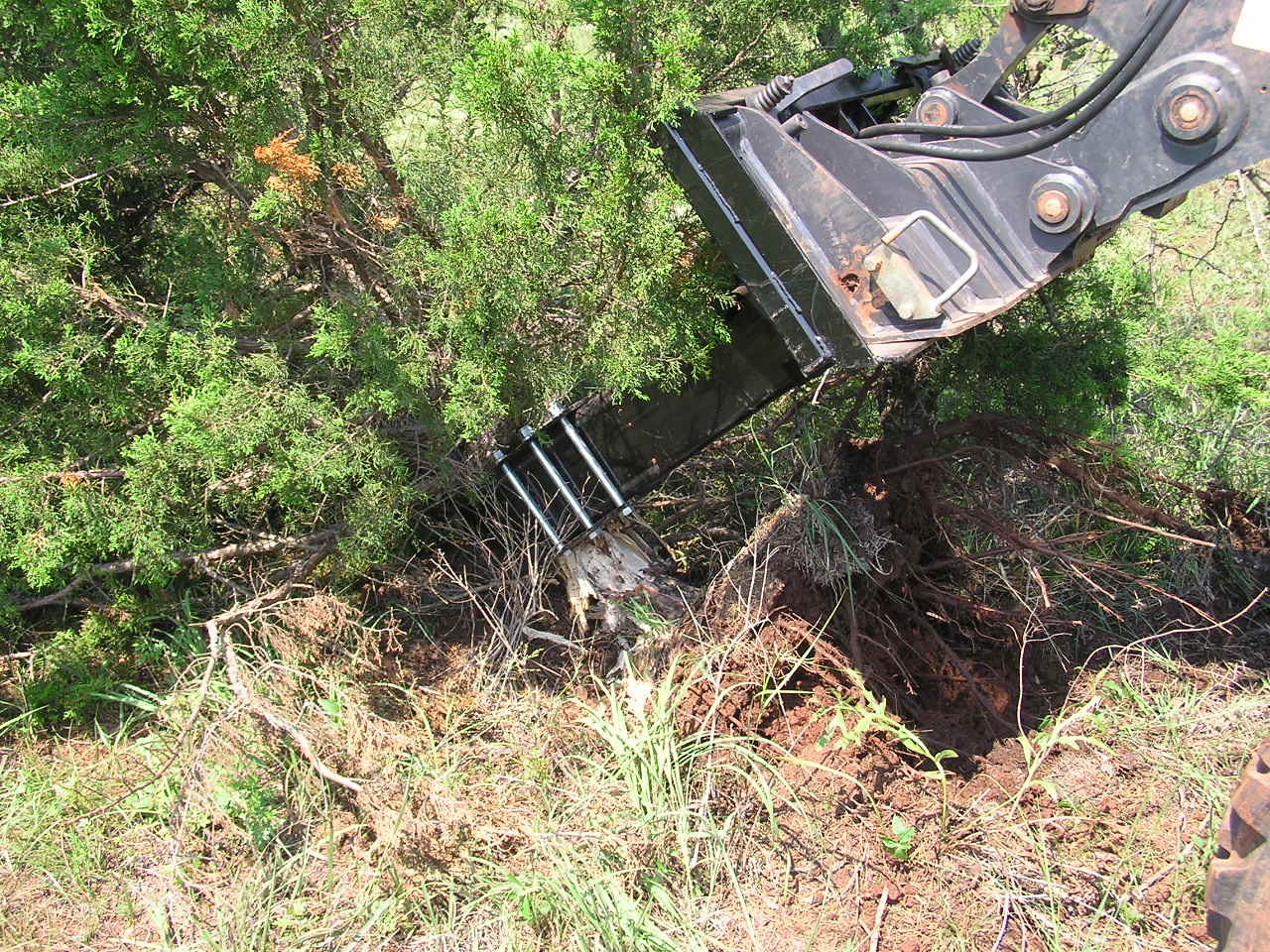

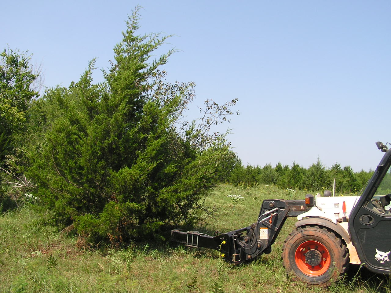

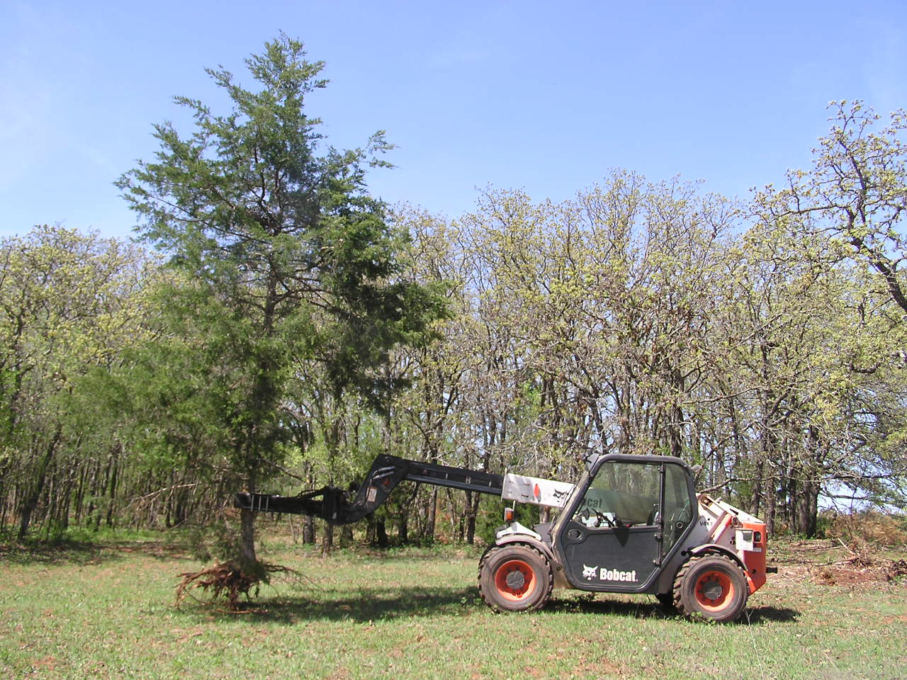

Mine is a long arm tree puller, vertical only, does not rotate:
What do you want to use it on?

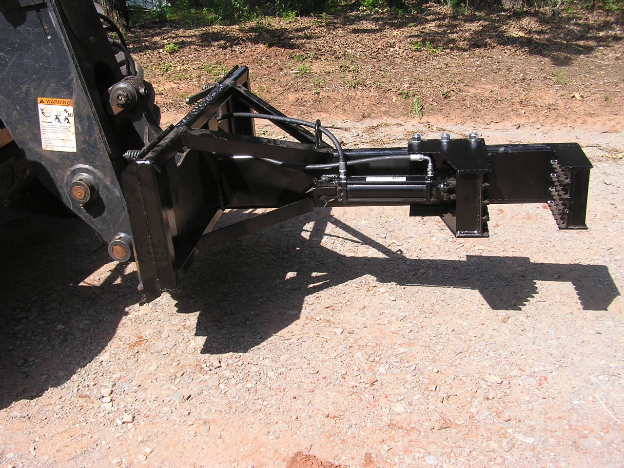

This is a post grapple:

That vertical tree puller of yours - Xfaxman - is a real nut cracker. You are able to reach out and simply pull big trees right out of the ground?? That represents a lot of brute power.

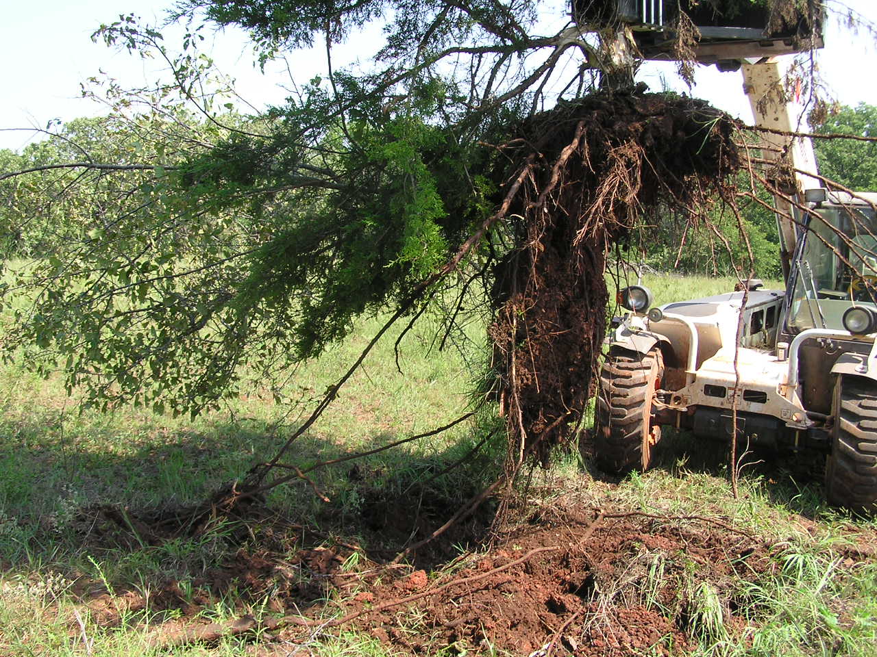

Yep, over 6,000 pounds of lift and 7,000 pounds of push/pull, plus the boom extension force that I haven't measured.
Clamp on the tree trunk, raise up, curl down, extend the boom moving forward, then still pulling up, curl up in reverse, retract the boom and out it comes:
Here it is pulling 2 for 1: Tree Puller?

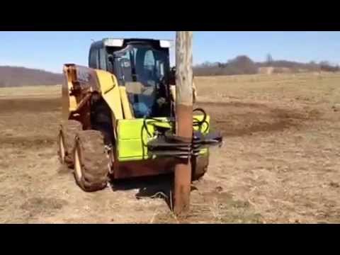

This guy uses his vert grapple to pick up logs with his toolcat (ssqa).

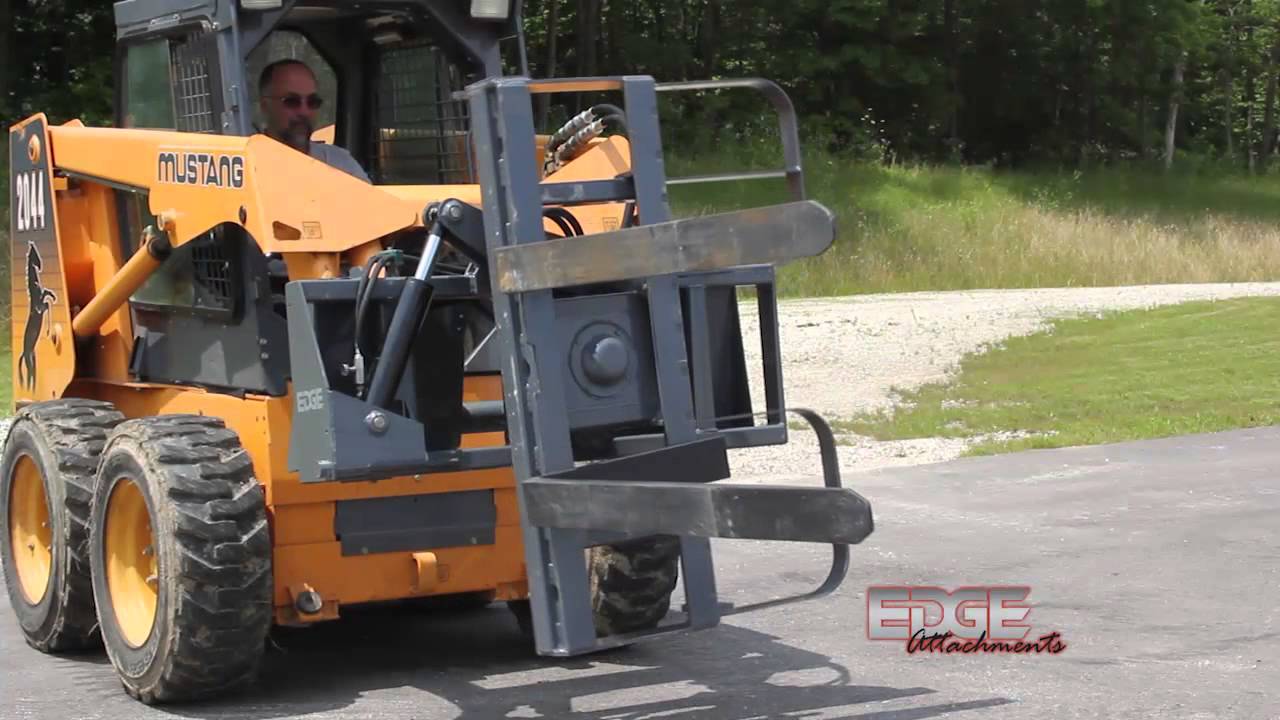

Rotating quick attach. Would be nice if someone produced a manual one that you could pin or bolt into the vertical position.
Ditto. That would be sweet!
/ Is there a Vertical grapple type attachment? #15
Just weld an SSQA plate to an SSQA adapter (Universal Mini Skid Steer Adapter Plate) 90 degrees from each other. WHEN you need it rotated, get the adapter.
