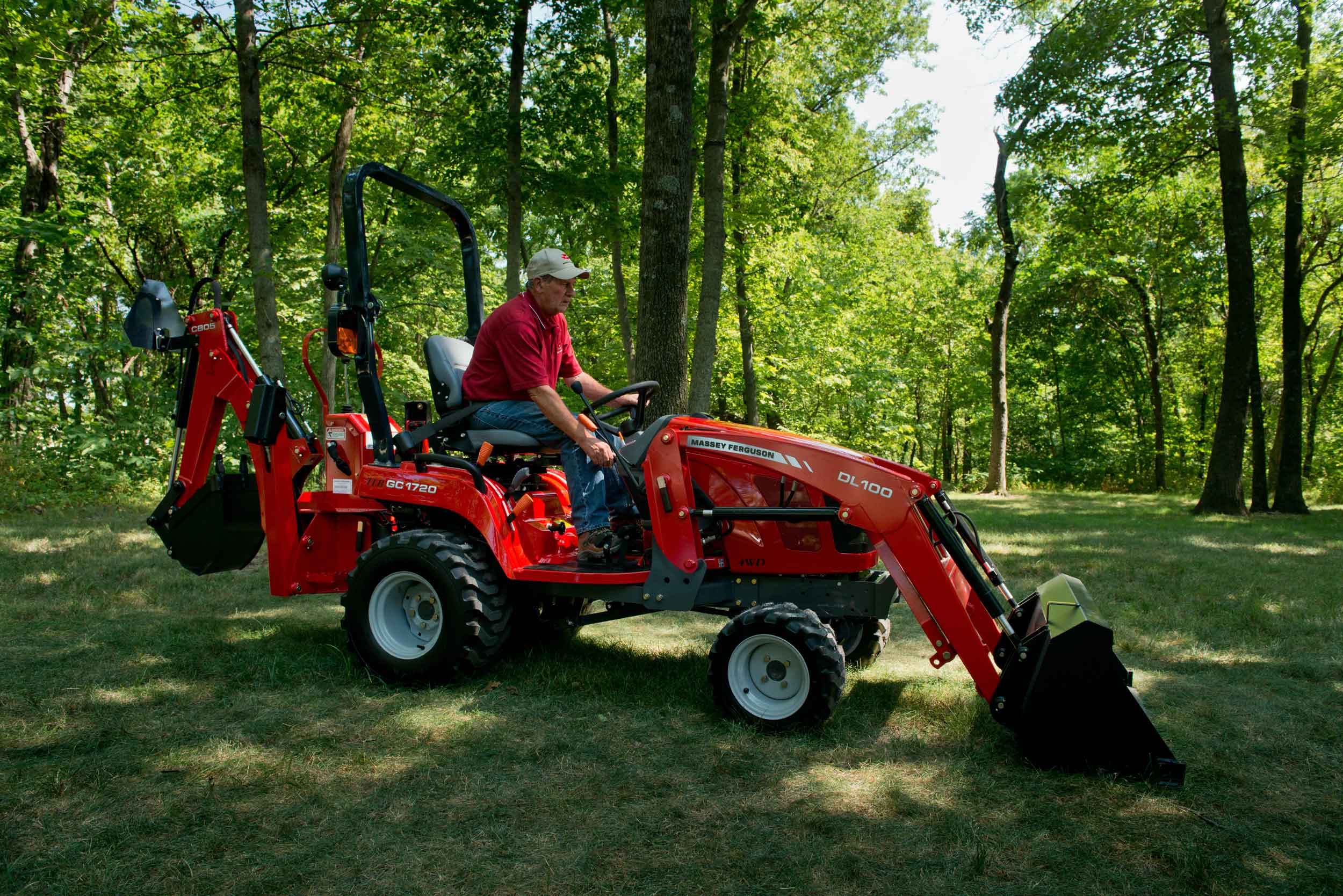

I have a MF 1720. Been very impressed with it's power. There is a place for a smaller, lighter tractor with a short turn radius to get into tight areas. Attachments I have so far are a front snowblower, Curtis cab with heater, Woods back blade, Hydraulic feed wood chipper,(some expressed concerns that the 1720 couldn't lift it and run it but it does), front quick hitch with forks. Going to purchase a rear ripper to tear apart pot holes and general use at the farm. The 1720 and 1710 come with a back hoe,
used that a lot for various jobs. I wish it had more ground clearance but I learned to work around that.
