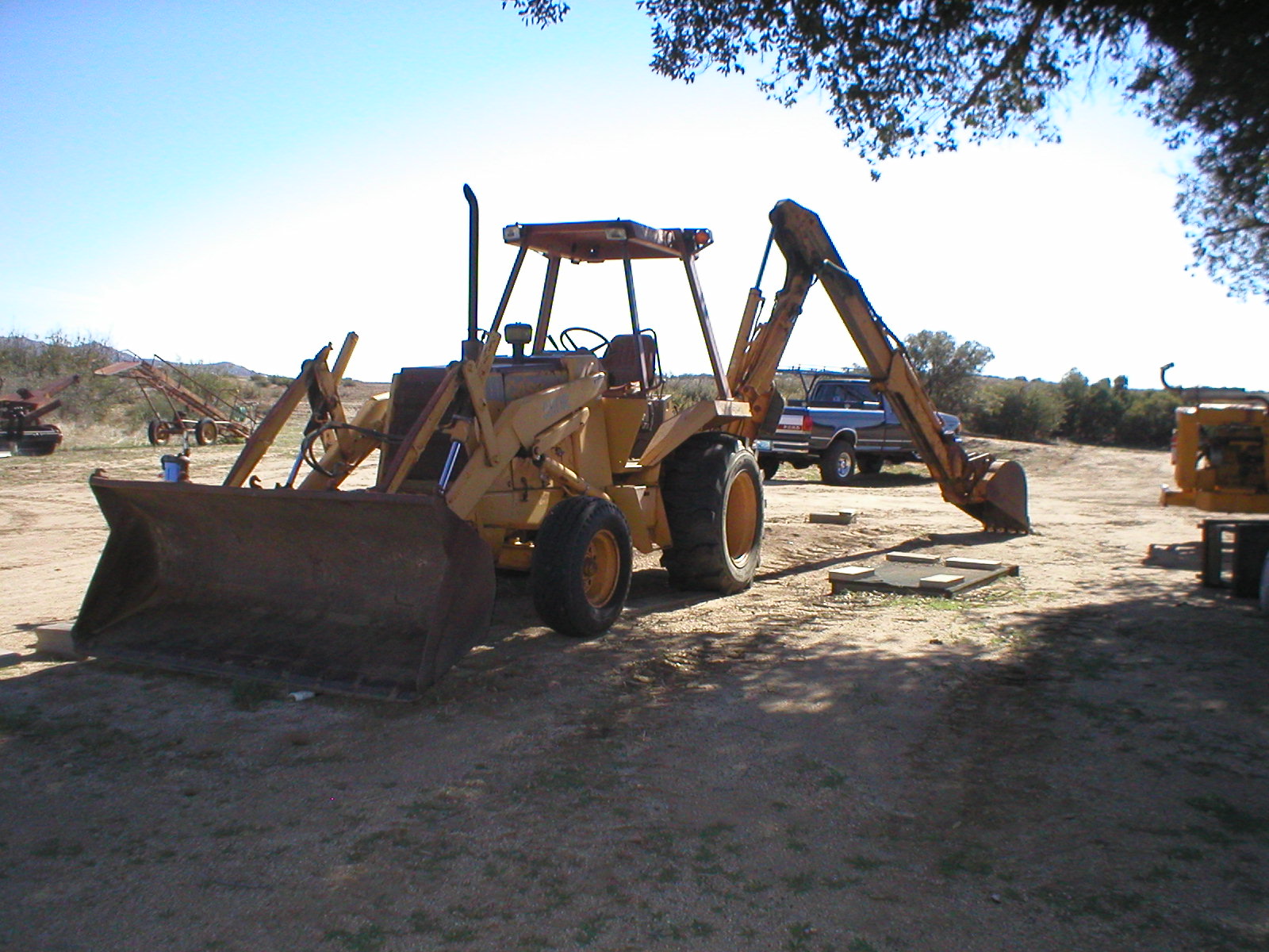

What gear are you in, how much throttle? I have 2 older Case tractors, a 310 dozer with over 10,000 hours and a 580 e with about 8000hours with original engines and both will spin tracks, tires no problem. Now they will not do it in 3rd gear, but the dozer in 1st or 2nd and the 580 in 1st. They both seem to have plenty of power for old warn out machines.
