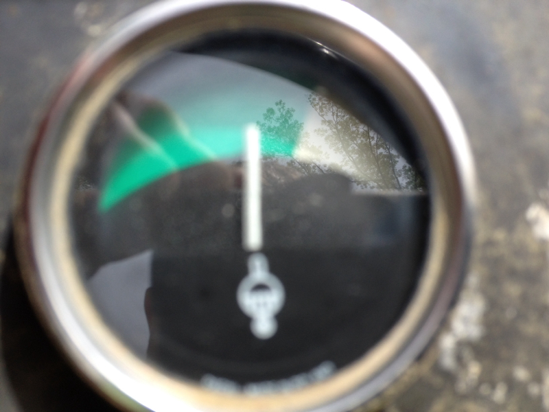

How about a pic of your gauge when hot..
   / Is my MF 231 running too hot??
#251
Hot?
If it's idling or under a load with the tiller it's still between the "G" and "P" on the gauge.
This was taken the other night. It's in the same position as when using the tiller today. Never went higher.
   / Is my MF 231 running too hot?? #252
Straight up and down, same as before.

#254
Definitely not the same as before. Yes, I agree the needle reads about the same in both gauges WITHOUT the engine being under a load. But where the difference comes in is under engine load, which is why I thought the tractor was running too hot in the first place.
It has never hot on me. But I knew something wasn't right when the needle kept climbing under heavy engine load.
I used the tiller this evening under heavy load for a while. The needle never went up.
With the old radiator cap and temp gauge the needle would have been almost in the red.
I'm pleased knowing the problem is now solved. Wasn't near as bad as I thought it was at first, but I knew something wasn't right. I've had this tractor for almost 7 years and the old gauge never read as high when under a load, as it recently did.
