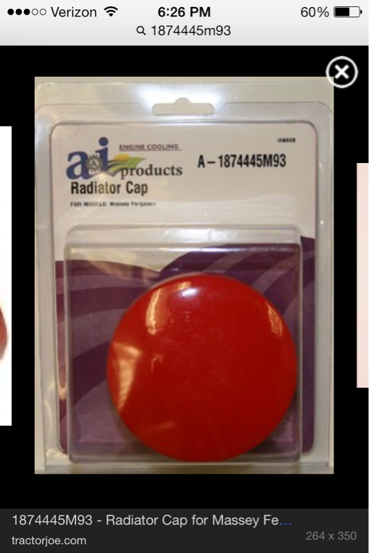

Since I've owned the tractor, even while bush hogging, coolant has never boiled out.
Also, when the engine is cold on first start up and I turn the key to the "on" position (without starting the engine), the needle moves up slightly into the green and stays there even when I start the engine (but needle rises of course when temp rises).
New radiator cap is on the way...

Just tilled for 15 minutes. Ran engine hard under a load. Temp at thermostat housing was 154. Let engine idle for a while, checked temp at same spot on thermostat housing and was 148...
Maybe the new radiator cap will make a difference, not sure. But I'm starting to think there was never a problem with it. Haha

If you replace the radiator cap, keep a close eye on loss of coolant. I have seen people damage a cap when they have a leak, including into the engine. When the pressure is not allowed to build up it can mask a bigger problem. Watch the color of your oil and exhaust as well as visible leaks.

Thanks for the sound advice. I check my oil every time I get ready to use the tractor. I do mean every single time. So far I have never seen the oil milky or anything. Occasionally I add some but that's it.
I've bush hogged grass in spots that's as tall the tip of the exhaust. With 1,155 hours on the tractor, that Perkins engine has never gave me a minute's trouble.
