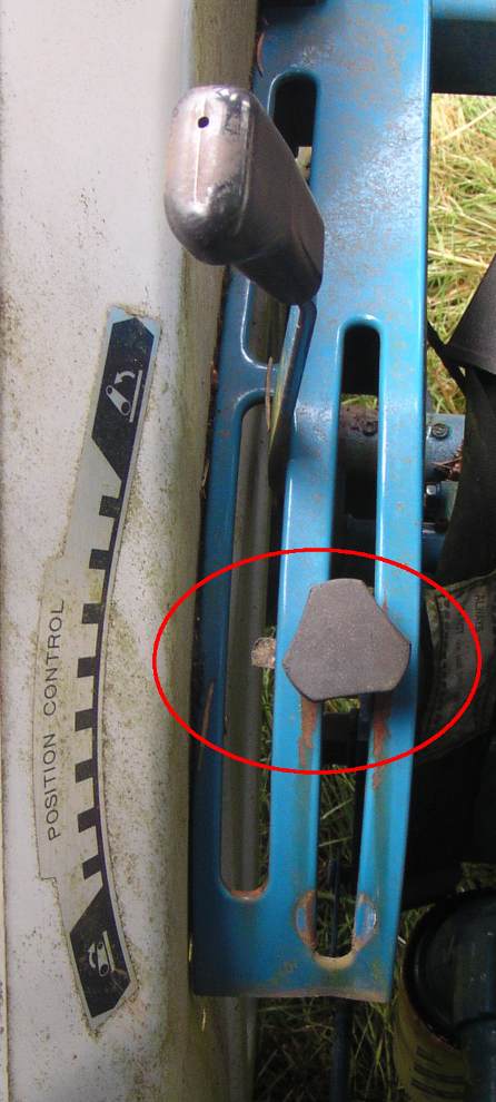

My Ford has a stop on the 3pt height adjustment lever.
I don't like it, so I normally push it down to the bottom. This is designed so it only obscures half of the 3pt height adjustment slot, so one can easily push the lever to the side and around.
I haven't noticed the 3pt hitch ever "leaking down". I don't see a simple tension adjustment, but that undoubtedly would vary by tractor.
I think our old IH had something similar.
If there is only one slot, one could add a similar stop, but wouldn't have the simple bypass.
