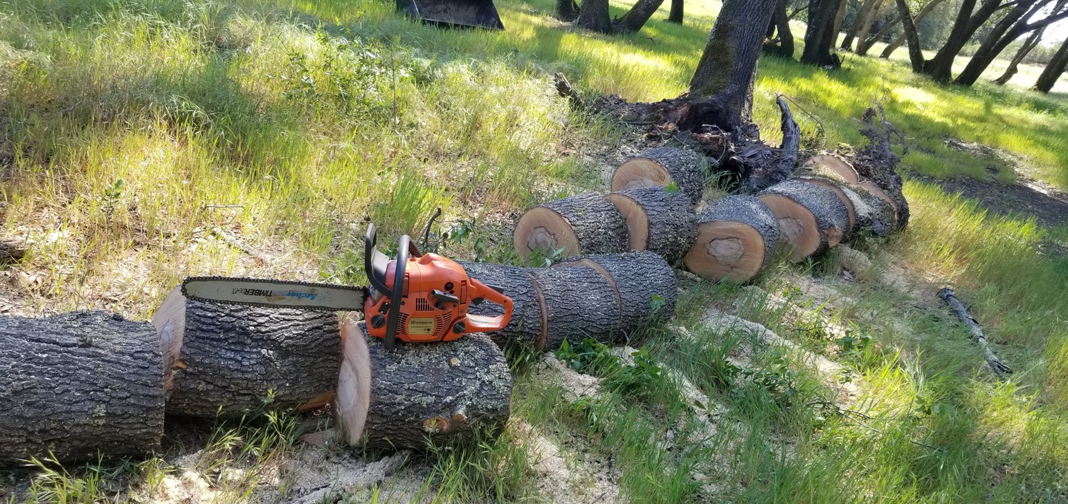

I still have Husqvarna 450 for cutting big trees that I cut couple days ago..
jkk
That picture, showing where you bent over and cut all that wood is why I like to use an extremely heavy, outdated, antique, cumbersome saw. I use a bow saw, and simply set it on the top of the log, making sure the bar foot is securely in place and then let the weight of the saw do the cutting. When the foot hits the ground, it is time to visibly double check to see if the log is completely cut thru, and then lug that old heavy relic to the next cut. At the end of the day of cutting, the Homelite Super Wiz bow saw is a lot easier on my back then using my Stihl MS310 with a 25" bar. (both of which are heavier than your Husky) Now if I have to go walking thru the woods, cutting a log up here and a log up there, then it is time to grab the tractor with grapple and bring them all to a central location!! That Super Wiz isn't something I want to carry all over the woods, but it sure saves my back when cutting logs to firewood length that are laying on the ground!

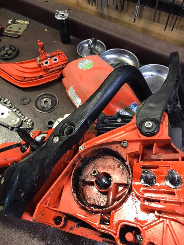

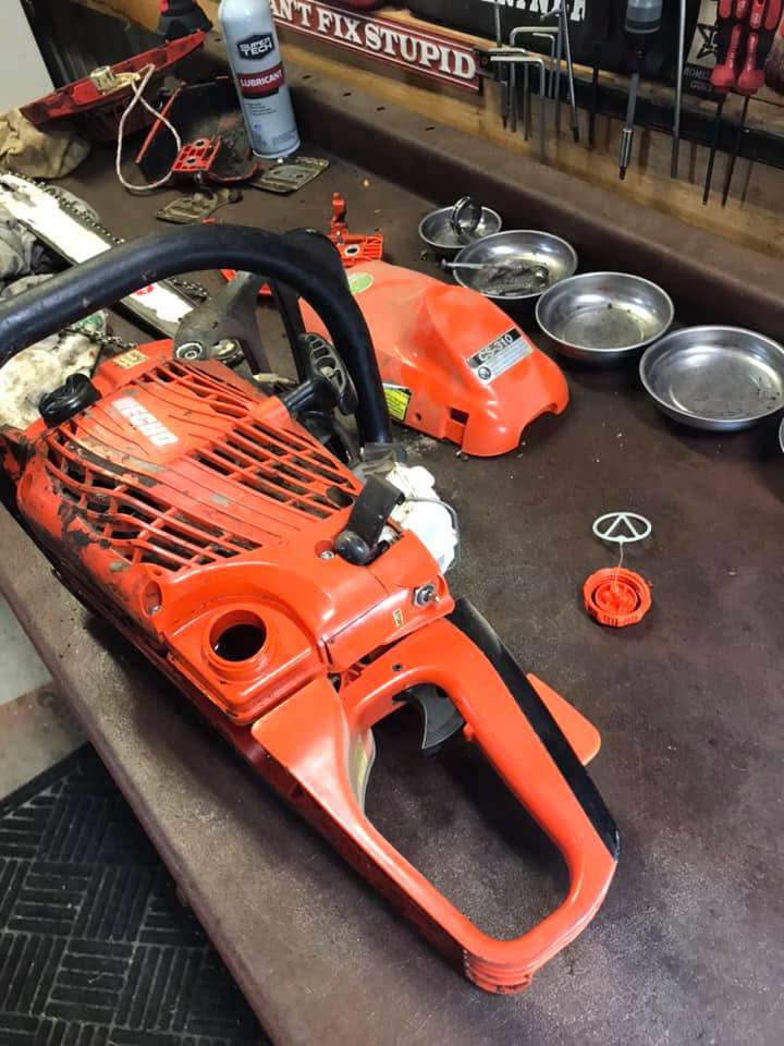

I took care of a locals 310. Lasted alittle while for him with hard use. Then needed seals. Wasnt worth the cost of labor to do the seals etc for him. So he bought another saw.
One of those saws you need to learn to work on yourself when need work IMHO.
Not a fan of any of these little plastic clamshell saws myself. But took a 180 on trade one time to give my dad with easy start on it. Being older he needed that.
