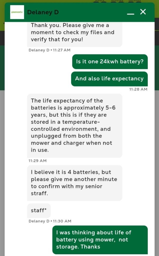

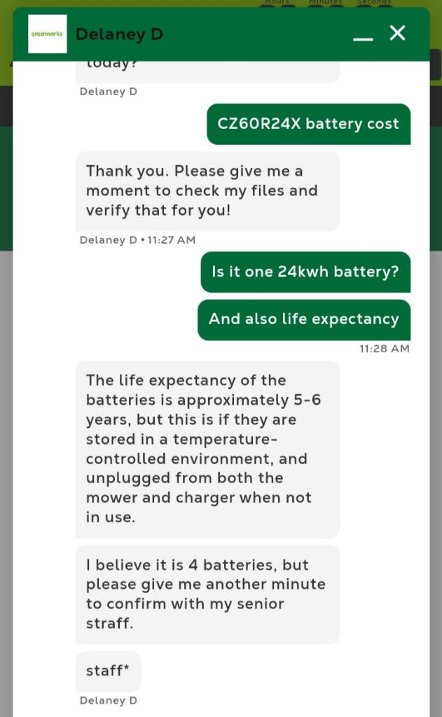

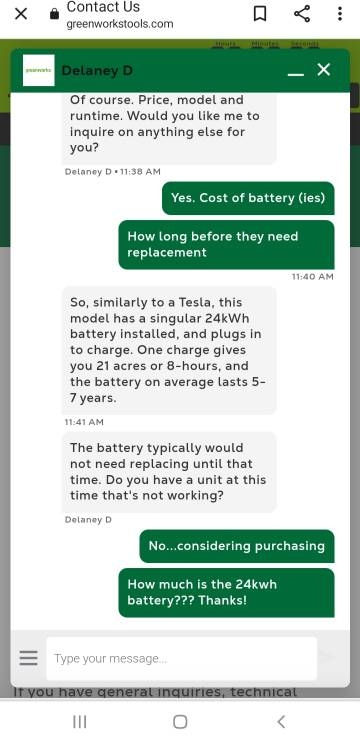

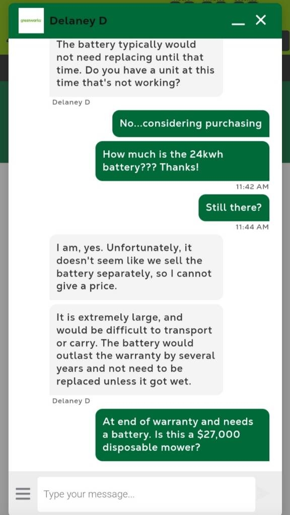

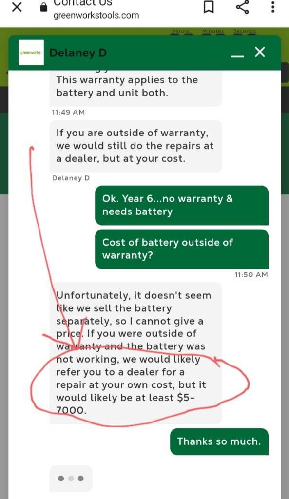

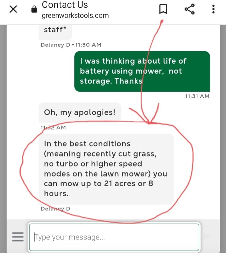

Here we go!!! I just now chatted with Greenworks. Please read!!!
