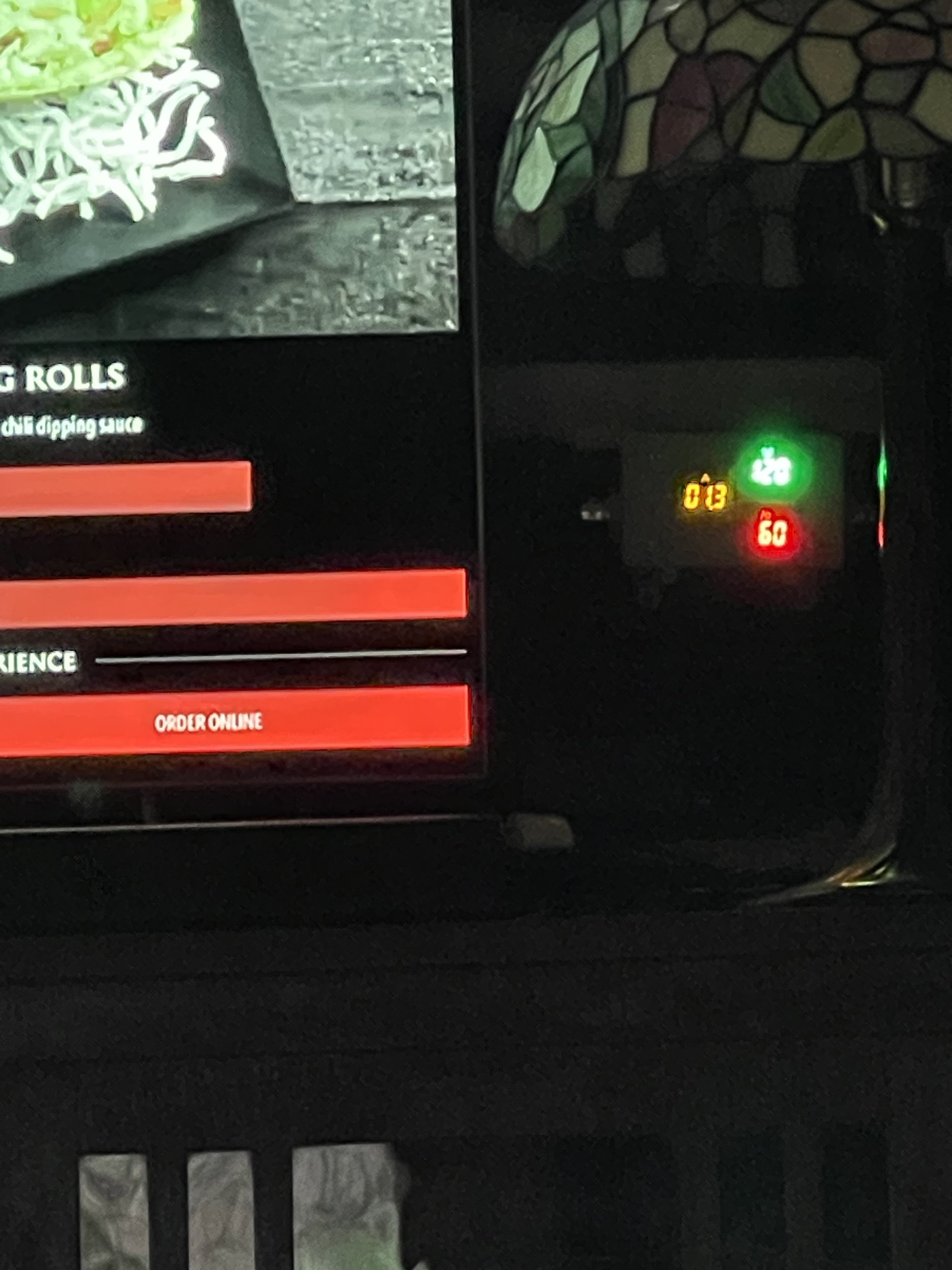

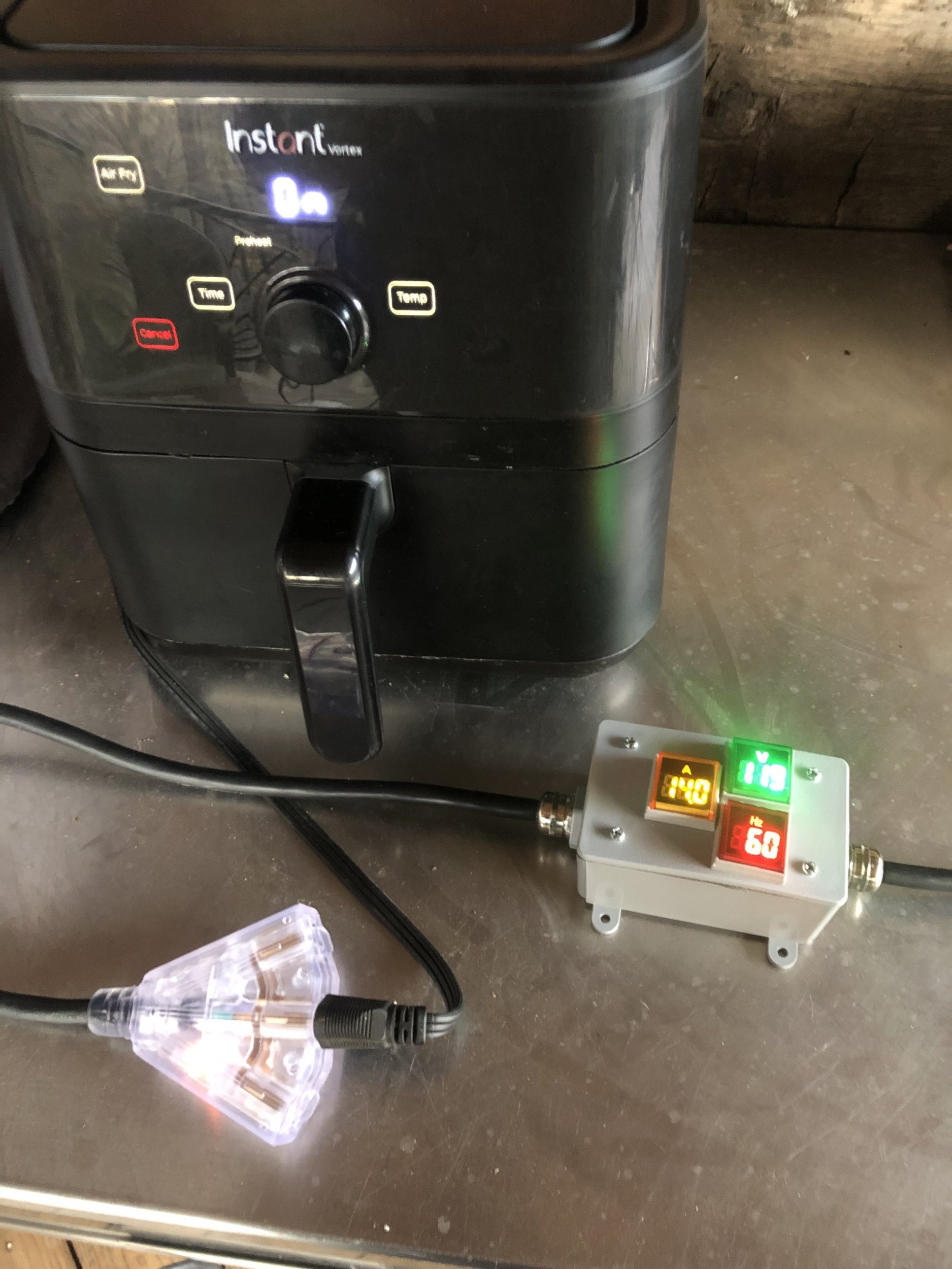

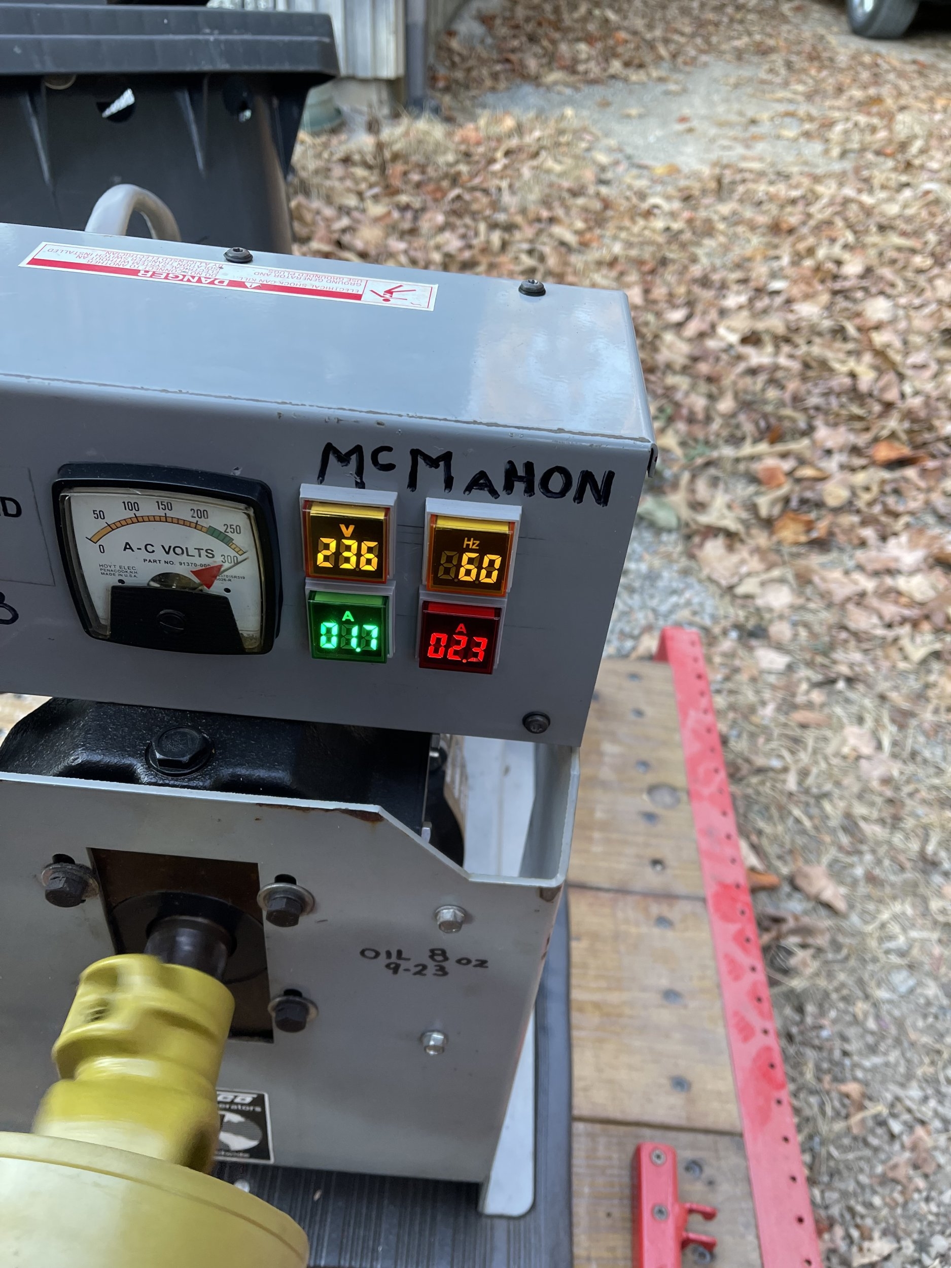

Recently added pto generator option. Incorporated some inexpensive LED meters to monitor at generator and in the house. Hertz is as important as voltage. Simple extension cord mod lets me monitor power inside the house. Currently connected to the TV and associated electronics.

Recently added pto generator option. Incorporated some inexpensive LED meters to monitor at generator and in the house. Hertz is as important as voltage. Simple extension cord mod lets me monitor power inside the house. Currently connected to the TV and associated electronics.View attachment 833617View attachment 833618View attachment 833619
Where did you get the meters?

Amazon. About $5ea. 7/8” hole for panel mount.
What is the brand? If they have a DC model it might be nice on my older tractors to monitor the battery/charging. So much nicer than trying to tell if an analog gauge has moved.
