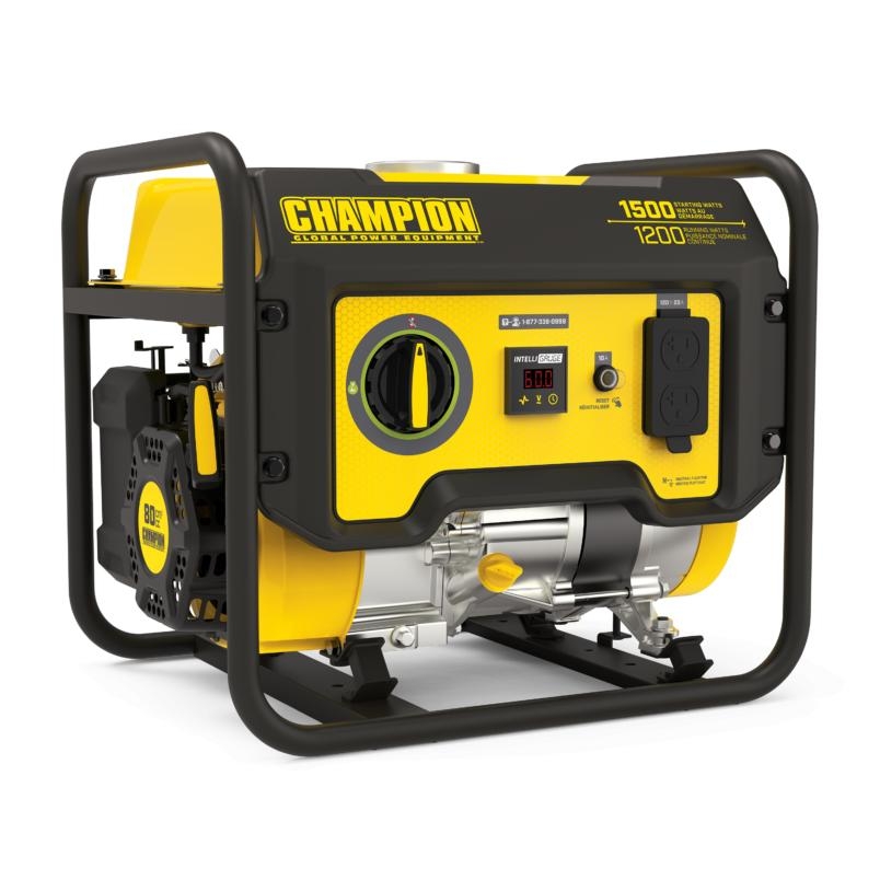

I run Champion Generators at my Cabin. Before going Solar/Gen I ran a larger 4000W which did actually fry a couple of VCR Players, but only on Shut Down. If I unhooked the Power before shut down, all was fine.
Then after Solar/Gen set up, I run a 1200w Champion in the evenings to Top Up my Bank and watch TV.
Well Over 2000hrs of 40" LCD and Blu Ray time, and have never fried any. Even with a 30A Battery Charger kicking in and out while watching.
So, I am not going to warranty a Desk Top or such, but if you are careful, use a Surge Bar, Switch it off before the Generator, and Don't think a B&S Powered Commercial/Construction Generator is the same as a Recreational Generator only Louder. You should be fine.
