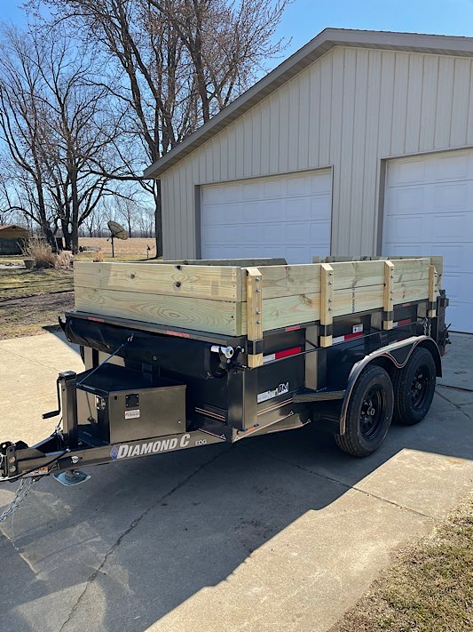

I ended up with a Diamond C car hauler, they make it in a 7k and 10k, not the lightest but it comes standard with I beam crossmembers with 16” spacing which is rare in anything less than a 14k equipment trailer.
I wanted to get the most universal trailer I could find, and when I was talking to dealers they said most car haulers aren’t good for equipment because even though they’re rated for the weight they aren’t meant to carry dense compact loads like skid steers which is where the heavy narrowly spaced crossmembers make the difference.
Kaufman was in the running and they were willing to customize but by the time I added the same options and delivery charge it was more than the Diamond C and I had to wait for it to be built.

There are manufacturers that offer 16in cross member spacing. Appalachian does on there "contractor series". I chose not to get it because I dont feel its needed. Also there 10k and 12k equipment trailers are the same except for the axles and possibly springs.
I have hauled many pieces of equipment, pallets of concrete blocks and all kinds of odd and ends with an open center car trailer and never tweaked a cross member. I owned that trailer for 12yrs.
Are you sure diamond C uses a I beam for its cross members? All I could find was a formed C channel.

So how do you add a weight distribution hitch to an I beam tongue?
   / Is Anyone Making a High Quality 7k Trailer? #38
Just needed longer bolts because the beam is wider. I went with Blue Ox because it has the shortest arms and the built in toolbox doesn’t leave a lot of usable length without modifications. I was a little concerned it would slide because it doesn’t have the face of the channel to grip but it works fine.
