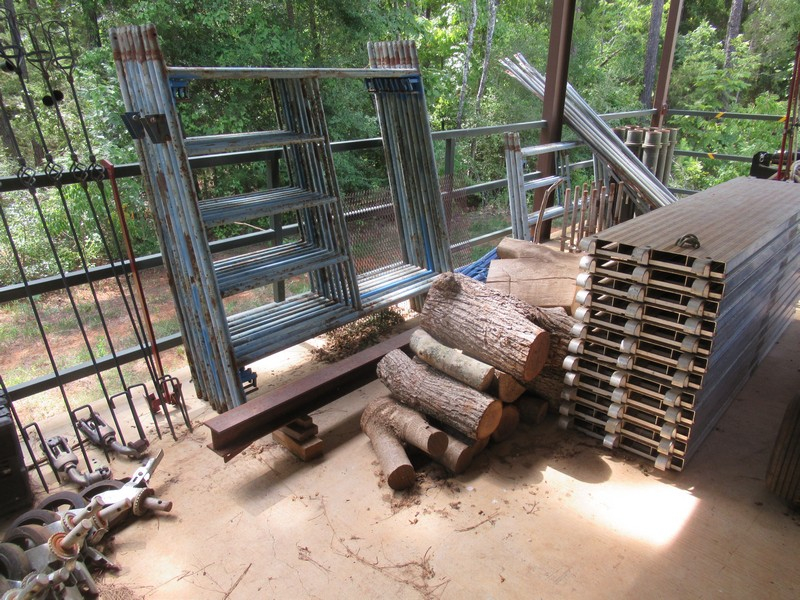

   / Is anyone here familiar with scaffolding? #104
Good Morning!
I will have to do some major home improvement projects, most notably re-staining/sealing our log home, and I don’t want to do it on a ladder. A scaffold (or two) would make for a much easier and safer job.
I have never used scaffolding before.
-EDIT/UPDATE: Terrain and deck preclude the use of a manlift or skyjack.-
My feet need to be 18’ to 20’ above grade level to be able to access all the way to the peak of the roof.
I plan on permanently attaching eyes to the sides of the house in order to rig guys to the scaffold for stability.
What do I need to know when buying scaffolding? There are so many options. I don’t want to rent, because I will have other projects in the future where it will be used, and if I own it, I won’t feel rushed to get it back to the tool rental and maybe screw up or get careless.

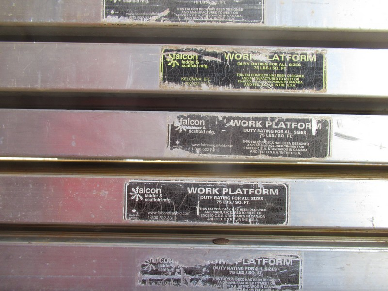

I have some scaffolds (Bil-Jak) but the upper pieces are very hard to assemble without extra help. As noted before, rent a boom/man lift. The drive to the rental place may seem far, but most also offer delivery. Kinda pricey. Self propelled are real nice, but may not be needed, depends on the terrain. You won't be sorry.

I suspect the reservations about buying scaffolding is people look at the price tag and wonder if they will use it enough to justify their purchase. When someone has a project like disassembling a collapsed carport or extensive siding repairs having to be made as time allows, then purchasing starts to make sense, especially when rental prices are high.
Since we do not intend to (voluntarily) move ever again, and I am hoping to last at least two more decades, I will be looking at at least 5 more staining projects on the house, so owning DEFINITELY becomes more economical. And that does not include all the other projects it can be used for.
