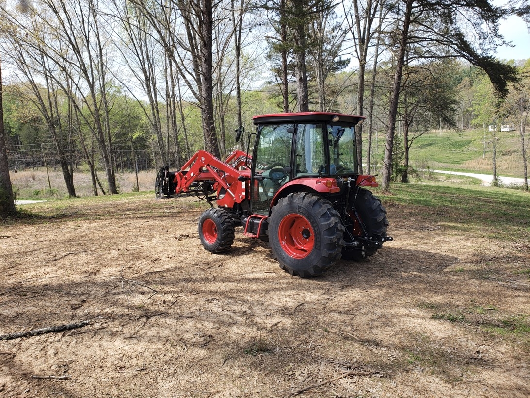

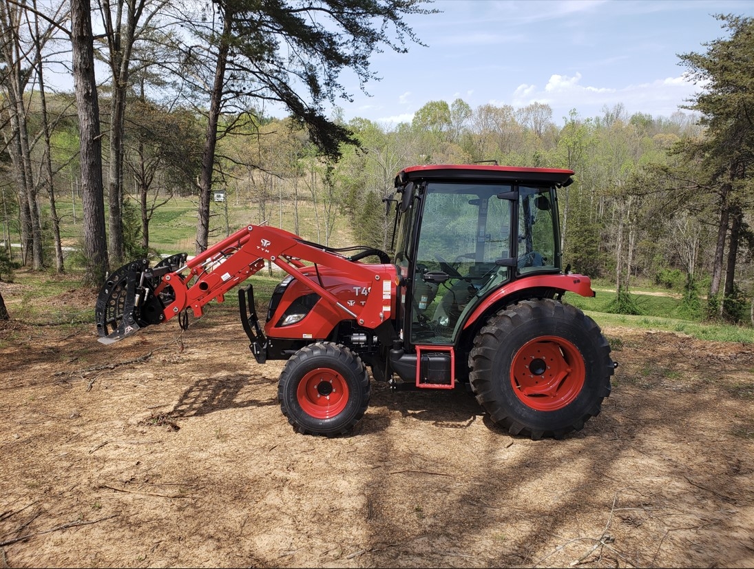

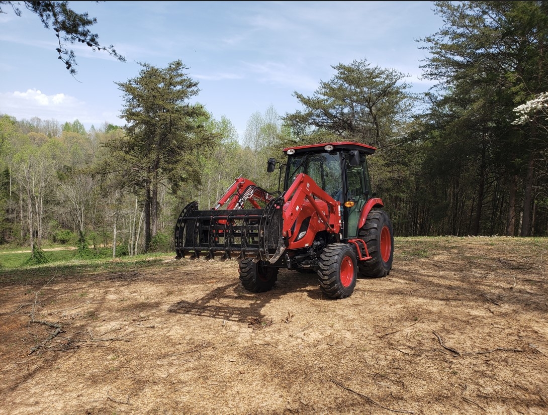

No!! I have a JD 3025E. I just spent 2 weeks discing, tilling, packing, planting grass seed and pulling a drag harrow around my 5 acre yard. i had to borrow a bigger tractor to pull the 16’ disc, then used my tractor on the smaller implements. Others have suggested this. If you have all the time in the world and don’t mind being beat to death a smaller tractor is ok.
Attached are some pics of the yard right before seeding.
I wish a thousand times mine was a minimum of 50hp.
You know the advantages of more HP, please don’t go small.
Of course you had to borrow a larger tractor to pull a 16 foot disc; the proper size for a 3025E would be between 6 and 8 feet.

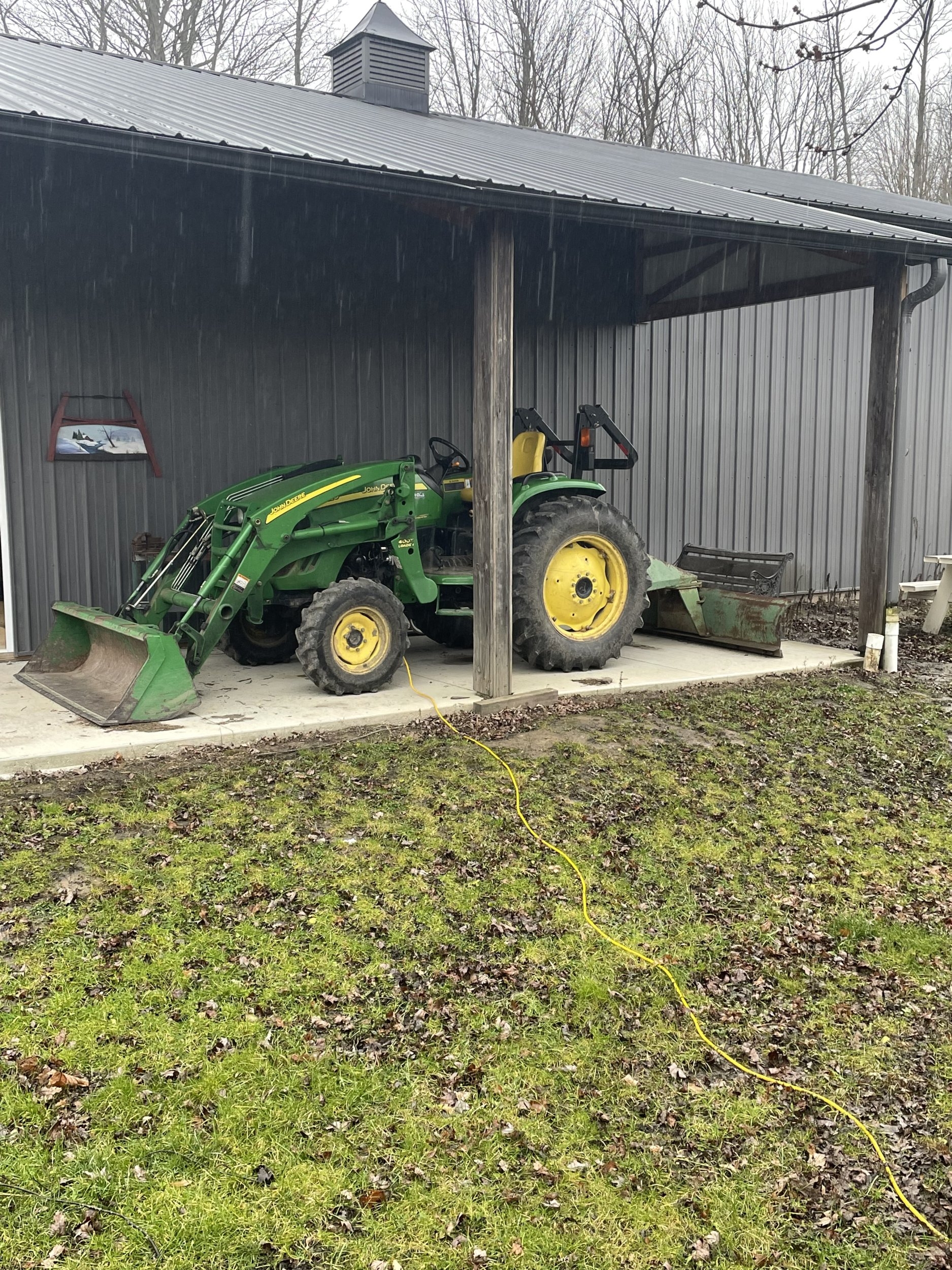

Throwing my 2 cents in (somewhat late): The difference between a BX and B 23 horse is pretty big, I have the B-2301, my neighbor has a BX; big difference between the two. His my be a bit nimbler, mine will pull harder. With loaded tires, the B 2601 handles the loader and anything else I've asked it to do...and it still runs a mid-mount mower.

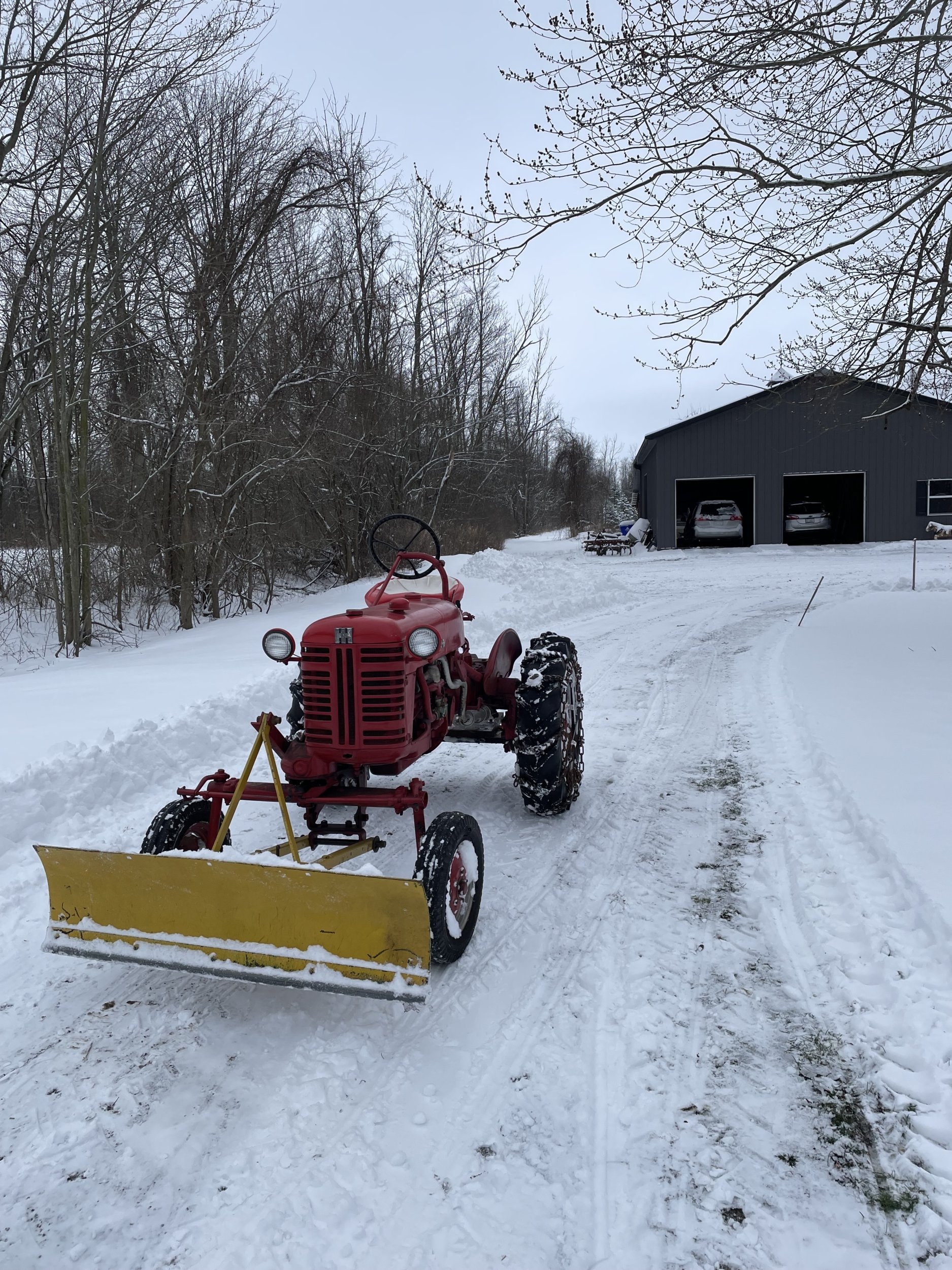

I’ve got 34 acres to maintain, along with a house, a barn and a couple of driveways. I use (5) tractors for that, including (2) 15 hp lawn tractors (one gear one hydro) strictly for mowing about 1 acre of grass around the buildings (remainder of property is about 1/3 wooded and 2/3 open fields).
My other tractors include a 10 hp Farmall Cub, 28 hp Ford 8n, and a 43 hp John Deere 4120 (I’m not “color blind” but I am Country blind and that’s the American “big 3”).
Since I really enjoy my “tractor time”, I’ll usually pick the smallest tractor for the job, that my available time allows. For example, I can clear a foot of snow from our (2) driveways in 15 minutes with the 43 hp JD, or take 45 minutes doing it with the Cub.

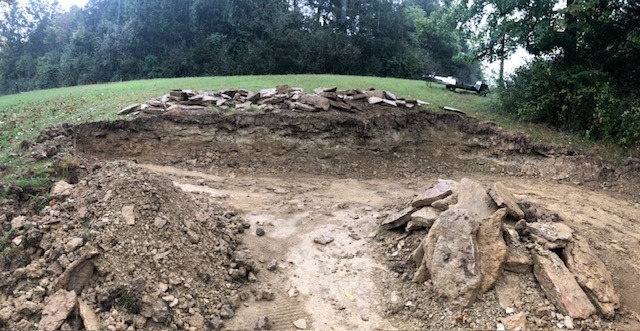

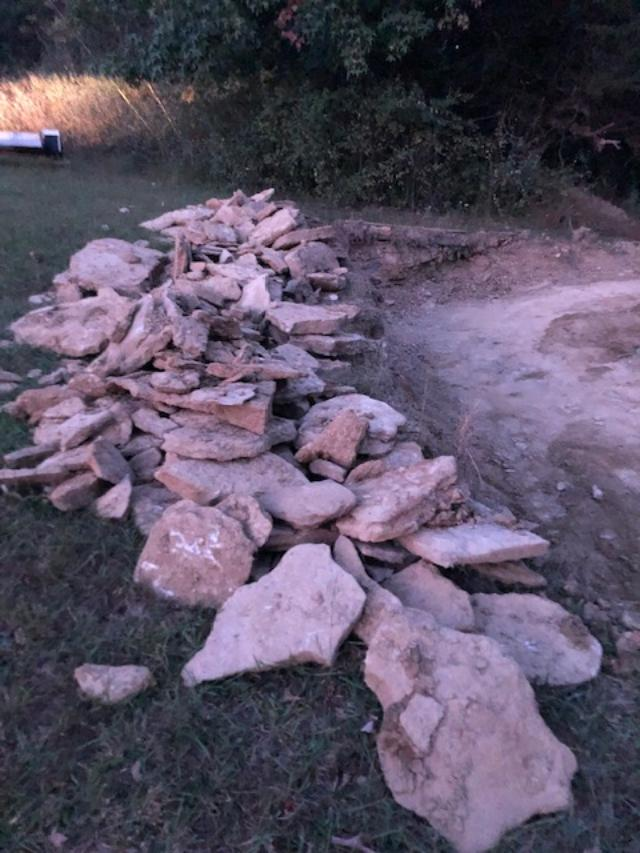

"Lawnmower and nothing else" is a little harsh, lol. I cut a flat spot for a 16x24 shed out of a hillside made of clay & rock with a Kubota BX1880. It wasn't fast, but totally up to the task.
That said, if I had several acres to maintain I'd probably move to a B or an L for speed & capacity purposes. But the little BX works well for my billy goat mowing needs and projects.
