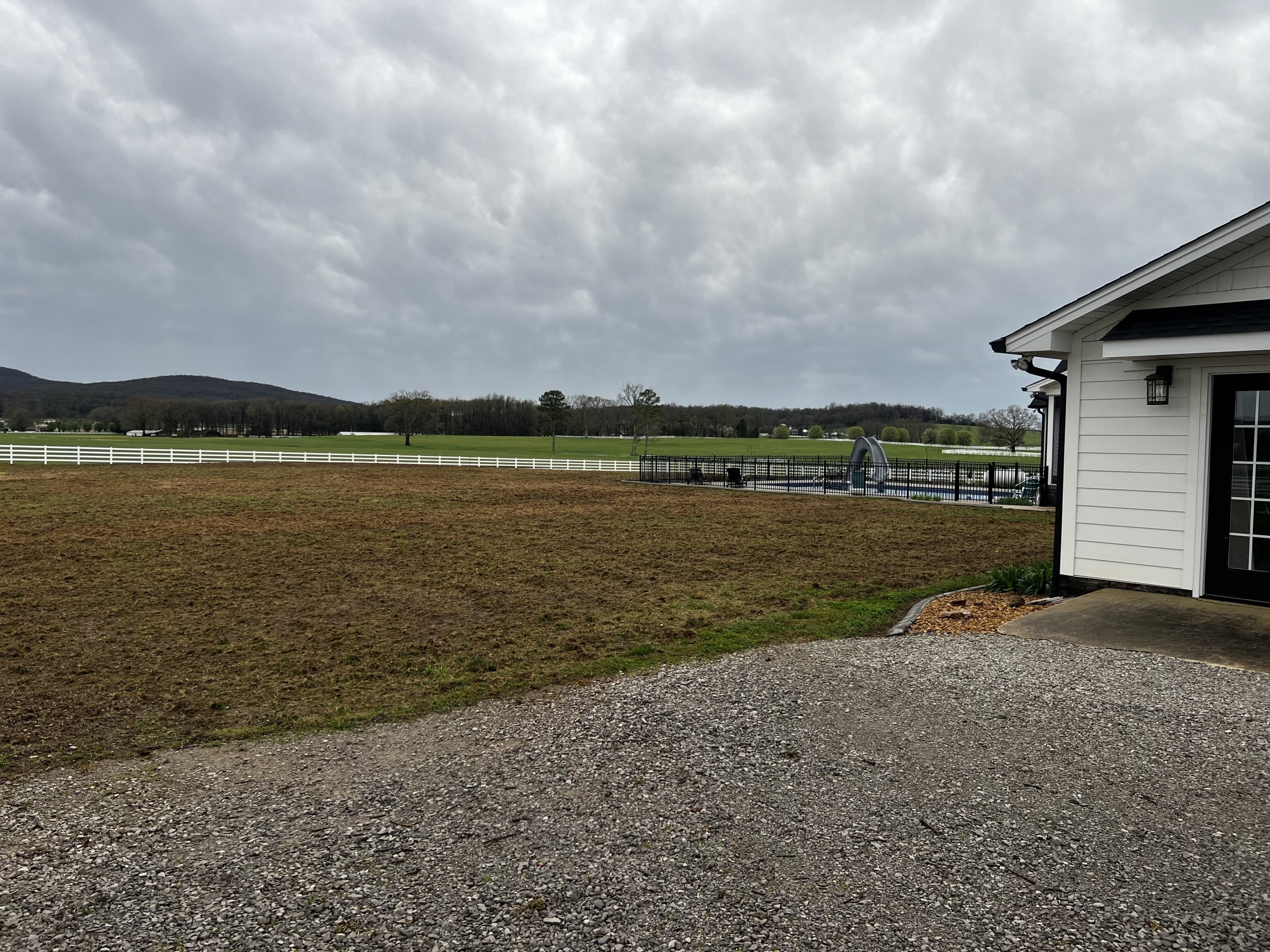

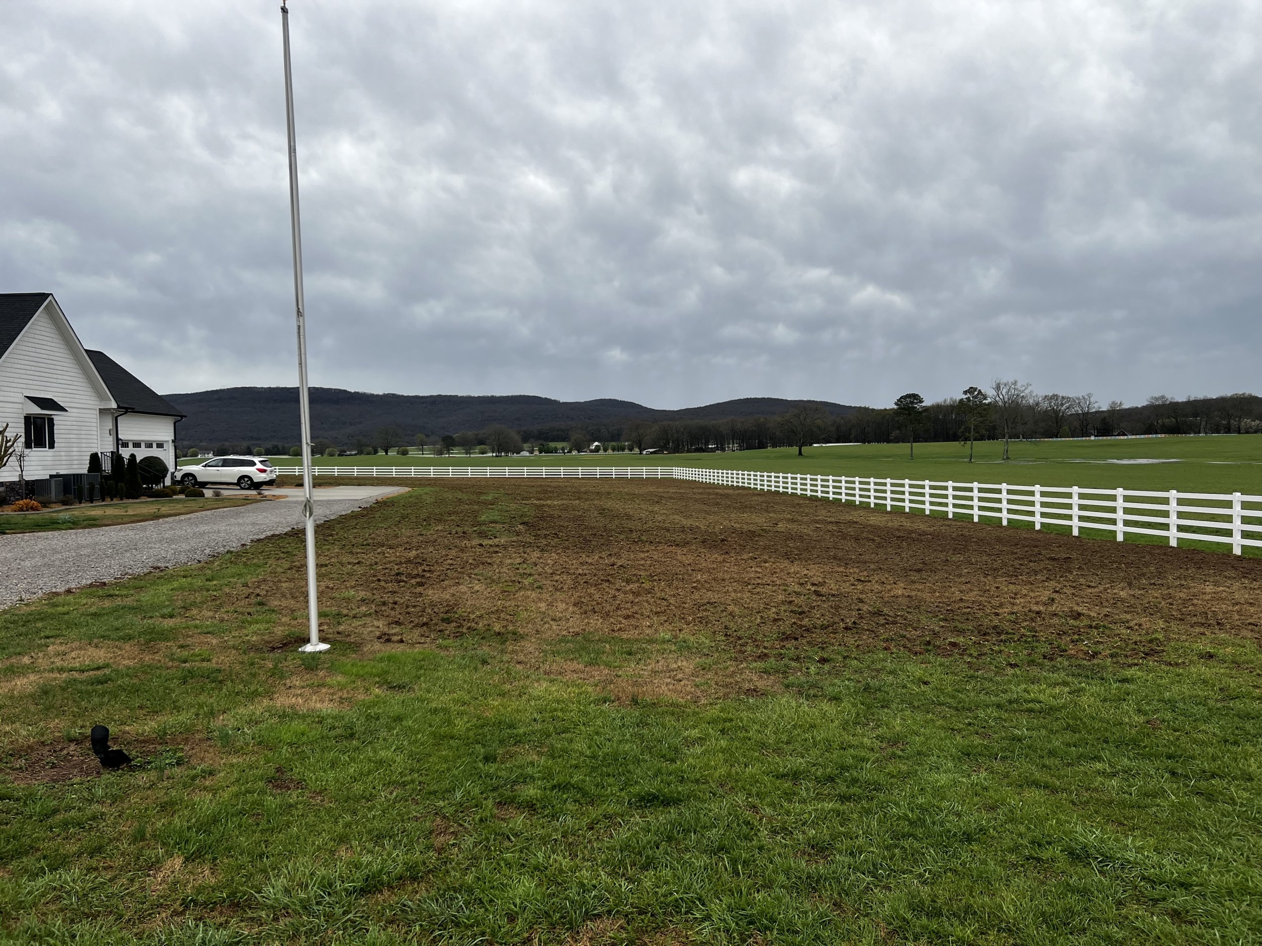

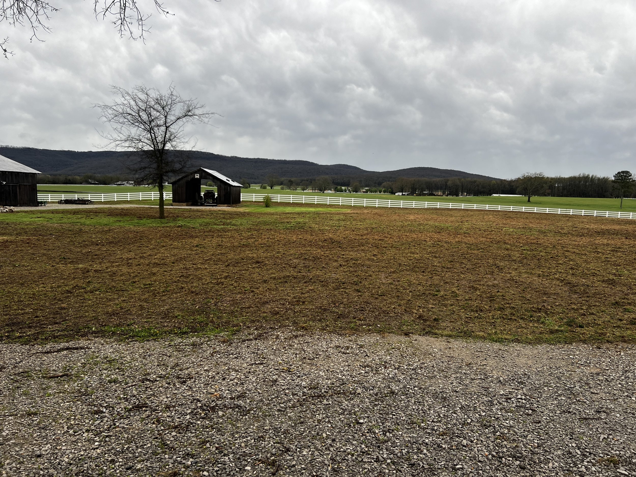

   / Is a subcompact under 25hp enough power? #78
Is a subcompact under 25hp engine enough power to maintain a under 15 acre property where the tasks are mowing w/ mid mower, finish mower, brush hogging, stump grinding, hole digging, box blade and typical loader work?
I have owned a 35hp and 50hp so I'm a little uneasy getting an under 24hp.
No!! I have a JD 3025E. I just spent 2 weeks discing, tilling, packing, planting grass seed and pulling a drag harrow around my 5 acre yard. i had to borrow a bigger tractor to pull the 16’ disc, then used my tractor on the smaller implements. Others have suggested this. If you have all the time in the world and don’t mind being beat to death a smaller tractor is ok.
Attached are some pics of the yard right before seeding.
I wish a thousand times mine was a minimum of 50hp.
You know the advantages of more HP, please don’t go small.
