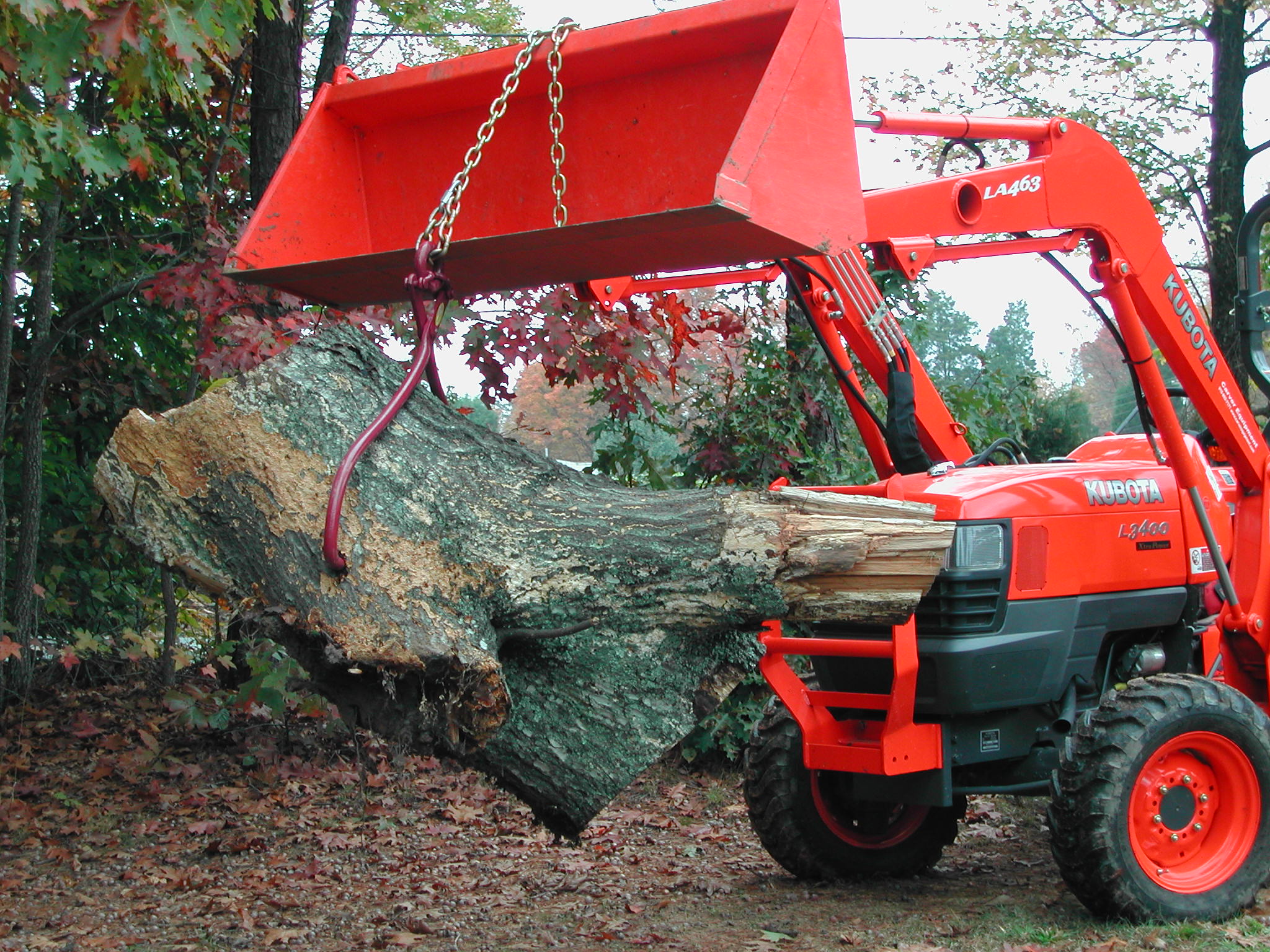

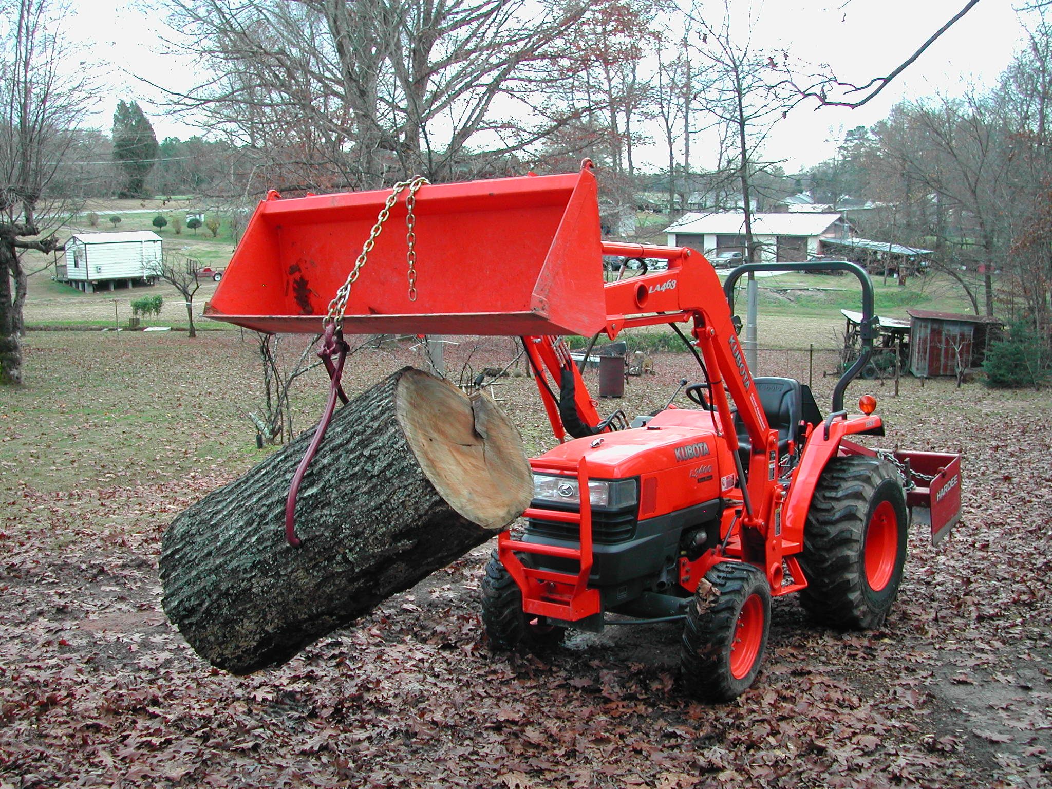

Hear, Hear!:)I,m with you on this one, My L3400 will pull plows, disks, tillers, bushhog, and the loader has lifted the (filled) rear tires off the ground many times with box blade on the 3 PT. I love it!:D

Hear, Hear!I,m with you on this one, My L3400 will pull plows, disks, tillers, bushhog, and the loader has lifted the (filled) rear tires off the ground many times with box blade on the 3 PT. I love it!
Yep, there are tractors out there in this size class with better specs, (Kioti, BobCat, and Mahindra) on the front end and 3pt too., but I sure dont think of my front end loader as anemic. It will lift a lot.. In my opinion, it will lift all that the weight that the ballasted tractor needs to lift, plus a little! I think some of them are set too low at the factory, I have seen threads here that guys have found that, that may explain some of the dissatisfaction that the one gentlemen expressed. Also I dont understand what the one gentleman posted about the Hydro-stat, going down a hill, I have a hill I go down that is so Da** steep you can not walk down it comfortably without worrying about slipping and falling, and you can be going down it in the L3400 a pretty good clip, and if you jerk your foot of the hydro quickly it will throw you "through the windshield" (if it had one) stopping.:laughing: It will then just creep down the hill very slowly, I dont understand the needing to ride the brake going down hill's thing.. I think something was wrong with that Hydro.. cause mine sure dont work that way. The hydro is the most sure footed thing on a hill, no worrying about swapping gears and going thru neutral or the tractor "getting away" from you. Much easier for a novice to operate and safer too in my humble opinion.. just my biased 2 cents worth. I like mine a lot.
