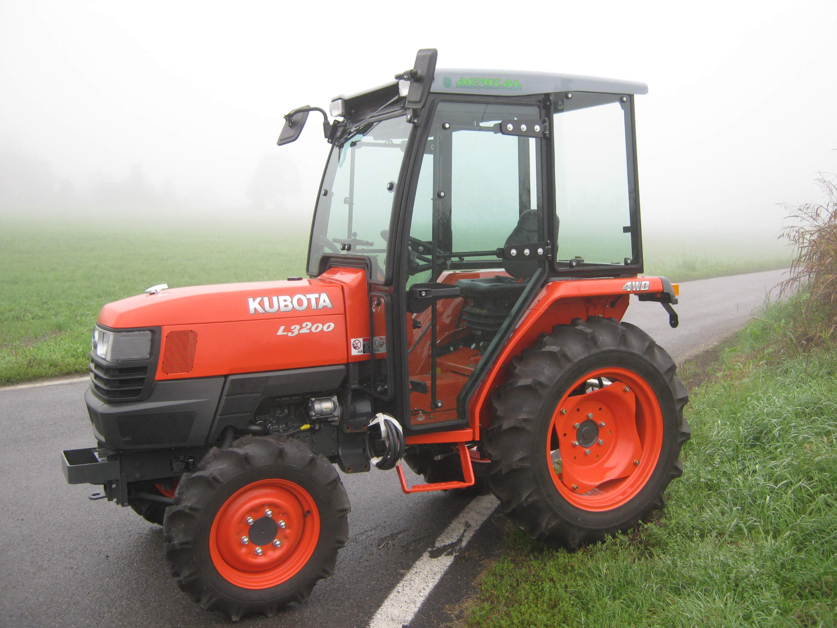

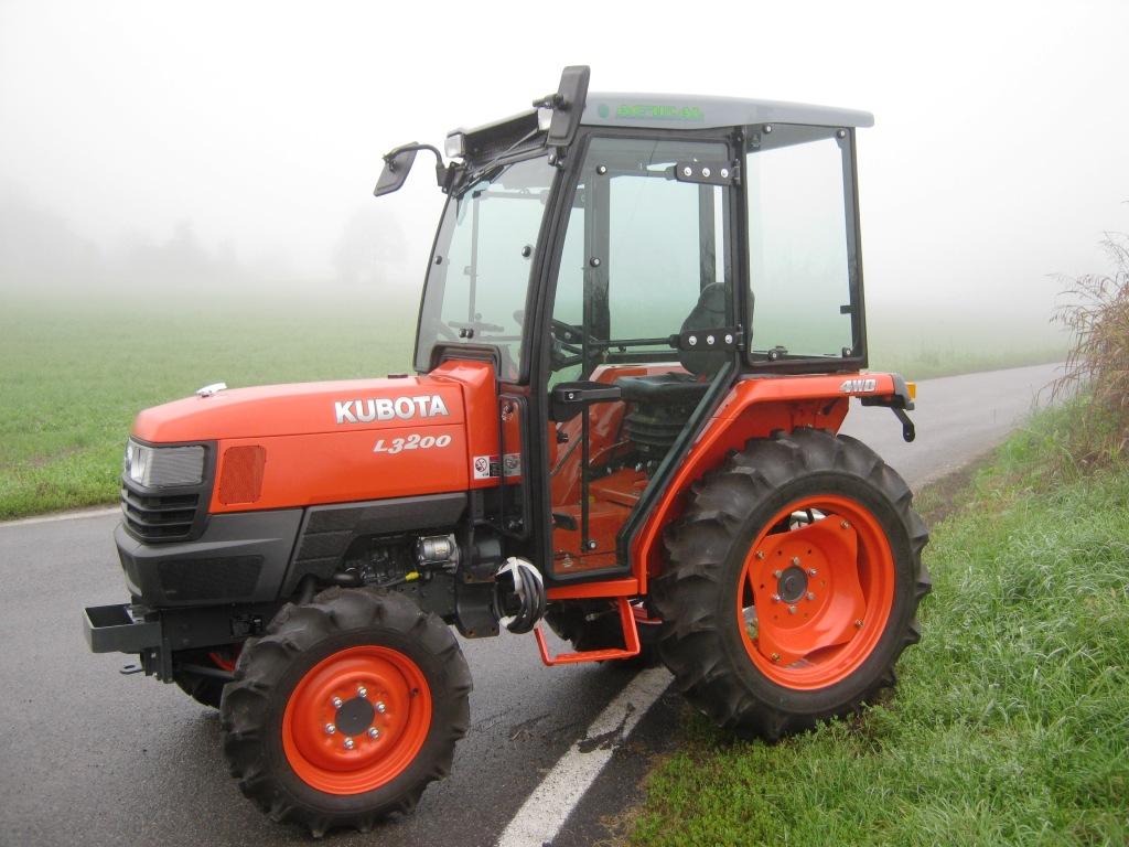

cab weight 220 kg only, with ROPS (anti roll over) certification
tractor cabs, rigid enclosures and sunshades for kubota
