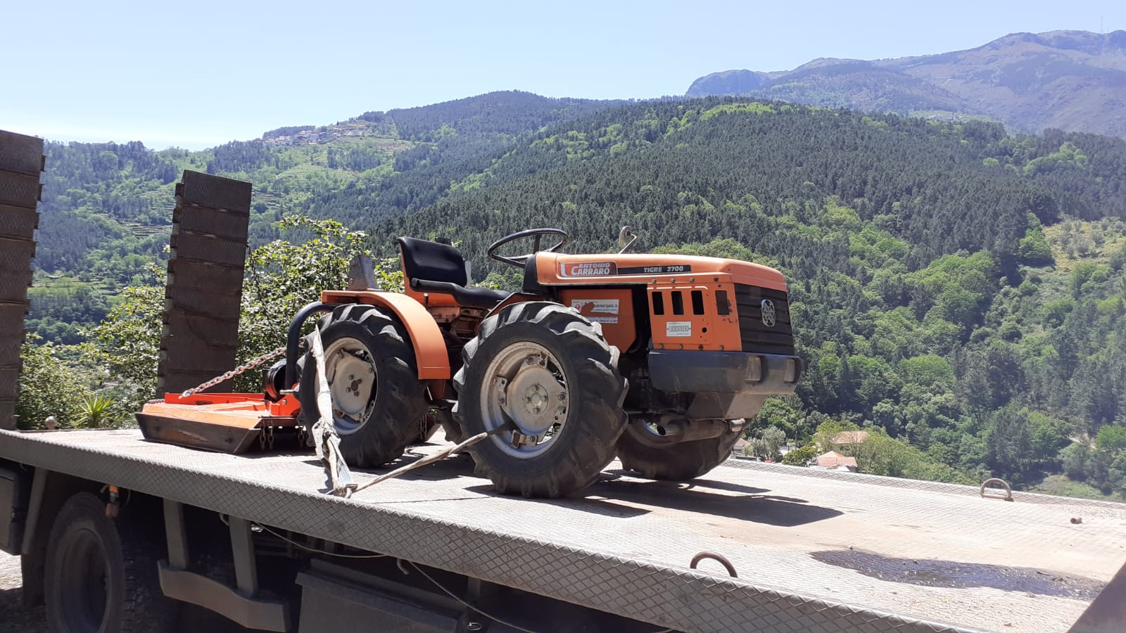

Well, here it is!! It's actually 16.5Kw on the documents, just over 22, not 26 or 27 or 28!! I still wonder where from and why people pull these inflated figures, up to 25% more for compacts I've found. Regardless it's still a good improvement for me % wise.

5000 euros delivered with a 120cm rotary cutter. The seller turned out to be very nice, and didn't get upset about getting lost trying to find my place 😆
I'm in the process of selling mine for 4250, if I discount the cutter which is in vgc, I almost break even.
Thanks for the advice.
/ Is a 3hp upgrade worth it? #44
Congrats on your new "toy", errr, I mean tractor. :)
Great picture too with the mountains in the back.
I have the same mower too. Also 1.2m.
Have you tried to figure out the maker and model of the engine and confirm the HP? Somehow I find 22hp a bit low on this type of tractor.
Ahah thanks, toy is not far fetched either :D
I haven't, but I'll have a look at it to double check, I thought the papers would be accurate.
