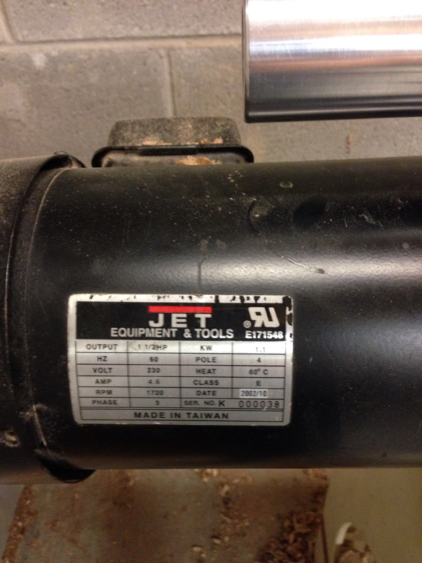

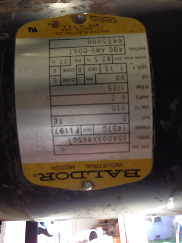

I have a Baldor motor that is rated 2hp and only pulls 6.2 amps @ 230 volts. I have another motor that is rated 1.5 hp and pulls 4.2 amps @ 230 volts. Both motors are 3 phase. Maybe 3 phase is more efficient. image-3071646581.jpg image-3446488124.jpg

I have a Baldor motor that is rated 2hp and only pulls 6.2 amps @ 230 volts. I have another motor that is rated 1.5 hp and pulls 4.2 amps @ 230 volts. Both motors are 3 phase. Maybe 3 phase is more efficient. View attachment 449922 View attachment 449923
Three phase is carrying load current on three wires instead of two so allow a factor of the square root of three .
Three phase motors as a general rule are more efficient than a single phase motor.
