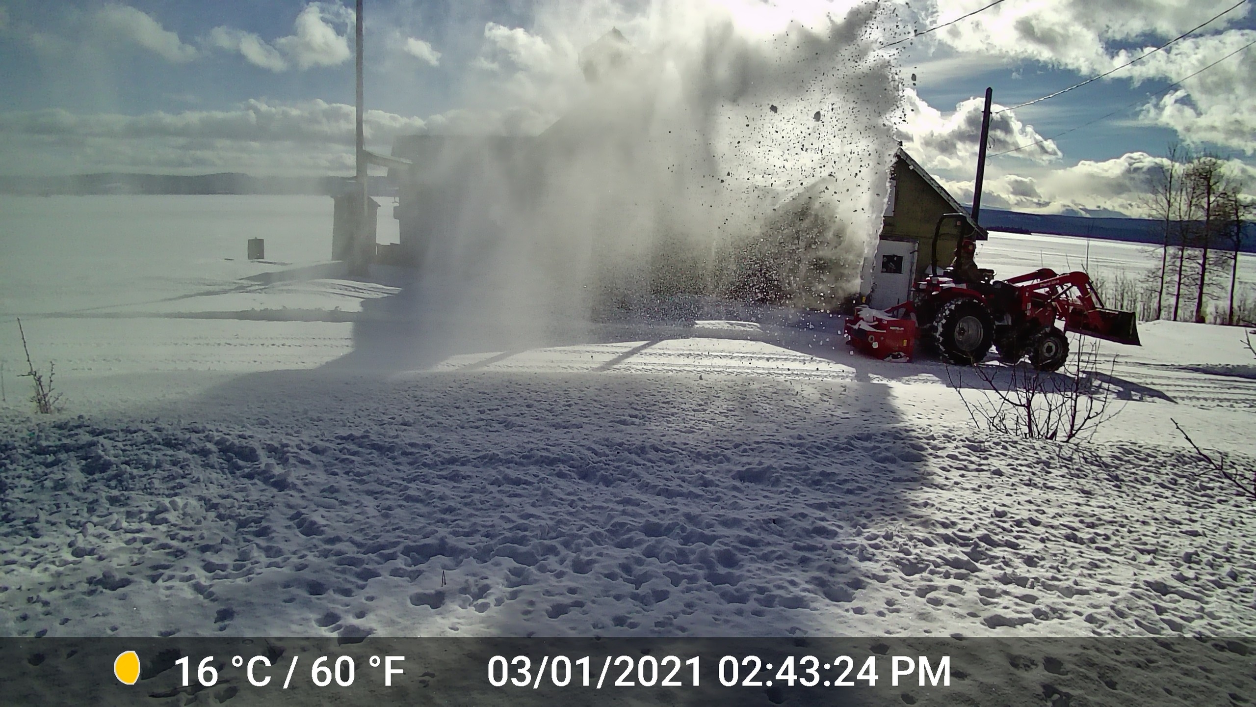

This my Meteor SB68PT

Mine has been flawless except for when I run 2x4s or rocks through it. How do you like yours?

I absolutely love it! Between my dirt driveway and my elderly neighbor’s (I do his as he is on chemo and having a tough time) I clear about half a mile. Having to look back over my shoulder would have been a literal pain in the neck. The hydraulic chute is a must have as I need to direct the snow away from various obstacles. I also use it to create an awesome sled run down a slope for the neighborhood kids; the chute is handy for creating banked curves. It’s been used hard for 15 years so the bearings were due for some TLC.
The one modification I made was installing mud flaps over the auger. Years ago a softball sized rock hidden under the snow was launched through the back window of my JD. The flaps prevent a repeat.
