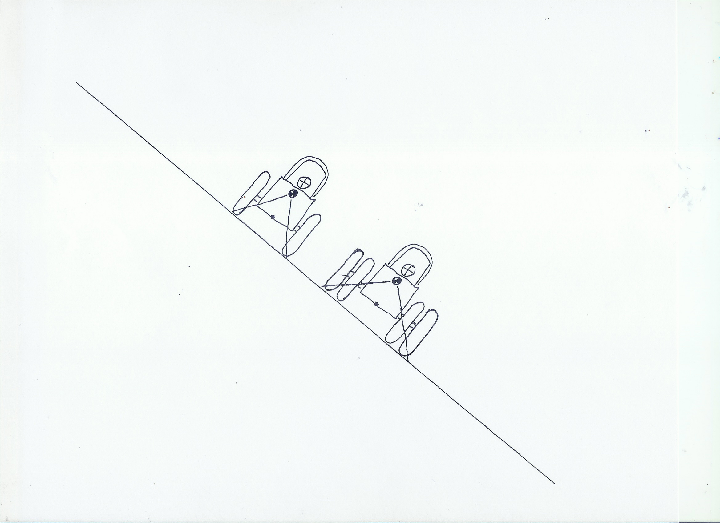

The front doesn't affect the stability of the tractor. To prove this, make a ramp and drive one side of the front axle up the ramp. There will be no tip transfered to the tractor. Now back one side of the rear axle onto the ramp. You will begin tipping very quickly as the front provides no support to prevent it due to the pivoting axle.
Rollover of a tractor on a side slope is determined by the height of the center of gravity (CG) vs the width of the wheel base. As a tractor is tipped sideways, a line between the CG and the outside of the wheel base represents when the tractor will roll. When that line exceeds verticle as the tractor is tipped, it will roll. Adding duels dramatically changes this angle.
I have a picture to post representing this, but just realized that my scanner is on my old computer which is dead.:eek: I will add the pic shortly when I have installed the scanner on this computer.
Drawing uploaded.
Yes what you are saying is true, in any case when widening the wheel span,
I'm not arguing this fact, in fact I'm not arguing at all :D are you saying that my idea will not work? You may think to yourself .. what is this idiot thinking. should I totally scrap the idea, and go for duel wheels/tires

Sorry, no pix. Just the drawing I made.
Not saying your idea won't work, I just think it's more work than neccessary.
Duels are easy to install and remove (at least mine are), and the difference in side stability is unbelievable.
