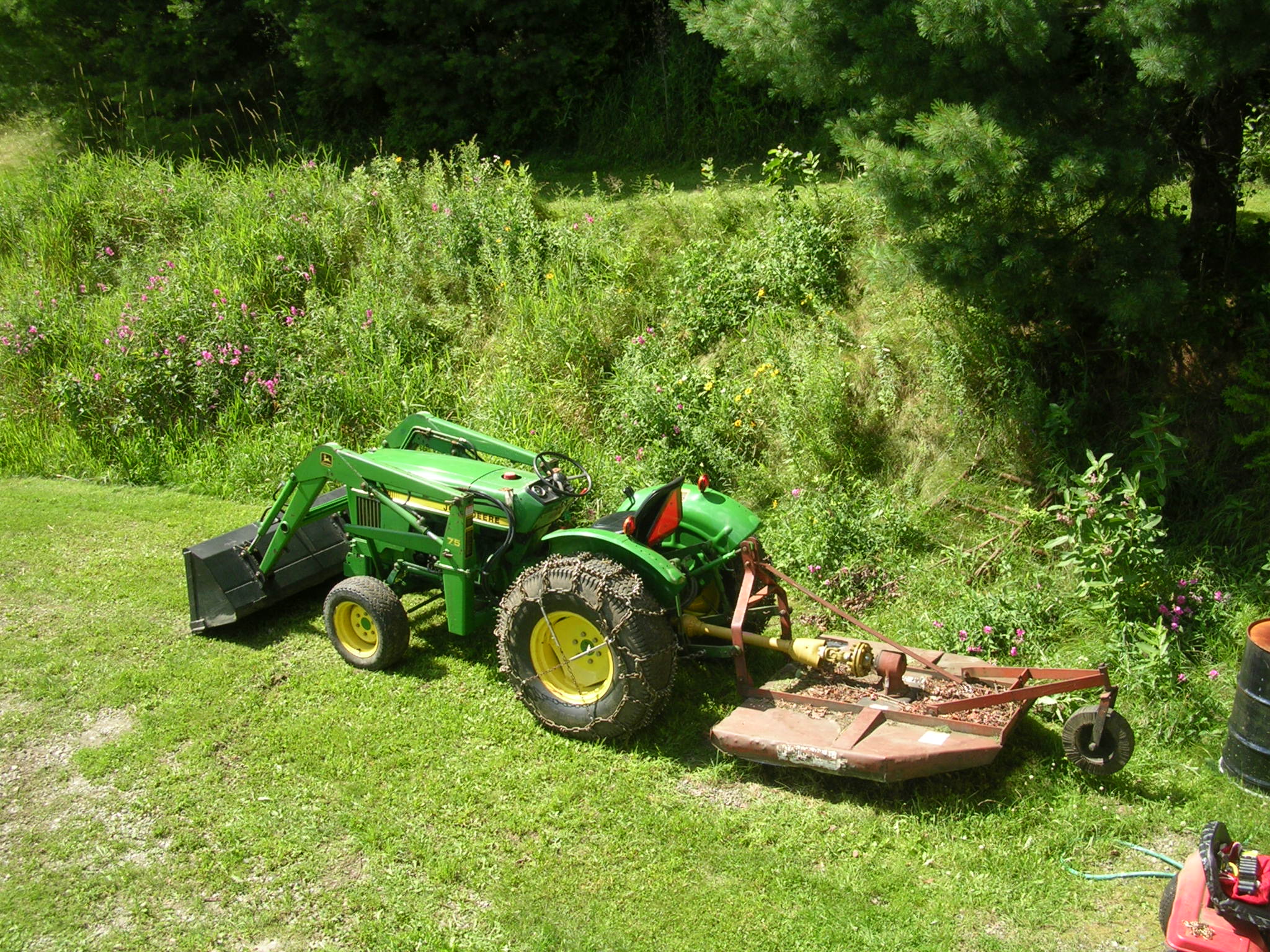

Mine is old and beat, but does the job. One of these days i am going to have to
turn it over and take a looksy.

Yep the mower I'm looking at looks like Kebo's. However very rusty. Looks like it's been stored outside. It will be sold at auction and I haven't been able to look it over in the flesh yet. Based on everyones replies here it is seems it is generally a good mower but there are things to watch out for. That opens up a couple more questions. Do you think a 26 HP tractor will run it? What would a reasonable price range to pay be? Thanks! Bill
