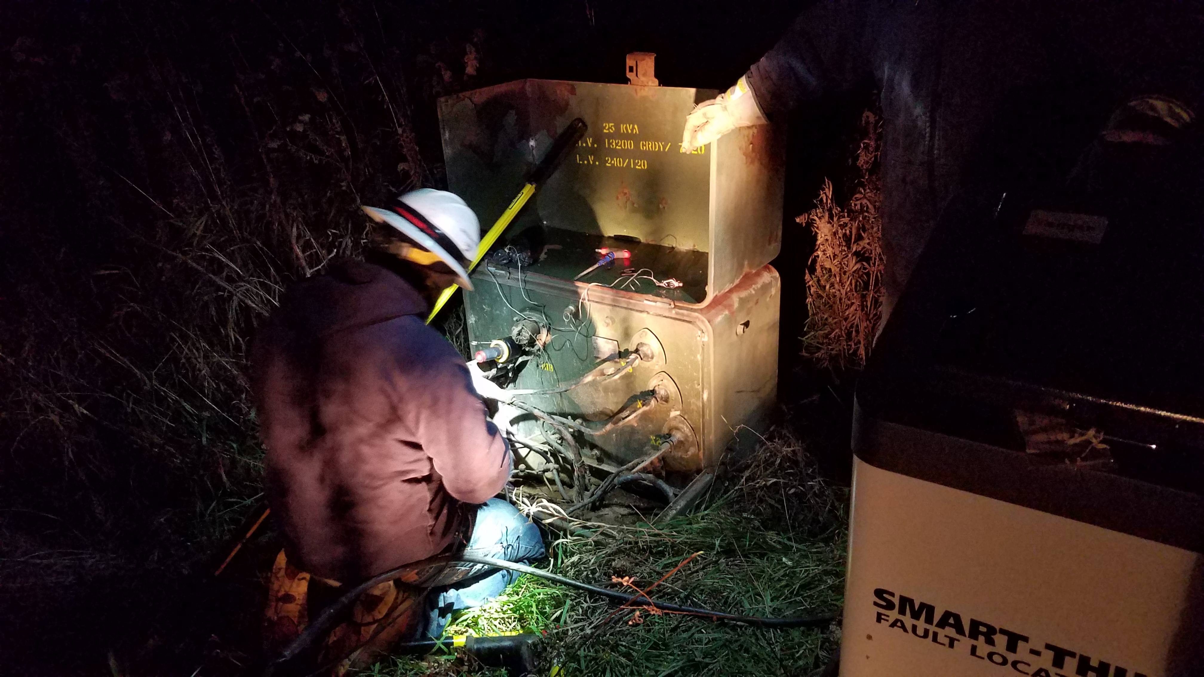

The reason I asked is because a few months ago, I had a 7600v underground line going from a pole to my on the ground transformer burn out and shorted to earth. If it had shorted to a neutral, my house could have been burned. The talk of neutral disconnect is new to this semi-annual discussion.
BTW; the DTE guys showed up here at 10 pm. used a 'thumper' to locate the short, dug it up spliced in a patch and restored power by 1:00 a.m. ! 20181107_214620.jpg
