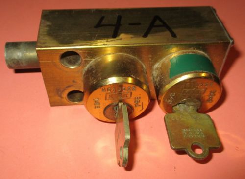

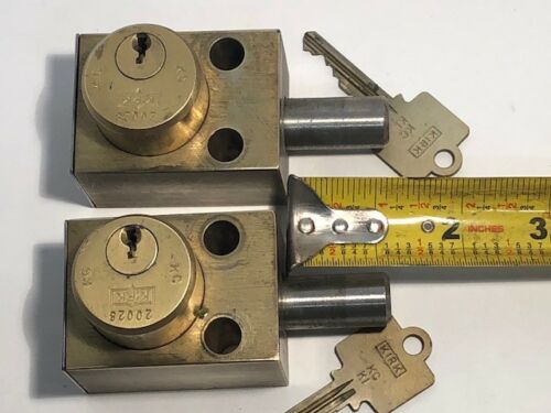

I have a 400 amp service to the house. My shop 200 ft from the house is fed from one of the 200 amp breaker boxes at the house. Interlock wouldn't work in my application. I have to turn off both breakers and some of the other 220 breakers.
The power company here assumes people will have generators connected, so they work an outage with that in mind
Sounds like a trapped key interlock would work for you, you would need a double key one for the generator and a pair of single key ones for the 200 amp breaker boxes in the house.
Double key interlock for generator:
I.T.E. Imperial Corp. Kirk Interlock F2 45-62915, Yale Key, Lock, Double | eBay
attachment.php
Single key interlocks for house panels:
KIRK KEY INTERLOCK QTY 2 (228) "NEW" | eBay
attachment.php
These particular ones are not keyed alike, so they would not work for you, but that is the style that you would need.

Look at a trapped key interlock. Something like this: KIRK KEY INTERLOCK QTY 2 (228) "NEW" | eBay
587926d1547998215-interlock-vs-throwing-main-circuit-s-l500-jpg
One goes on the main breaker, the other goes on your generator breaker. One key gets locked up as a spare, the other is locked into one lock (that is installed so that it keeps the main breaker off when the key is removed). The other lock is installed so that it keeps the generator breaker off when the key is removed.
To turn on the generator, you turn off the main breaker, lock the interlock to keep it off, remove the key, unlock the generator interlock with that key and turn on the generator breaker.
