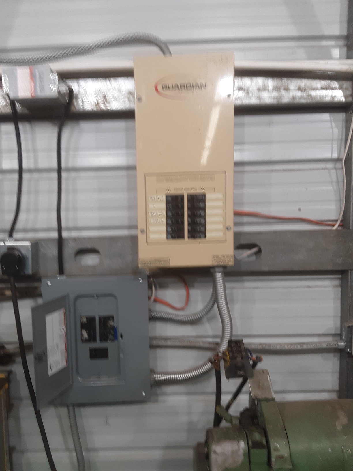

I'm using an interlock as well. For various reasons (one being that I'm electrically illiterate, the other that I'm always wanting to know and learn) I delved into everything related to wiring up a generator in such a fashion. My electrician, who I was working with to wire my then new garage, looked at me in a puzzled fashion when I mentioned how the generator needed to be wired. After I explained it to him he nodded his head and said "yeah." Anyway... Generators wired such as this (in to the panel) are power "sources" and one doesn't bond the neutral to the generator's frame (or combing with the ground wire) as often is the case with a generator that is a "standalone." The neutral needs to "float"- it gets connected to the neutral in the panel.
I see the requisite wires in the OP's pics, but no idea how the generator is plumbed/wired.
I don't want to say how many plugs I went through before getting the right one! Had an issue with a correct one and broke down and got a Hubbell: after stripping a connector on the first non-Hubbell I found that the Hubbells are FAR superior and that I'd been best off shelling out more in the first place!
Yeh, I mentioned before I got a bonded neutral on the generator, I gotta convert to float. Your panel is already bonded (unless you're looking to backfeed a subpanel, those usually aren't), so a bonded neutral on the generator backfeeding it ain't gonna work out.
Diesel, if you're gonna use that generator for other stuff, just make sure to build or buy a bonded neutral plug. Basically it's just a plug (w/o a cord) with the neutral terminal connected to the ground terminal in it...so you just plug that into whatever outlet in the generator and now it's bonded neutral again and safe to use. When you're gonna use it to backfeed your panel, you just unplug that plug first.
Like this one: https://www.amazon.com/dp/B07F4R7BD...&colid=TJYU61LC7LU&psc=1&ref_=lv_ov_lig_dp_it

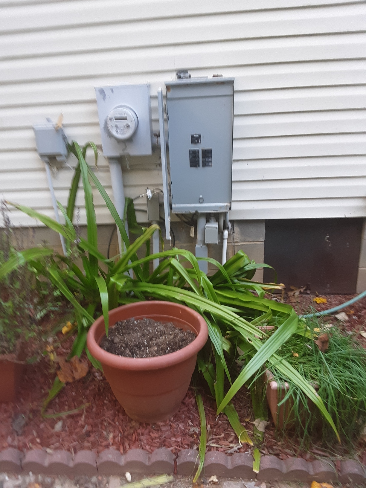

We too have our service entrance panel (with meter) about 350' from our home. Our service entrance panel has a built in generator disconnect that keeps our generator near that panel. Walking up and connecting and starting up the generator is one thing, but wondering when the power has been restored is difficult when we live in a remote area where we cannot easily see if any neighbors are back on. Wiring some easily noticeable lamp of some sort to attach on the panel on the service side of the main disconnect to be able to "see" when service is restored would be awesome, but would be challenging to install without pulling the meter which would also require breaking a seal. Some sort of inductive pickup to "connect" to that would be pretty cool, but I cannot find anything like that.

I went the Generac route due to my ignorance about availability of the Generlink meter plug in my area . So Generac did the pony panel seen with 8 circuits of my choice and switchover with lights so I will know when power comes back on. With 10,000 watt Generac Gas Generator ( elec start) It took two electricians 8hrs to complete, included drilling thru 12 inches of basement concrete wall . So far only one power outage to try it out for real, and that was only 30 minutes :) . But still having it is like an insurance policy and peace of mind it gives to know that a Canadian Winter power outage is feasible to get thru now. 20220223_122230.jpg20220223_122256.jpg
