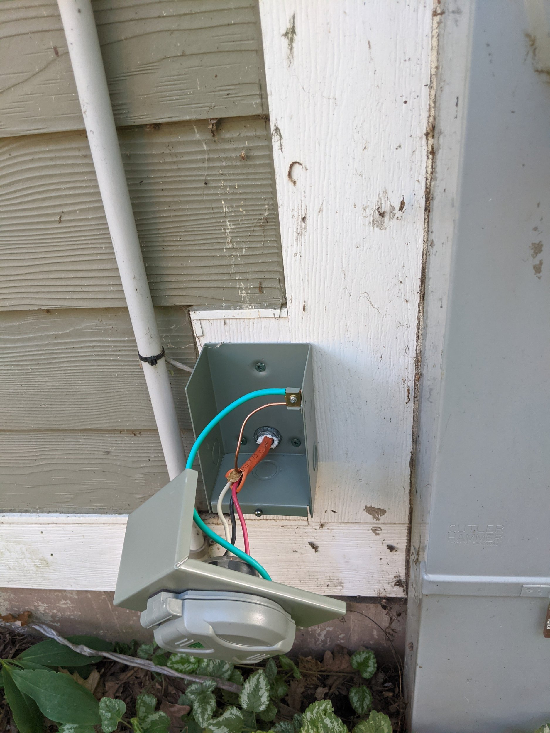

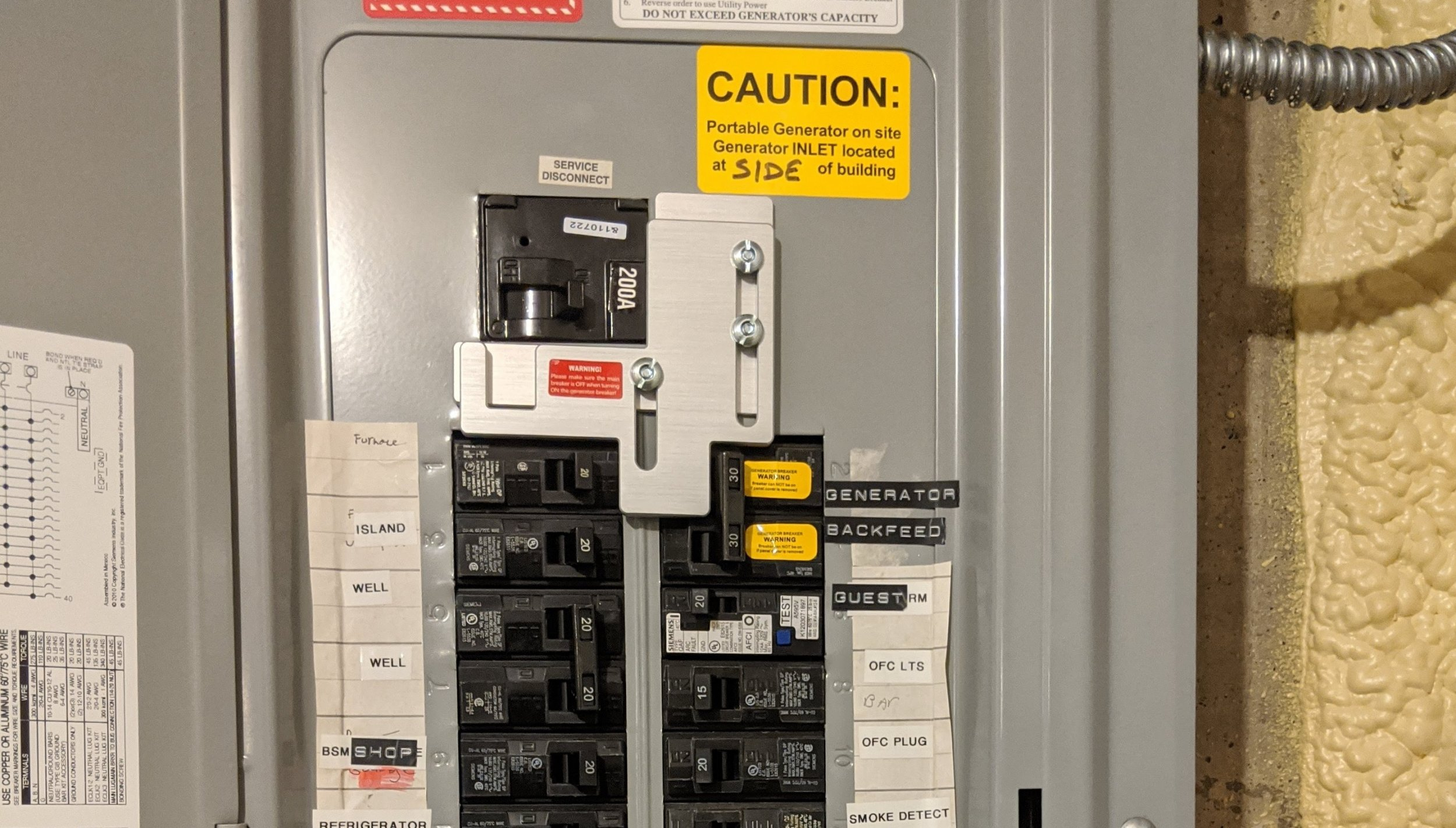

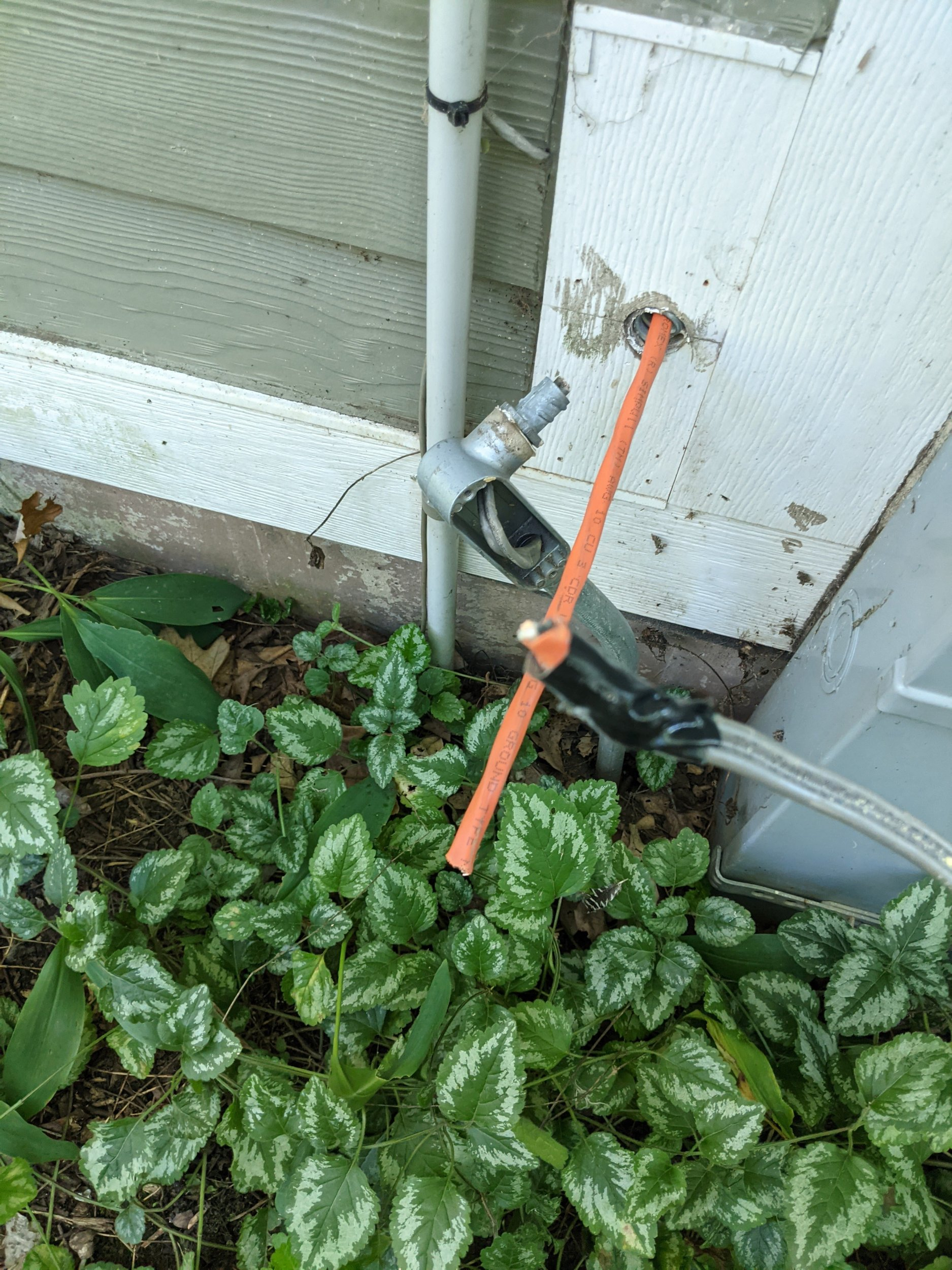

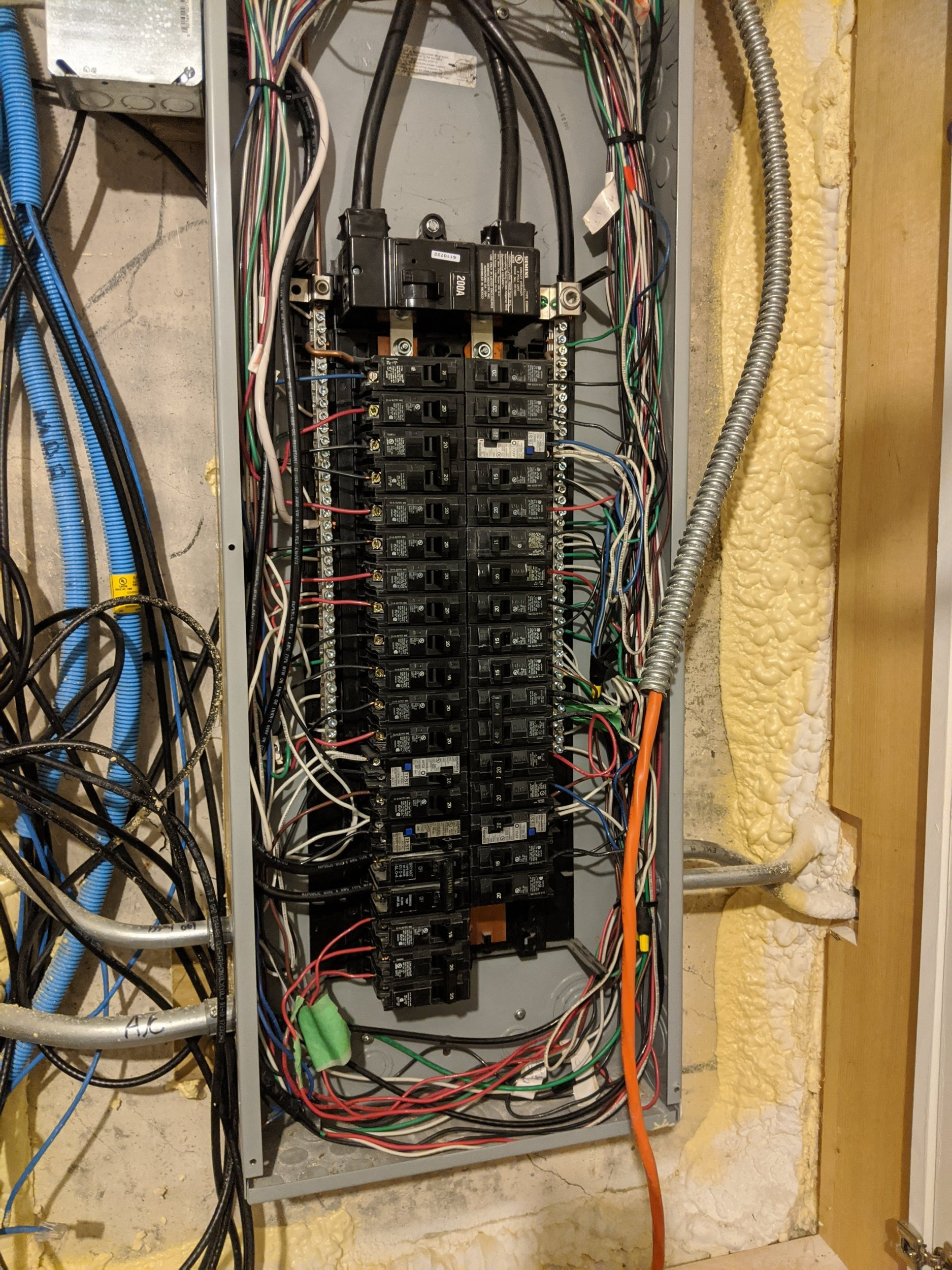

I guess you are showing the lockout for generator/line feed on your panel. That system is very simple and has been marketed for awhile. Simple enough to DIY, providing you know what you are doing electrically!
/ interlock switch for generator backfeeding panel
Oh yeh, it was super easy. The only thing that stumped me was what to do with the zip ties in the kit, instructions weren't all that clear. I had to google that, turns out it's code, you gotta anchor your generator breaker to the panel and put a warning sticker on there. So zip tying it to the neighboring breakers (1&3 position) counts as that.
I still gotta do a quick thing to my generator, I got a bonded neutral on there, so gotta take care of that. And also make a bonded-neutral plug for when I wanna use the generator for other stuff.
/ interlock switch for generator backfeeding panel #4
Looks the same as the one I installed on my breaker box. Easy to install and pretty foolproof. I've used it a couple of times so far.
Actually, the only problem I had was with the inlet box. Ordered on Amazon per reviews, ok seems a winner. So Install that thing, go to plug in my generator cord, and it won't twist lock. I finally figured out that there's a lip in there that decreases the ID at the bottom, just enough that a standard L14-30 plug won't fully seat to twist lock. Evidently only a molded plug (which they sell) will fit in there. So, I raised a stink about it, got them to send me a free plug...and meanwhile, Amazon also refunded me for the inlet box.
/ interlock switch for generator backfeeding panel #6
Oh, that's sneaky. I got one from home depot, it fits a normal twist lock plug.
/ interlock switch for generator backfeeding panel #7
Nice job! I want to do that but can't find a lockout to fit my vertical main breaker. And I don't want to go through changing out the whole box and breakers. How do you know when service has been restored? I was planning on adding an indicator light on the service feed side. I have an of old neon bulb I could wire in. (I have a cutoff at my service pole before it goes underground.)
One should be out there if you got a normal name-brand panel. Try here to find one that fits yours: Interlock Kit & Accessories For Your Home | Generator Interlock Kit
To check if your power is restored, flip off all your breakers, flip off the generator breaker. Then turn on your main, and flip on some breaker to check if the lights are on.

/ interlock switch for generator backfeeding panel #12
Sounds like the same one I ordered Tuesday supposed to be her tomorrow. I saw the comments about it not locking, since I needed a cord I ordered one from the same seller/brand on the assumption it would fit. If someone already had a cord, could the lip be removed from the bottom of the receptacle I wonder.
One of the nicer and easy to install is this unit from Reliance;
Nice idea but $100 in Canada
Same here but I was thinking a panel mount LED
#13
This is the one I got: https://www.amazon.com/gp/product/B09GDVHTNC/ref=ppx_yo_dt_b_asin_title_o06_s00?ie=UTF8&th=1
On their ad there, the 5th pic from the left, you could see the lip inside. There's no apparent way to remove that lip, but I suppose where there's a will there's a way. Is it worth the hassle? I'd say hell na! Or, you could just live with their cord...but if something happens to it, you're SOL.
Here's the molded plug on their cord (green one) compared to my cord with the plugs which you could replace. Theirs is around 1/8" less diameter.
Also keep in mind the knockout on the box is not a knockout, you're gonna have to drill it out with a step drill. Not a deal breaker, but yet another hassle.
Like I said, they sent me one of their 10ft cords for free coz I raised a stink. It's too short for my purposes, but at least I could plug my cord into their cord, make it all work. And Amazon refunded me for the box, so whatever I'll live with it. But if I knew all this beforehand, I wouldn't have ordered this stupid thing. I don't wanna give unrequested advice, but if I was you I'd cancel that order and get something else.
/ interlock switch for generator backfeeding panel #14
Different name but exactly the same box.
Already shipped, supposed to arrive tomorrow. Why would they make the plug a non standard size and cause a bunch of s**t for no appreciable reason. Reason only they'd understand I guess. I'll let you know how it turns out, I have no doubt it'll be the same as yours.
#15
I suspect they first made a bunch of these boxes, realized a standard plug won't fit it, so made a bunch of cords with molded plugs to fit it.
/ interlock switch for generator backfeeding panel #16
That's why I want an indicator. I can just look at it before going through all the switching.
I can tell the power is restored when the LCD display comes back on at the meter.
My meter is about 150' from the house. My breaker panel is inside the house--Near the back door. I like being able to just look at a glowing light to see if the I have service restored. Having two glowing bulbs would let me know I have both legs for 240v. I'm not going to trek out to the service pole to look at my meter. What if it's pouring down rain or dark? (We occasionally do get rain in South Texas.) :)
/ interlock switch for generator backfeeding panel #17
How will you connect your indicator into live wires ahead of your main disconnect which gets shut off when the generator runs? And how will you disconnect it or fuse it if it needs to turn off?
/ interlock switch for generator backfeeding panel #18
I can connect them to the hot side of my main breaker. If I have service, they light up. Don't really need to turn them off. Neon can stay on all the time. It lets me know at a glance both legs are up or not. Might have to replace them every 10-15 years but so what. I once had a bad breaker at my pole and was getting only 120v to the house. Some things worked and some didn't. That was confusing for a moment.
/ interlock switch for generator backfeeding panel #19
I'm using an interlock as well. For various reasons (one being that I'm electrically illiterate, the other that I'm always wanting to know and learn) I delved into everything related to wiring up a generator in such a fashion. My electrician, who I was working with to wire my then new garage, looked at me in a puzzled fashion when I mentioned how the generator needed to be wired. After I explained it to him he nodded his head and said "yeah." Anyway... Generators wired such as this (in to the panel) are power "sources" and one doesn't bond the neutral to the generator's frame (or combing with the ground wire) as often is the case with a generator that is a "standalone." The neutral needs to "float"- it gets connected to the neutral in the panel.
I see the requisite wires in the OP's pics, but no idea how the generator is plumbed/wired.
I don't want to say how many plugs I went through before getting the right one! Had an issue with a correct one and broke down and got a Hubbell: after stripping a connector on the first non-Hubbell I found that the Hubbells are FAR superior and that I'd been best off shelling out more in the first place!
