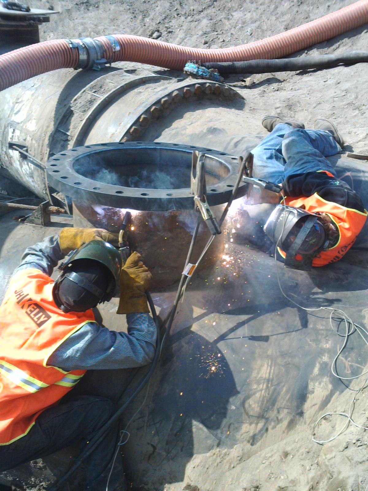

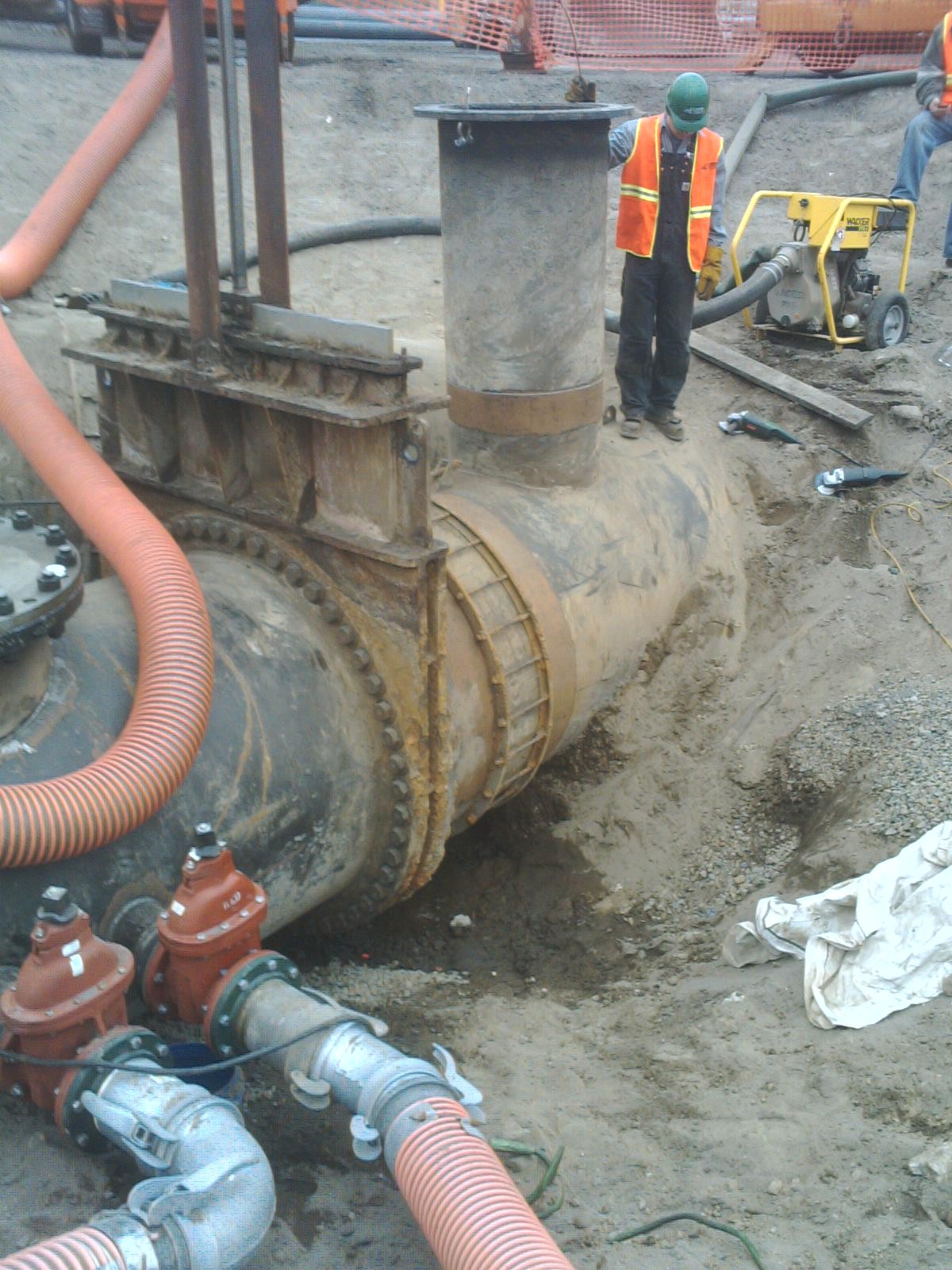

I brother-in-lawed this weld with a co-worker with dual-shield, (flux cored mig w/argon shielding gas) run off of a lincoln ranger 9. it was a shutdown situation so speed was key. about 3 times faster than stick. the huge knife gate was removed the following day, a large blind installed in it's place, and a dual-shield mig weld made on the large pipe with two welders in under 5 hrs.

Nice pictures. What schedule pipe and what was it transporting?:D
It should normally have been raining for a shut down type of job ???:D:D:D

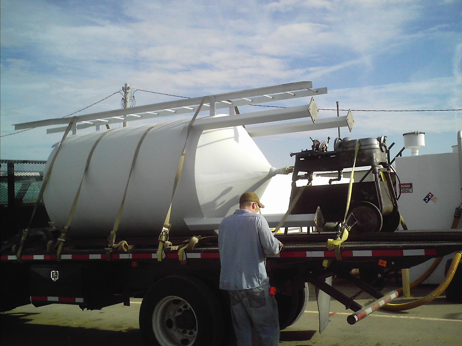

Sweet, We made some big stuff 1" ,1-1/2" plate using verticore... Hey Alan, Where's the 3 pt pins on your tank?:D
sch 40. it was an effluent line transporting wastewater from one clarifier to the other. the giant knife gate was leaking by terribly allowing secondary claification water to enter the river, before it could go into the third clarifier. also when the tide would come in, tide water would back up and leak by the valve the opposite way. we blinded it off so this could this could never happen. the line now has a lateral in it that diverts all secondary waste to the third clarifier.

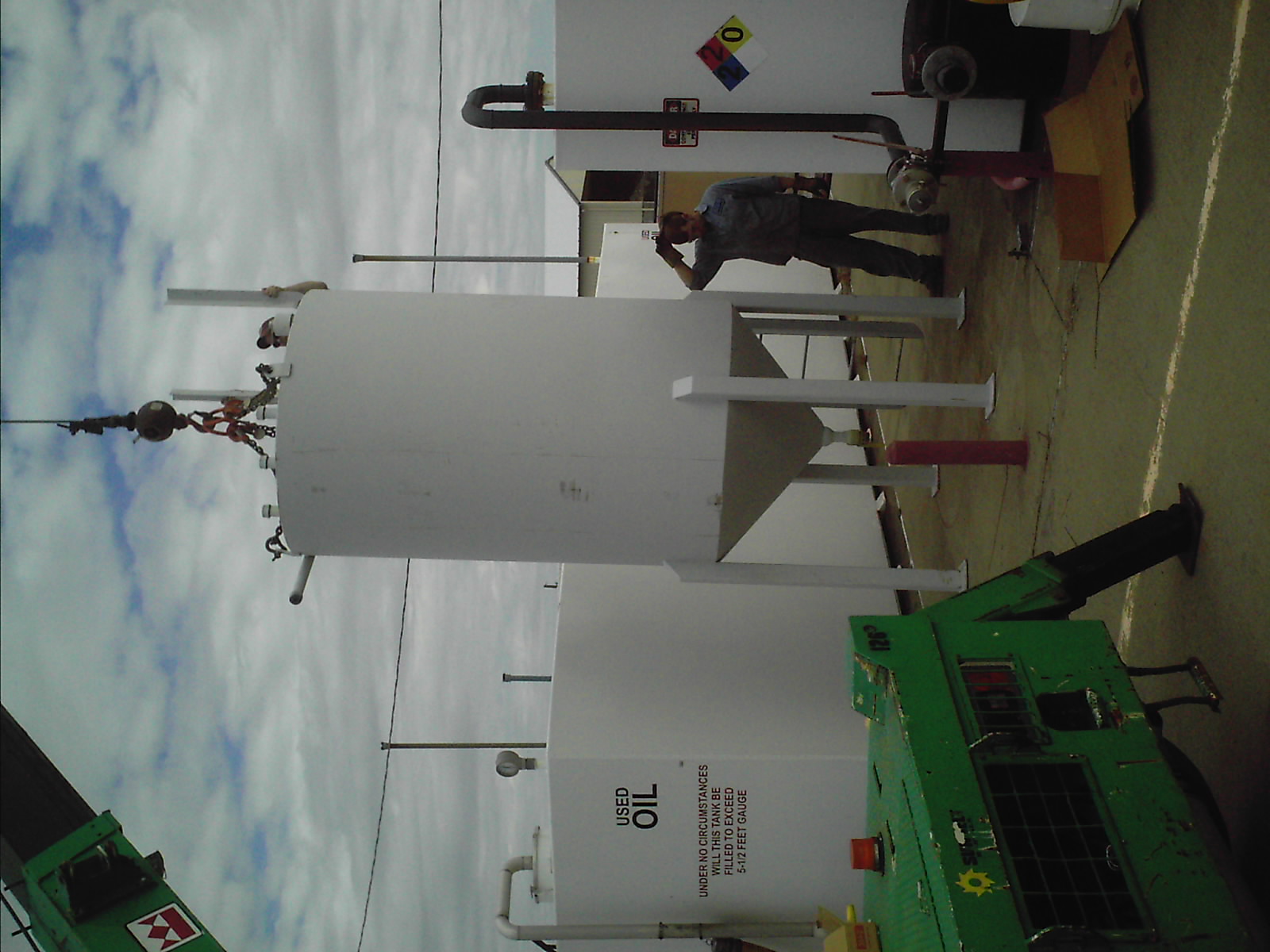

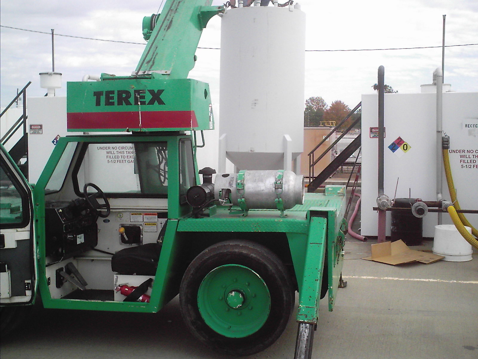

Well, following up a bit,
Yee haaa, after only about 10 years of waiting :eek:
The boyz came out and set my new coffee pot up :D
I was told I needed to go Decaf if I drank that :rolleyes:
Course one of my other guys walked by, said I should have added fins to the "top" and it would look like a rocket going into the ground right between my tanks :eek:
It is just too cool too see it come to fruition.
Finishing touches to do, and we will see if it works. :)
