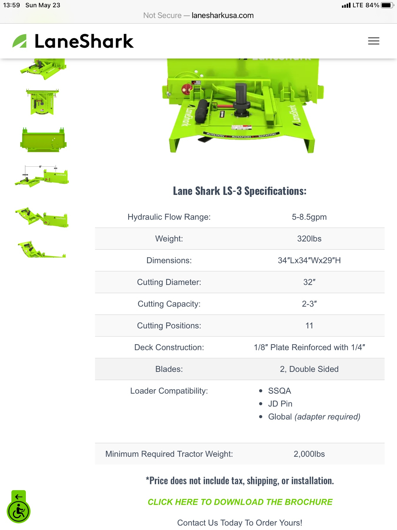

Has anyone used or had experience using the Lane shark bush hog? It has caught my attention and I’m thinking it would be a good match for the PT line up. See photo attached
It can be turned out and angled to mow ditches or the banks of the pond or creek. It can be turned up on its side to trim branches in a vertical cut.

I definitely see the weight of the 425 as a problem matched to lane shark.
/ Interesting attachment #12
I agree. The LS-2 specifies a minimum 2,000lbs, which is quite a bit more than the 1400lbs for the 425.
For @Tchamp's intended use, I would lean toward brush hogging the paths a bit wider and let the branches flop back in to get the alleyway that you want, but I recognize that that is having a hammer and thinking the problem is a nail...
I could see the advantages for trimming trail edges as hedges. Charlie Iliff used to do something similar with a sickle bar cutter he put on his PT (1845?) to cut trail sides for horseback riding. A sickle bar mower is much lighter, but granted it can't do thick branches.
I think that the Lane-Shark is an interesting design, mechanically, with a rotation point and a second hinge. I had been contemplating offsetting my trencher, and this looks like a stiffer way to generate the offset.

I have a 2425 with the backhoe attachment and i weigh just over 2100 lbs.
#15
They don’t recommend me utilizing the attachment.
I just wanted the brush hog because it will run on 5 gpm up to 8.5 gpm, and cut up to 3 inch diameter.
Did they say why they didn’t recommend it?
There are other companies that build basically the same thing, one could look at if so inclined
/ Interesting attachment #18
I'm gonna guess because of the weight, the possible torque put on the FEL arms if it's extended to the side, and maybe the hydraulic flow and cooling(but that seems within specs).

They said becuase of the narro w wheelbase and the articulation of the unit not from the steering but for the traversing would make it unstable. I just wanted the deck for brush hogging becuase it could the 3 inch in diameter
/ Interesting attachment #20
Well, it says it will do 3" diameter, but does it say of what? I know the 48" brush hog from PT that I have will do severe damage to brush and shrubs and small trees. 2" oak takes a little finesse to get it over then chopped up. I wouldn't attempt 3" diameter anything with it unless it was dead and rotting on the forest floor.
