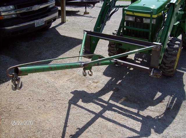

I prefer a boom for lifting:
I do have small hooks on my bucket, but seldom use them, much prefer to use the boom. I store my tractor/loader with the "quick-tach" bucket off, so I just put on whatever I need at the time, bucket, boom or forks. ~~ grnspot
I'm with you on this...my loader is rated at about 600#'s and I am more afraid of twisting/racking the boom arms than anything...most of the stuff I lift that won't fit inside the bucket I use the grapple on...I use my boom for loading/unloading attachment from a truck bed or trailer...if I had a bigger/heavier tractor/loader I would add some hooks...

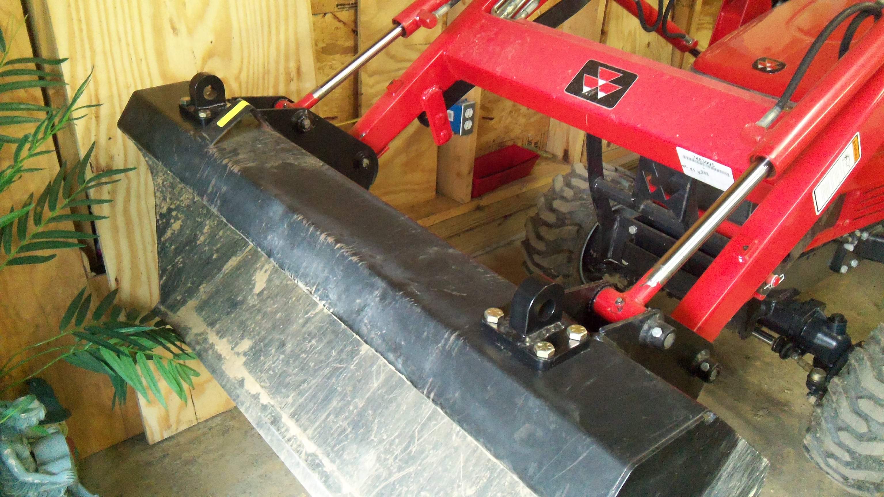

This setup has been working well for me so far. I have since painted it.

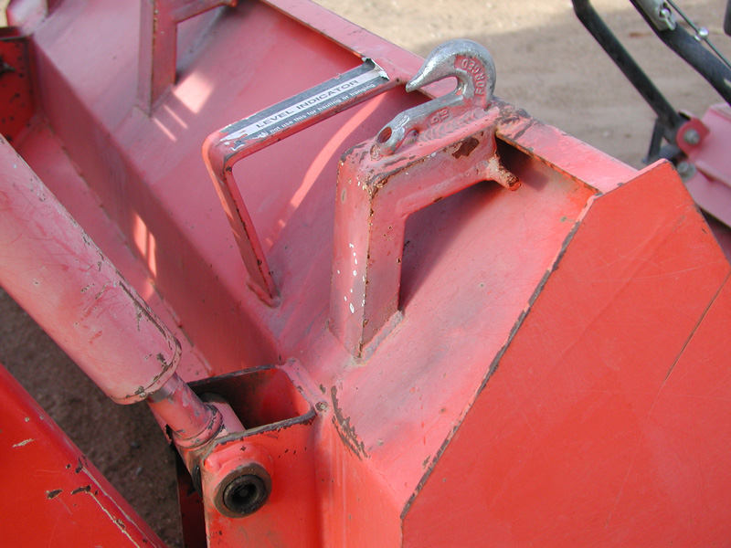

This is what I did to mine about 7 years ago. The triangulated channel section transfers much of the force back to the rear of the bucket taking it off the top edge.
