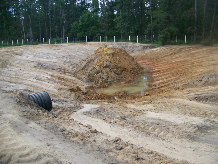

I'm paying $1950 for the week delivered. He has nice machines. I wish I could've gotten some of the rain. It's to dry over here and can't hardly see when on the dozer.

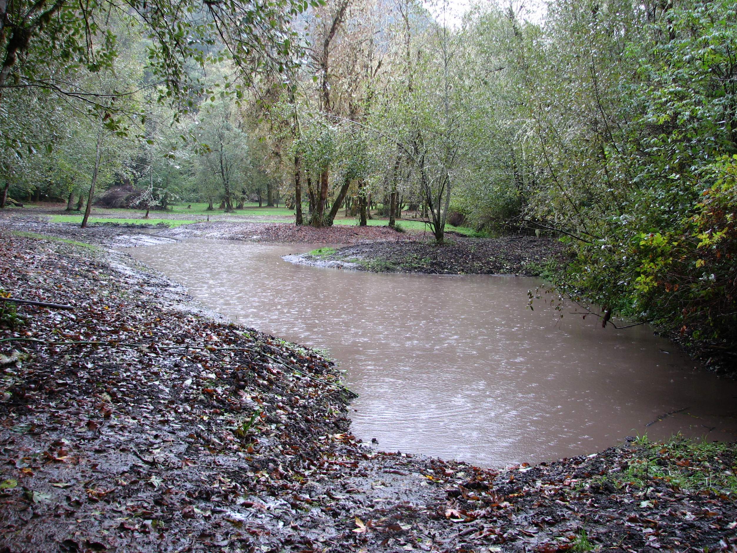

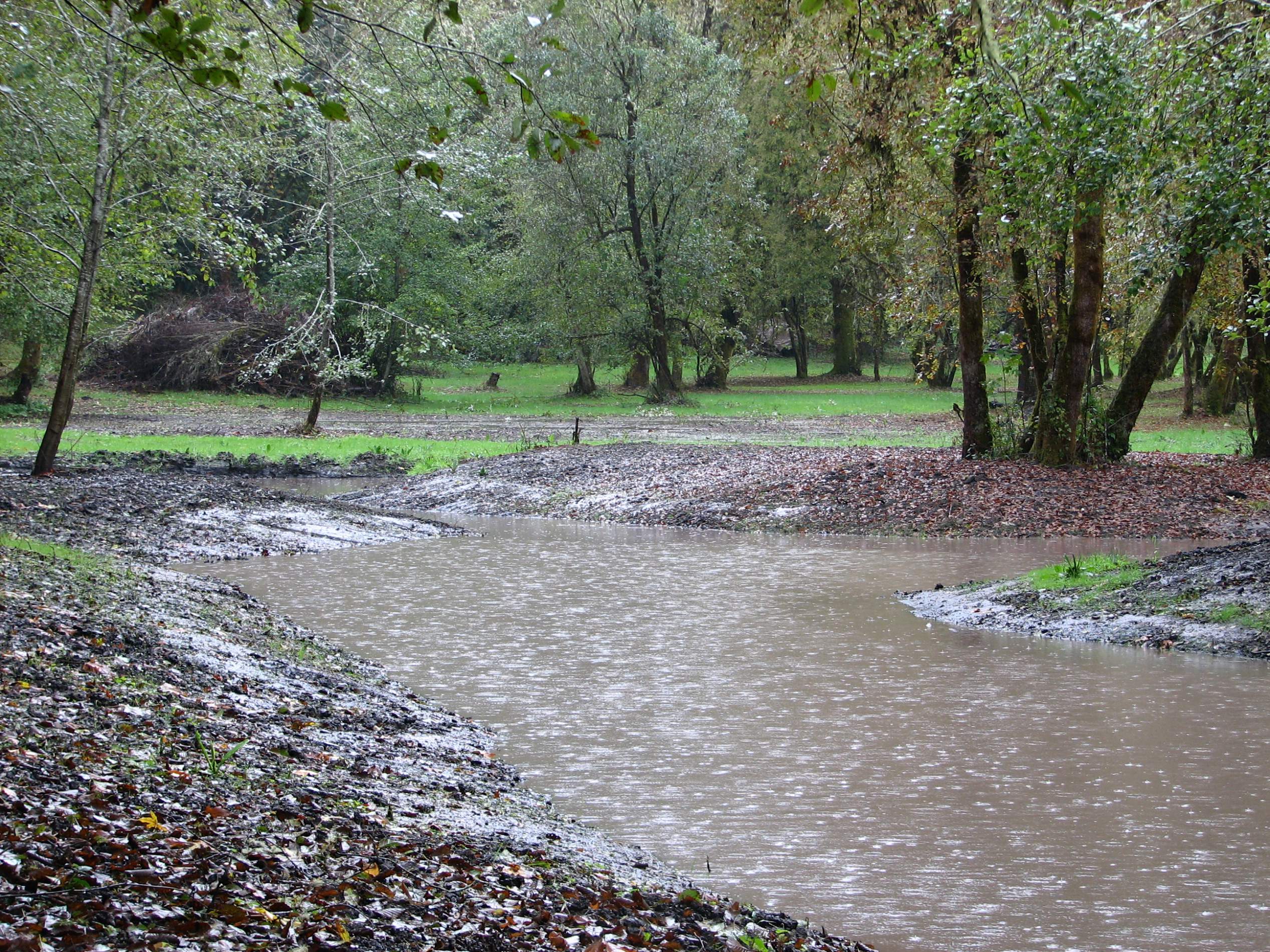

Here is what 6 inches of rain in 24 hours does.

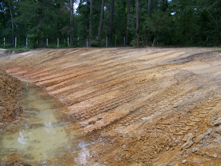

I got a few sprinkles out today on the Big RED Beast. But I kept going. I had put out more rye grass seed, then finished grading the dam's shoreline and knocking down the crown where I had not had a chance, with my grader blade on the BH bucket. Then I put out more rye grass seed and drug the drag harrow over it. I am glad I bought that drag harrow on credit at half price. It is worth it's weight in gold, as you can see by the finished product, below.
hugs, Brandi
11-9-13 Drag Harrowing Dam.jpg11-9-13 Dam Smooth from Overflow.jpg11-9-13 Dam Smooth and Seeded.jpg11-9-13 Dam Smooth @ Overflow Pipe.jpg11-9-13 Dam Curvature Smooth.jpg11-9-13 Dam Baby Smooth.jpg
/ Instant Pond #177
That drag sure makes your dirt look nice!!!!!
Have you used it in areas with brush, branches or just stuff growing? I'm curious if it holds stuff like in it?
Eddie
/ Instant Pond
#178
Eddie
Eddie,
Thanks Eddie. It really did a good job. I had the long teeth down and digging in, so it picked up a lot of debris. Turning (hanging half way up in the air) around on the high side of the pond caught a lot of pine limbs and needles.
It can be reversed for less of a "bite" or flipped over for just easy leveling. So there are 4 levels of bite adjustments on it. I first thought I would need to hang it from the BH with the boom hanging to the side on the bank to get down to the water. Which I didn't want to do on the slope. But it worked fine dragging from the corner hook on the loader bucket.
