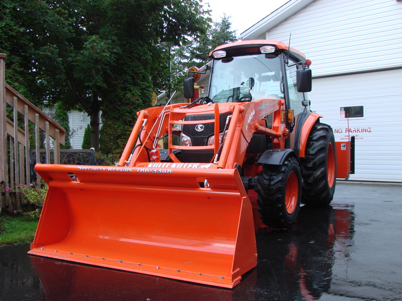

Hey Waxman. Your going to have to add front fenders to your rig next. A few of the Canadian "L" series Kubota's have them. I've added extention flaps to mine and they sure keep the front of the cab clean if you need to travel on a wet road :D
Your tractor looks pretty mean in that picture 4shorts,
I been wondering when are you going to paint that fender?:D. my rigs a toy compared to yours.
