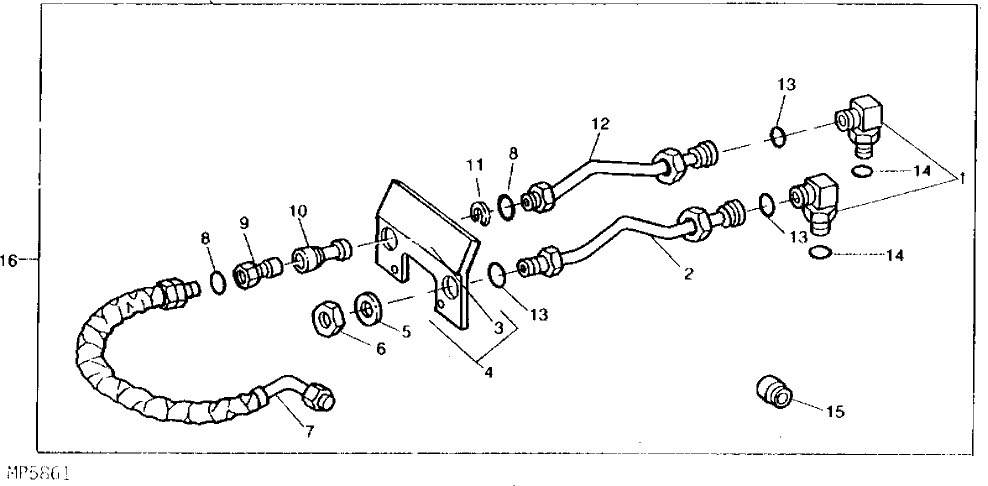

Has anyone installed a PB on a 955? It looks like it is quite a job.

JDParts has it listed as Auxiliary Hydraulic Kit PN:BM16763.
Here is a pic:
   / Installing Power Beyond on 955 #6
I have done 3 955s. It is totally different from the 4200/4300/4400. The
only part I bought was the hex plug (#15 in your dwg). I prefer hoses
to the hard lines. The hardest part of the install is the fact that you have
to remove so much stuff (fender, seat support, controls, etc.).
There are some postings on TBN about this.....do a search.
   / Installing Power Beyond on 955 #7
Here is a pic:
That's the same operational concept as my 4200's PB kit; but simpler. I like the hard lines as they take up less space compared to hoses. I doubt it will take you long to install the kit, especially if you don't have to remove a wheel and a fender.
