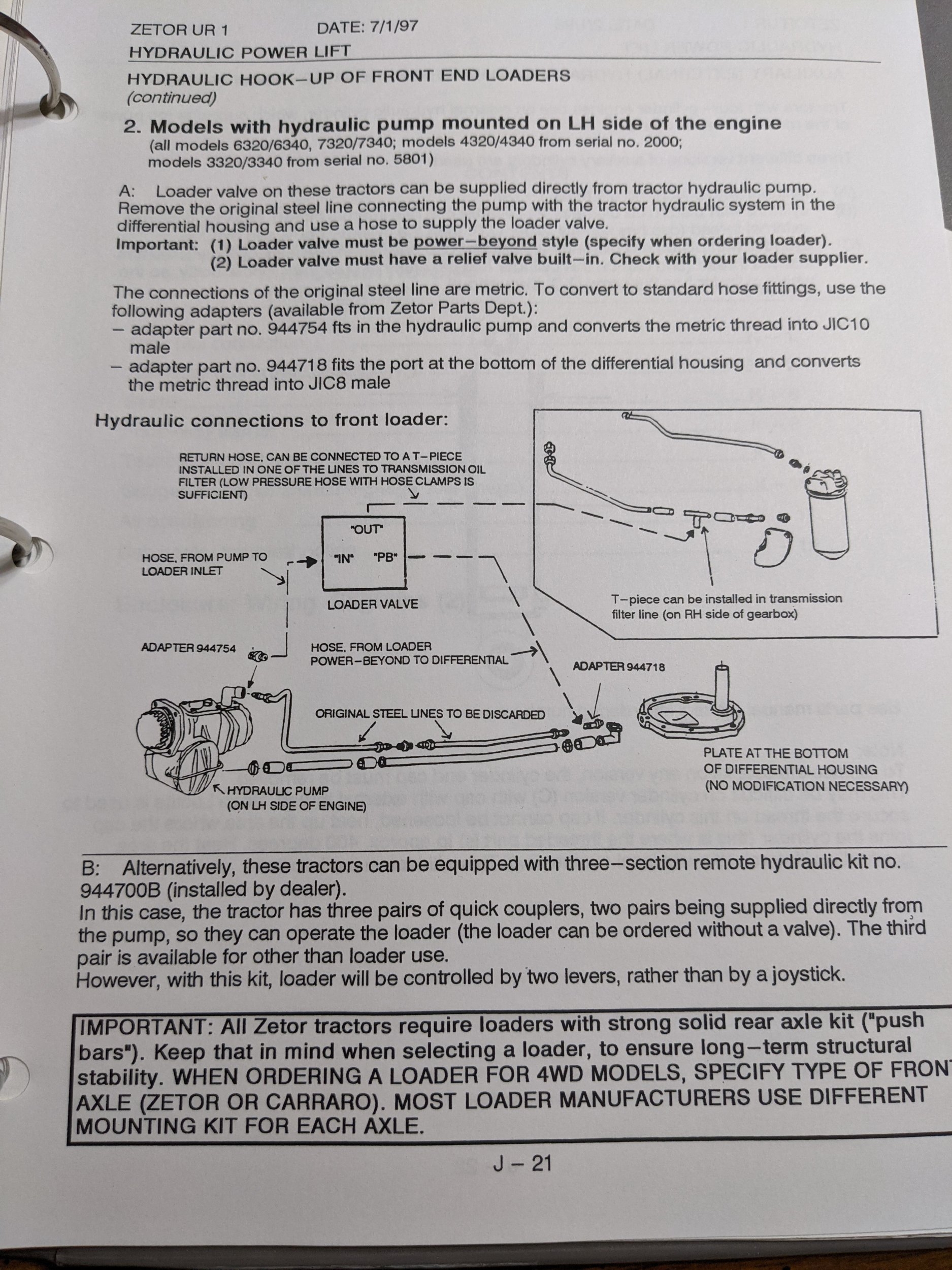

I'm ordering a Factory service manual from my parts supplier.. I guess Zetor is no longer printing them, so this will be a 1st generation photo copy.. Once I have it in hand I'll be able to comment on its completeness.
I got lucky on eBay a few years ago.
   / Installing a loader on a Zetor 7745 #22
Can anyone share a link to which manual this is so I can order one?
