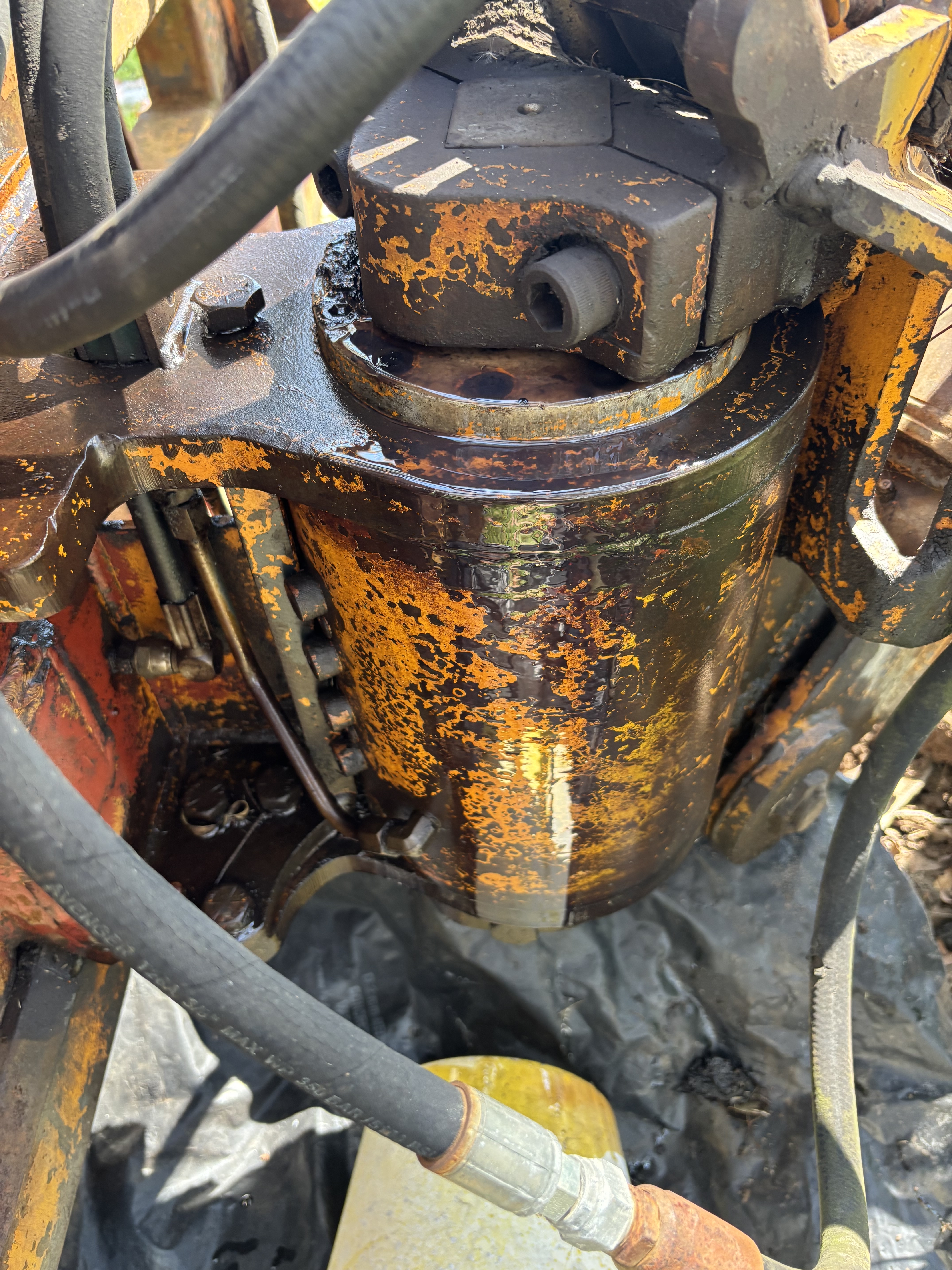

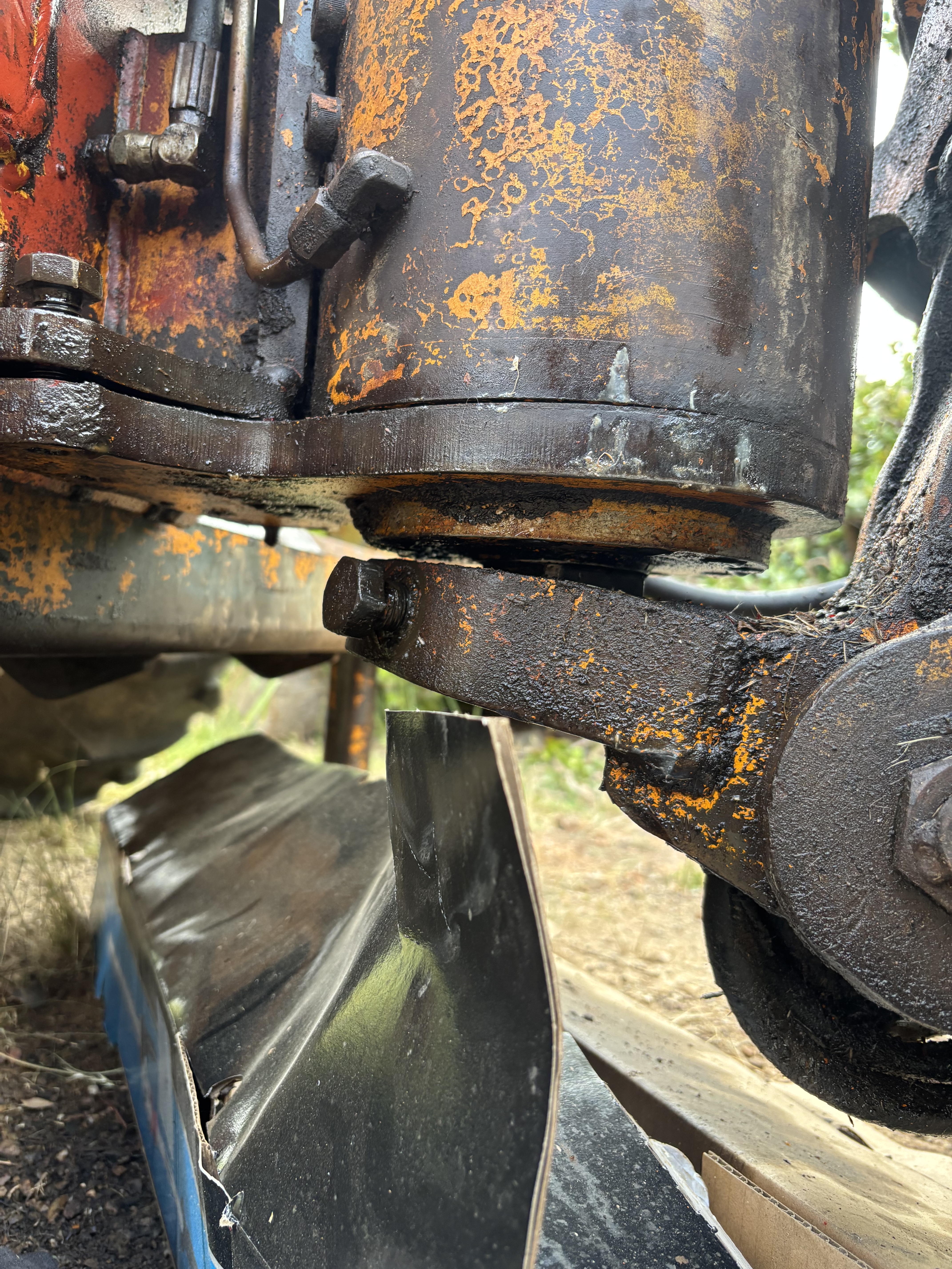

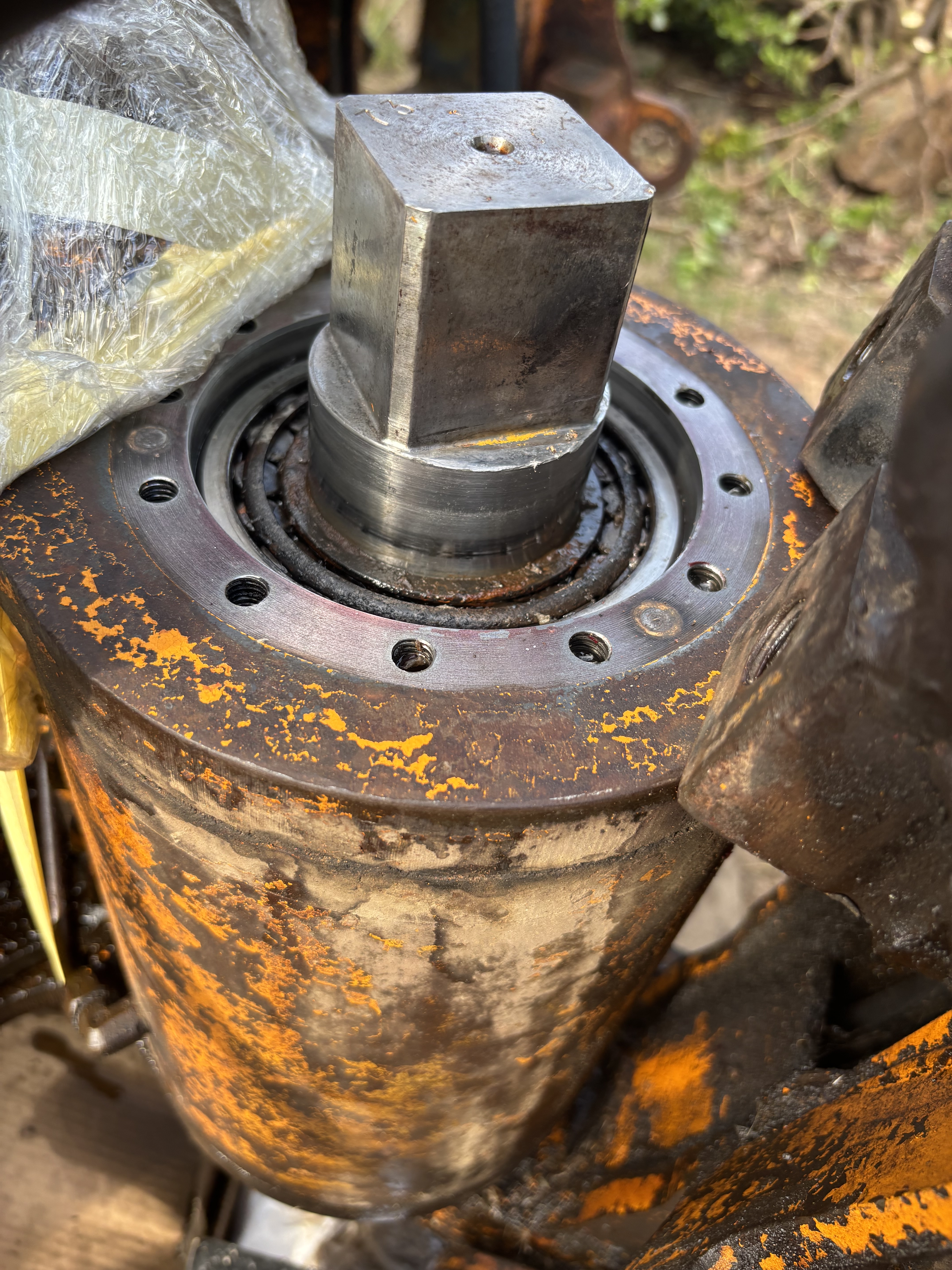

I have a 1982 Ford 1900 4WD (Shibaura made) with an INMAC "Compact combination" FEL and backhoe on it (model number RF120 L108), in Melbourne Australia.
I'm trying to figure out the make and model of the unmarked hydraulic swing motor for the backhoe. Ive re-sealed the top of the thing, but I'm sure it will need deeper work with wiper seals at some point soon and I'm reluctant to put it to real work until I can figure this out. I know that custom wiper seals can be guessed at and made but have been told by my trusted hydraulic shop that they are expensive and won't last long and he wouldn't do it.
Has anyone managed to figure out what brand/make swing/slew motors/cylinders they used on these things?
The valve blocks for the FEL and backhoe are USA made Gresen, and the front PTO mounted hydraulic pump for the standalone FEL and backhoe hydraulics is a Sperry Vickers also USA made (I think).
For some extra detail, the round shaft in the middle of the swing motor is 70mm and has a Nachi E30214J bearing on the top of it (as deep as I have gone), and the round shaft is machined for a 2" square shaft on the top and bottom for it to couple to the backhoe. 12 bolts on the top and bottom flanges with 3 jacking holes in each. Top of the square shaft has a 73 and a 9-or-6 stamped in it.
Im hitting a lot of dead ends trying to search and call around for this.
Ive looked at every YouTube I can on rebuilding these kind of swing motors, but none look like mine and most seem to be a similar style but different make/design thing common to Massey Ferguson backhoes.
Would appreciate any tips,
cheers
