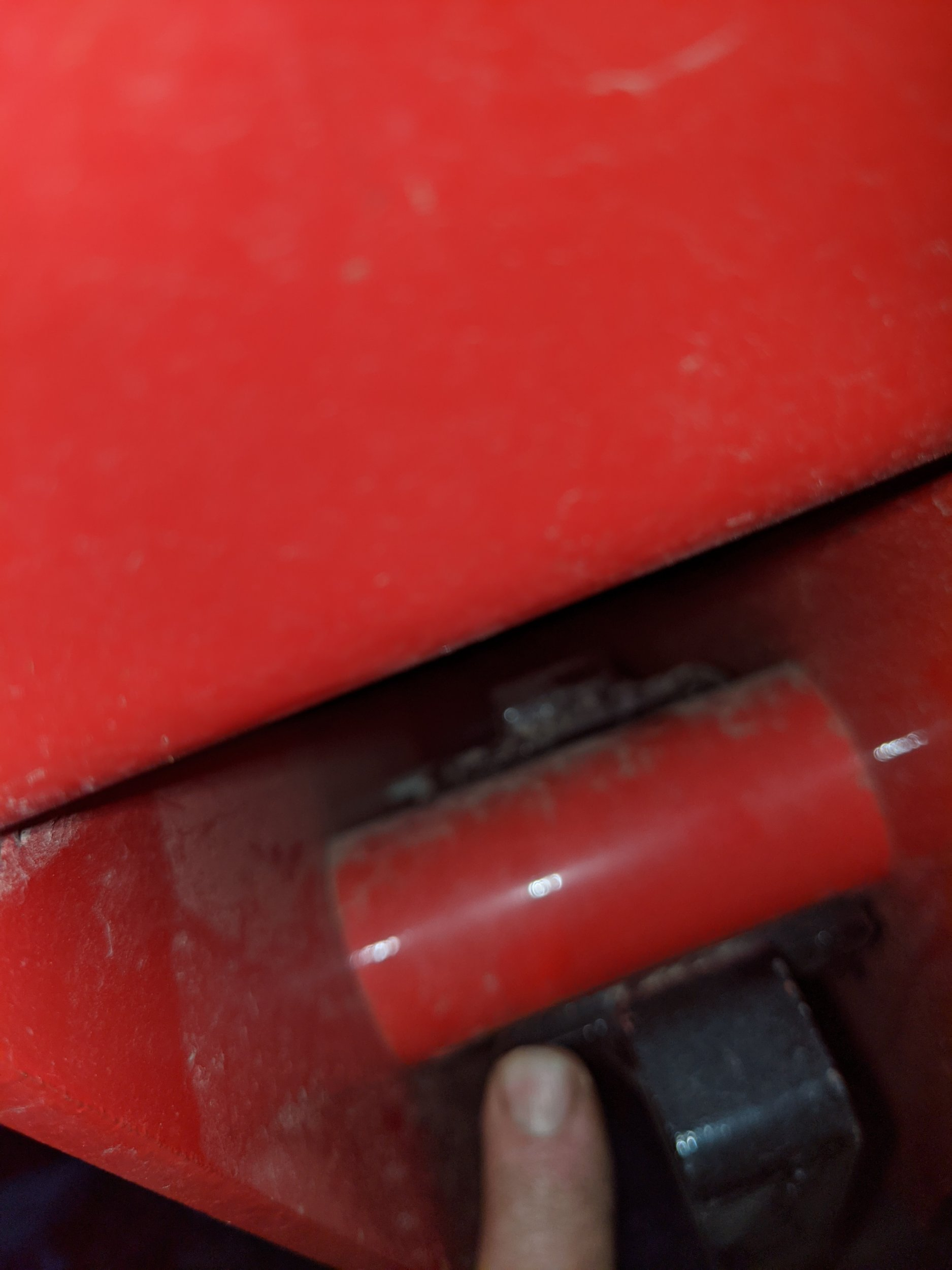

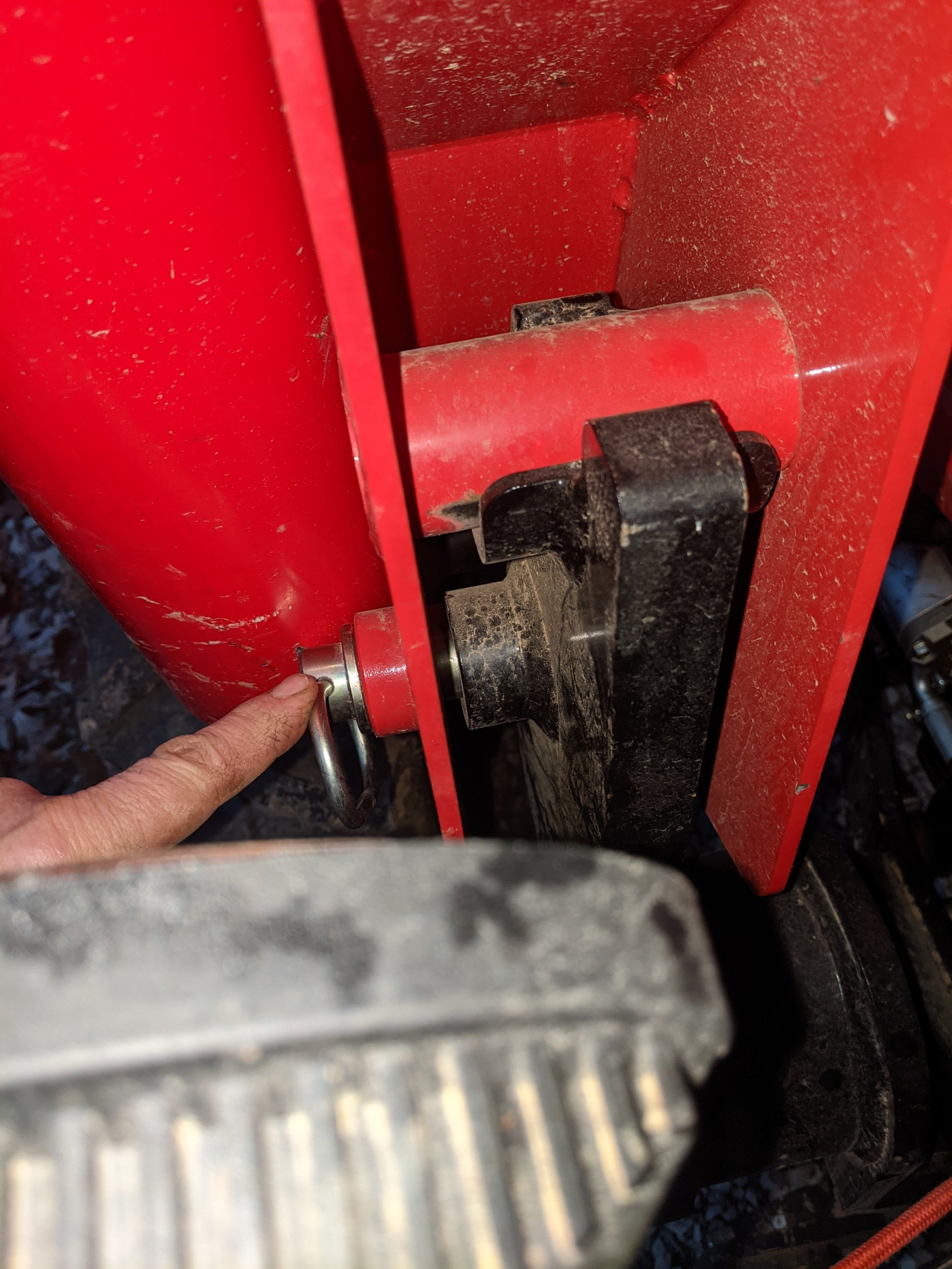

My concern is the amount of movement in the connection points for the FEL. I'll call this the cradle and pin. Putting pressure down on the bucket there is approximately 1/4 to 3/8 inch movement up and down. Anyone else seeing this?
I pulled the FEL off yesterday to do some measuring. The pin is 1 3/32" the hole in the FEL arm is 1 1/8", stands to reason. The hole in the sub frame (cradle) 1 3/16". I know this is only 3/32 and with the lateral movement in the cradle, movement is significantly noticeable.
Though about getting some shim material to tighten things up. That type movement, in a connection point, seems to me could cause wear and tear.

Johnny D, is this the area you are referring to with the movement? Is this on both sides of the FEL?
Is this a new RK55 and have you contacted the store where purchased?

I will attach photos of the specific area.
Yes, both sides.
Yes, I bought my tractor at the RK in Zanesville, Ohio March 2021. I have not contacted the folks, Vince, or Lenny, about this issue. I was going to see if this was a common thing
, before bugging them.
You can see were it moves laterally. Shim washers will stop that
I've put shims in other areas to reduce what I call lateral movement.

The movement is also up and down with putting downward pressure on the FEL.

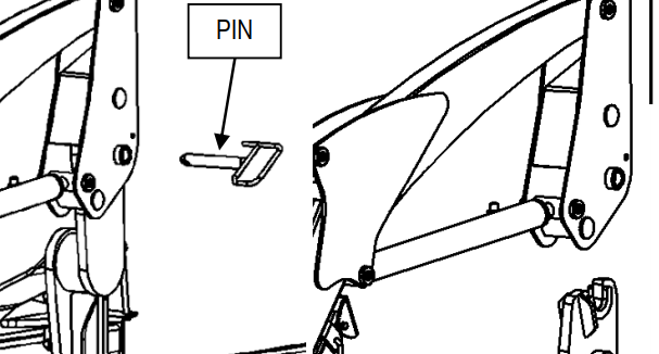

The only thing I have noticed about my FEL, was how tight the pins were to remove and re-insert. The framework that the FEL attaches to isnt as rigid as the attachment points were on my SOB tractor I had before this one. First time I tried to remove the FEL on mine for mowing, I had to use a hammer to get one of the pins out and the opposite side fell out?

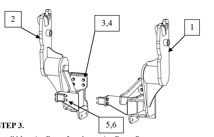

I thought you were talking recently about them looking at it. I have mentioned a couple times in the past about trying to align my FEL but like other things it keeps getting pushed aside. Looking at the loader manual it appears there's a left and right frame mount along with a cross brace between them. Those are mounted to the tractor with 4 bolts on each side prior to the FEL.
I'm thinking that if those 8 mounting bolts are loosened slightly with the FEL raised a little off the ground that maybe using a level on the front of the FEL things can be corrected by raising the low side with a bottle jack under the frame mount. Once level then everything can be torqued back to specs. There's a torque chart in the loader manual. Any thoughts?
